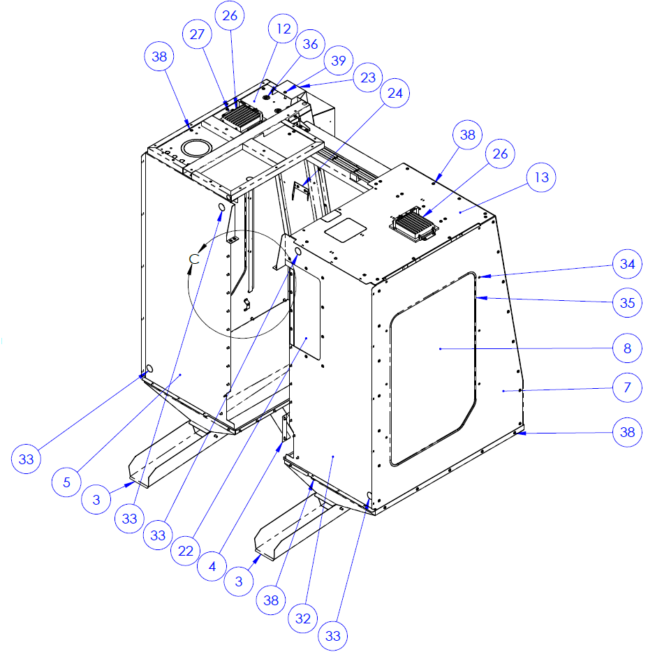

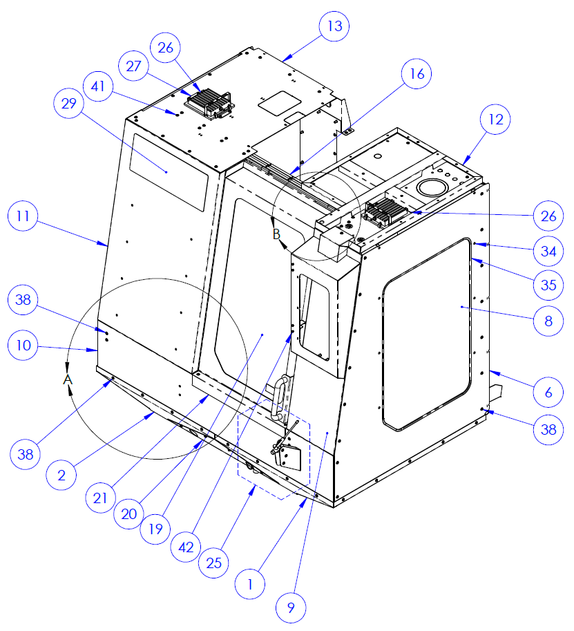

1500MX Knowledge Base
Enclosure - 1500MX
Alternative Part Number
Right Chip Tray, 1500MX (PN 51263)
Left Chip Tray, 1500MX (PN 51264)
Coolant Chute, 1500MX (PN 51280)
Chip Tray Support Bracket, 1500MX (PN 52439)

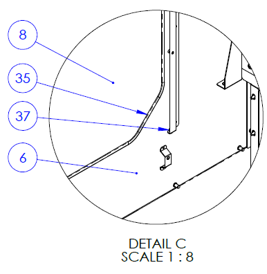

Right Rear Enclosure Panel, 1500MX (PN 51265)
Right Side Enclosure Panel, 1500MX (PN 51267)
Left Side Enclosure Panel, 1500MX (PN 51268)
Side Enclosure Panel Window Cover, 1500MX (PN 51527)
Right Front Enclosure Panel, 1500MX (PN 51269)
Center Front Enclosure Panel, 1500MX (PN 51343)
11
Left Front Enclosure Panel, 1500MX (PN 51270)
12

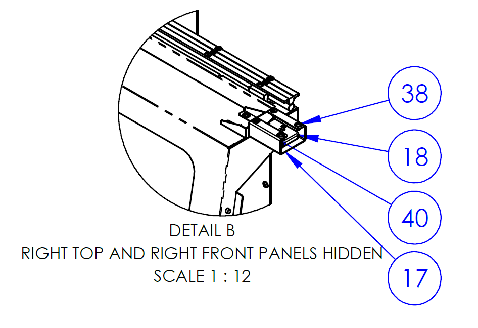

Right Top Enclosure Panel, 1500MX (PN 51271)
13
Left Top Enclosure Panel, 1500MX (PN 51272)

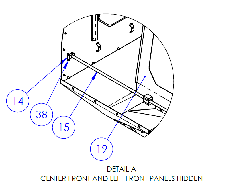

14
Linear Rail Support, Round, 16 mm (PN 37622)
15
Linear Rail, 16 mm Round, 1250 mm (PN 51364)
16
Linear Rail, Supported 16 mm Round, 1200 mm (PN 51816)
17
Locking Door Switch Bracket, 1500MX (PN 51369)
18
Locking Door Switch, 1500MX (PN 51328)
19
Enclosure Door Assembly, 1500MX (PN 51273)
20
Chip Tray Center Kick Plate, 1500MX (PN 51374)
21
Enclosure Scuff Guard, 1500MX (PN 51345)
22
ATC Mount Cover Panel, 1500MX (PN 52207)
23
Console Cable Cover, 1500MX (PN 51382)
24
Enclosure Mount Camera Bracket, 1500MX (PN 51417)
25
Air Gun Kit*
26
LED Flood Light (20 W) (PN 51591)
27
Flood Light and Window Retainer, 1500MX Enclosure (PN 51507)
28
Cable, IEC 320 Extension (IEC 320 C13 - IEC 320 C14), 2.0 m, 10 A 250 V 18/3 AWG SJT (PN 38389)
29
Decal, Enclosure, 1500MX, Front Left Panel (PN 51437)
30
Decal, Enclosure, 1500MX, Rear Right Panel (Interior) (PN 51438)
31
Label Kit, 1500MX Enclosure (PN 52443)
32
Left Rear Enclosure Panel, 1500MX (PN 51266)
33
Panel Plug, Push-In, 32 mm
McMaster-Carr: 9600K521
34
Panel Plug, Push-In, 6 mm
McMaster-Carr: 9600K512
16
35
Enclosure Side Panel Trim, 1500MX (PN 51375)
36
Expandable Locking Grommet, 7/8 in. × 1 1/4 in. × 1/32 in. - 1/8 in., Nylon
McMaster-Carr: 4946A704
37
Push-In Bumper, 0.25 in. Stem, 0.22 in. Height
McMaster-Carr: 9309K64
38
McMaster-Carr: 97654A380
175
39
Screw, Button Head Cap, Flanged M6 × 1 - 40, 18-8 Stainless
McMaster-Carr: 90909A432
40
Screw, Button Head Cap, Flanged M4 × 0.7 - 8, 18-8 Stainless
McMaster-Carr: 97654A372
41
Screw, Button Head Cap, Flanged M6 × 1 - 6, 18-8 Stainless
McMaster-Carr: 97654A682
12
42
Screw, Button Head Cap, M5 × 0.8 - 12, Stainless Steel
McMaster-Carr: 92095A210
43
Cable Tie, 4 in., Nylon, Black
McMaster-Carr: 7130K52
20
