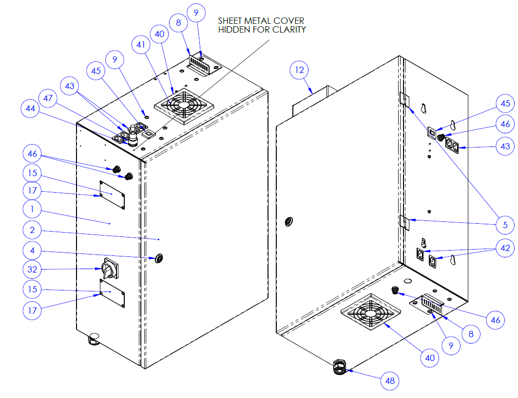

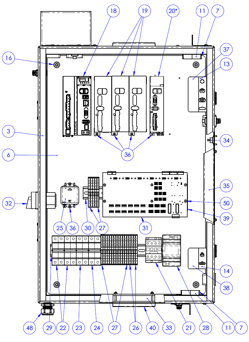

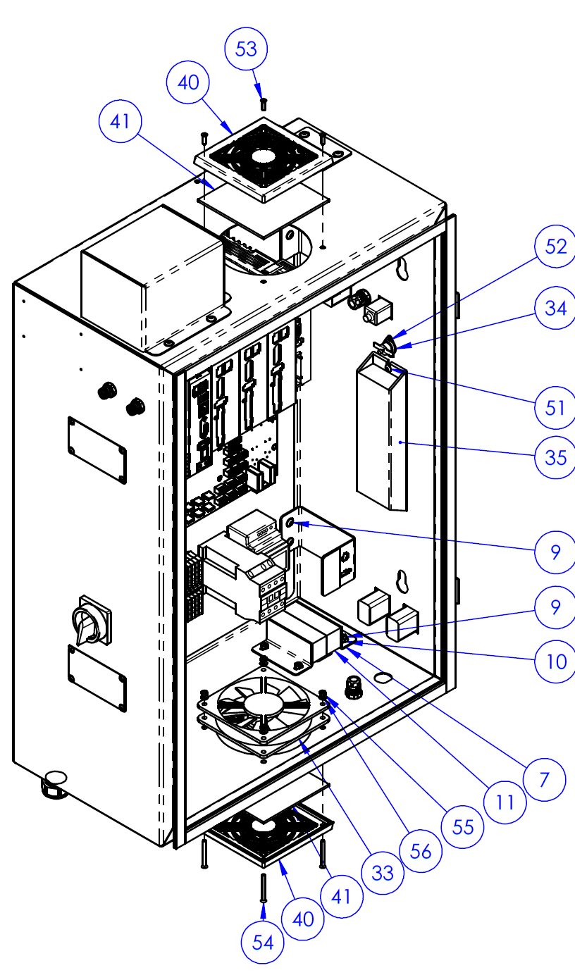

1500MX Knowledge Base
Electrical Cabinet - 1500MX
Alternative Part Number
Electrical Cabinet, 1500MX (PN 51284)
Electrical Cabinet Door, 1500MX (PN 51285)
Electrical Cabinet Door Gasket, 1500MX (PN 51669)
Cam Lock, Zinc Plated, Hex Drive, Quarter-Turn Counterclockwise to Open
McMaster-Carr: 2050N12
Hinge, Surface-Mount, Lift-Off Style, Right Side, 22 mm Hole Spacing (PN 53478)
Electrical Panel Back Plate, 1500MX (PN 51287)
Cable Gland Strain Relief Bracket (PN 51295)
Screw, Button Head Cap (Flanged), M5 × 0.8 - 12
McMaster-Carr: 97654A377
16
Nut, Hex, M5 × 0.8
McMaster-Carr: 90591A260
11
Foam Block, 30 mm x 80 mm (PN 51313)
12
Electrical Cabinet Doghouse, 1500MX (PN 51311)
13
Connector Bulkhead, Electrical Cabinet, Top Right Exit (PN 51297)
14
Connector Bulkhead, Electrical Cabinet, Bottom Right Exit
(PN 51298)
15
Electrical Cabinet Accessory Cover Plate (PN 37926)
16
Screw, Button Head Cap, Flanged M8 × 1.25 - 10, 18-8 Stainless
McMaster-Carr: 97654A683
17
Screw, Button Head Cap, Flanged M4 × 0.7 - 8, 18-8 Stainless
McMaster-Carr: 97654A372
18
Inovance SV660N, AC Servo Drive, Ethercat, 220 Vac, 12 A, STO Function (PN 51195)
19
Inovance SV660N, AC Servo Drive, Ethercat, 220 Vac, 5.5 A, STO Function (PN 51259)
20
Inovance SV660N, AC Servo Drive, Ethercat, 220 Vac, 2.8 A, STO Function, (PN 51194)1
0
21
Contactor (24 Vdc Coil, 1 Auxiliary Pole) (PN 37343)
22
Circuit Breaker (20 A, 2 Pole) (PN 37345)
23
Circuit Breaker (10 A, 2 Pole) (PN 37346)
24
Circuit Breaker (3 A, 2 Pole) (PN 37516)
25
Filter (110 Vac/250 Vac, 20 A) (PN 37914)
26
Terminal Block, GND, 4 Position, Spring Type, Internally Jumpered, JUT3-4/2-2PE (PN 51289)
27
Terminal Block, 4 Position, Spring Type, Internally Jumpered, 1500MX, JUT3-4/2-2 (PN 51290)
18
28
Power Supply (24 Vdc, 60 W) (PN 50461)
29
Din Rail (35 × 7.5), 375 mm Long
McMaster-Carr: 8961K15
30
Din Rail (35 × 7.5), 300 mm Long
31
Servo IO Breakout Board (6 Axis) (PN 51252)
32
Main Disconnect Switch (PN 30454)
33
Fan (24 Vdc, 120 mm)
McMaster-Carr: 8774N18
34
Thermal Switch (Pushbutton Reset) (PN 37420)
35
Spindle Brake Resistor (PN 37906)
36
Screw, Button Head Cap, M4 × 0.7 - 8, Black Oxide Steel
McMaster-Carr: 91239A140
15
37
Bulkhead Label, Upper Bulkhead, 1500MX Electrical Cabinet*
38
39
Standoff, 47 mm Hole Spacing, Clip-On Din Rail, Plastic (PN 51473)
40
Electrical Cabinet Exhaust Cover Retainer (PN 37947)
41
Electrical Cabinet Exhaust Filter (PN 37948)
42
IEC 320 Socket (Female, Single) (PN 37350)
43
IEC 320 Socket (Female, Double) (PN 37351)
44
Connector, 5 Pin, Female (PN 37353)
45
Connector, RJ45 Socket (PN 37355)
46
Circular Connector, M12, Rear Panel Mount, Plug, 4 Pin Female (PN 51293)
47
Circular Connector, Plug, 5 Pin Male, Metal Hose, Solder
(PN 39263)
48
Cable Cord Grip M20 × 1.25 / 25 mm Nut (PN 38758)
49
Screw, Button Head Cap, M5 × 0.8 - 8
McMaster-Carr: 92095A207
50
Screw, Pan Head, Thread Forming M4 × 1.79 - 10, Zinc Plated
McMaster-Carr: 90380A376
51
Screw, Button Head Cap, M5 × 0.8 - 10
McMaster-Carr: 91239A224
52
Screw, Button Head Cap, M3 × 0.5 - 8, Black Oxide Steel
McMaster-Carr: 91239A113
53
Screw, Phillips Head Countersunk, M4 × 0.7 - 14, Zinc Plated
McMaster-Carr: 91420A224
54
Screw, Phillips Head Countersunk, M4 × 0.7 - 40, Zinc Plated
McMaster-Carr: 91420A250
55
Nut, Hex, M4, Zinc Plated
McMaster-Carr: 90591A255
56
Washer, Flat, M4
McMaster-Carr: 91166A230
1Optional accessory not included with the base machine
