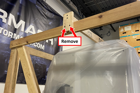

  3. Disassemble the shipping crate, starting with the top and then the four sides. With an assistant, remove the bottom two screws on either side of the crate's top beam, and then remove it from the shipping crate.
Figure 1: Two screws on the top beam.

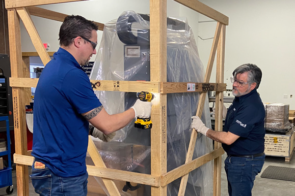

  1. Remove the screws on each of the four sides of the shipping crate, starting at the bottom. With an assistant, lift the sides of the shipping crate off of the pallet.
Figure 2: Removing the sides of the machine crate.

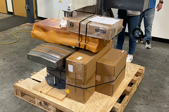

  2. Remove and discard the shipping straps securing the accessory boxes (the machine owner's kit, a coolant filter, and, if not yet installed, the operator console kit).
Figure 3: Accessory boxes on the machine and the pallet.
  1. Set aside the coolant filter box and the operator console box for later use, and open the machine owner's kit box.

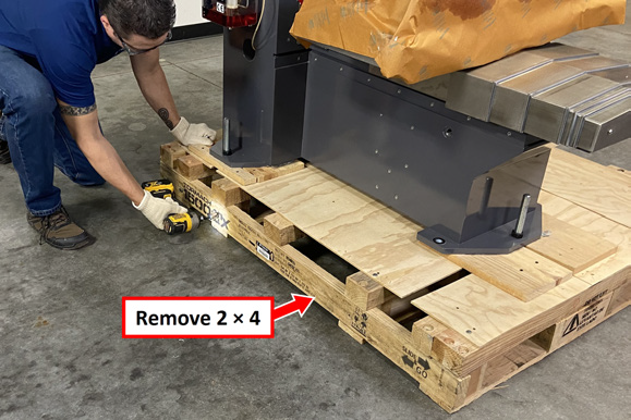

  3. Remove the screws on the 2 × 4 on the left side of the pallet with an impact driver. Remove and discard the board.
Figure 4: Removing the 2 × 4 from the left side of the pallet.

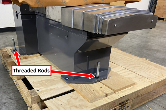

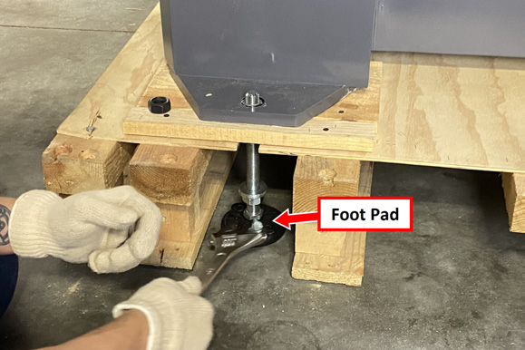

  1. Identify the three threaded rods that attach the machine to the pallet. To prevent galling or seizing, we recommend using a high-quality anti-seize compound on the threads of the machine legs.
Figure 5: Two of the three threaded rods.
  1. Starting with one of the threaded rods, loosen the nuts from the top and bottom with an adjustable wrench.
  2. Put the machine's foot pad (from the machine owner's kit) under the threaded rod, and tighten the threaded rod into the foot pad.
Figure 6: Installing the machine's foot pad onto the threaded rod.

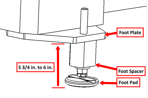

  2. Continue lowering the machine until there's a 5 3/4 in. to 6 in. gap between the floor and the bottom of the machine's foot plates. Level all three foot plates to the same height.
  3. Install a foot spacer below each of the machine's foot plates. Make sure that the large, flat side of the foot spacer is flush with the edge of the foot plate. Then, tighten the flat washer and nut against the bottom of the foot spacer.
Figure 7: Foot spacer installation.
