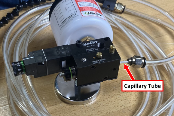

  2. Pull the outer 3/8 in. tube and push-to-connect fitting away from the pump block, exposing the 1/8 in. nylon capillary tube.
Figure 1: Push-to-connect fitting removed from the pump.

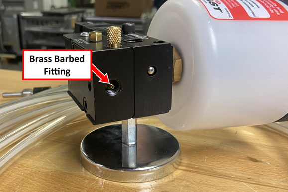

  1. Grasp the 1/8 in. capillary tube with a pair of needle-nose pliers. Lever the pliers against the pump block to pull the capillary from the brass barbed fitting in the pump.
NOTICE! Don't use a razor blade to cut the capillary along its axis to remove it from the barb fitting. Doing so can damage the barbed fitting and result in system performance issues. Also, don't grab onto the barbed fitting itself with the pliers — make sure you're pulling on the tubing.
  1. In the pump, verify that there's no remnants of the 1/8 in. capillary tube on the brass barbed fitting.
Figure 2: Brass barbed fitting in the pump.

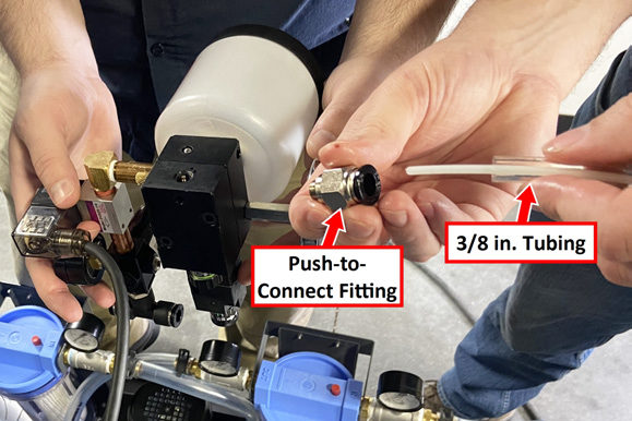

  1. Remove the push-in fitting from the 3/8 in. tube, and set it aside.

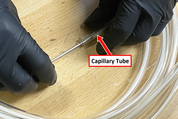

  2. To reconnect the tubing to the pump (done later in this procedure), you'll need about 1 in. of the 1/8 in. capillary tube exposed from the 3/8 in. tube. If you need to expose the capillary tube, complete the following steps. Otherwise, go to the next section.
    1. Carefully insert a hex wrench into the 3/8 in. tube, and lightly push back the 1/8 in. capillary tube.
Figure 3: Push back the 1/8 in. capillary tube with a hex wrench, or similar tool.

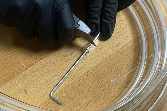

b. While holding the capillary tube back with the wrench, cut the 3/8 in. tube with a razor blade.
Figure 4: Cut the 3/8 in. tube away from the 1/8 in. capillary tube.
NOTICE! Don't cut the 3/8 in. tube where the blade could also cut the 1/8 in. capillary tube. If the capillary tube is accidentally cut, it could result in system performance issues.

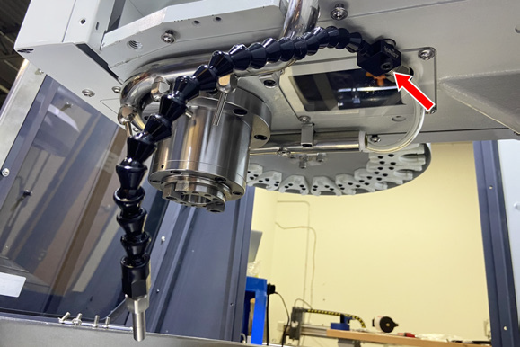

  1. Mount the nozzle behind the spindle head with the included hardware and a 3/16 in. hex wrench.

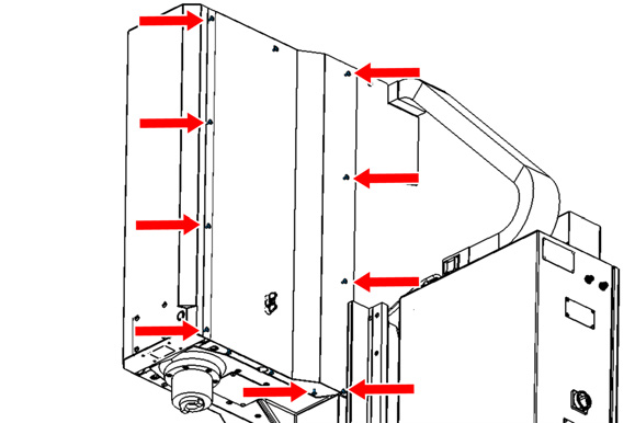

  1. Remove the nine M6 flanged button head cap screws on the side of the right side spindle cover with a 4 mm hex wrench. Set the screws aside. Then, loosen or remove the three screws on the bottom of the spindle head cover. Remove the cover, and set it aside.

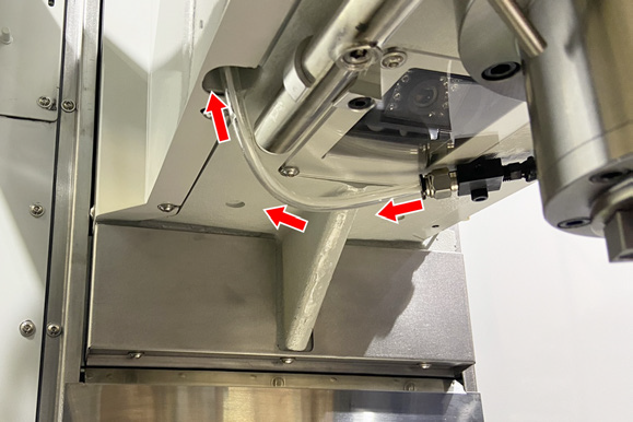

  1. Route the tubing from the nozzle up through the hole on the bottom left of the spindle head casting. Continue up to the top of the spindle housing, and out through the top left hole.

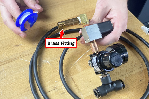

  1. Identify the solenoid and pressure regulator assembly included with this kit. Wrap thread seal tape around the threads of the brass fitting on the solenoid.
Figure 8: Brass fitting on which to use Teflon tape.

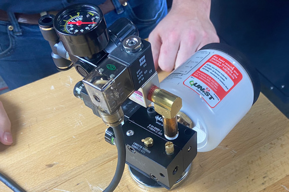

  1. Thread the brass fitting on the solenoid onto the pump.
Figure 9: Solenoid mounted onto the coolant pump.

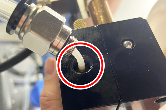

  1. Carefully install the 1/8 in. capillary tube onto the barbed fitting on the pump with a pair of pliers.
Figure 11: Capillary tube installed onto the barbed fitting.
NOTE: Make sure that the tube is fully installed onto the barbed fitting. If it isn't, it may result in system performance issues.
  1. Screw the push-to-connect fitting back into the pump block.

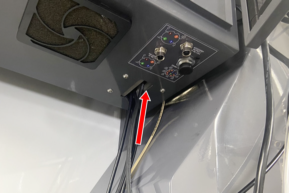

  1. Route the solenoid wire into the bottom of the electrical cabinet.
Figure 13: Solenoid wire routing into the bottom of the electrical cabinet.

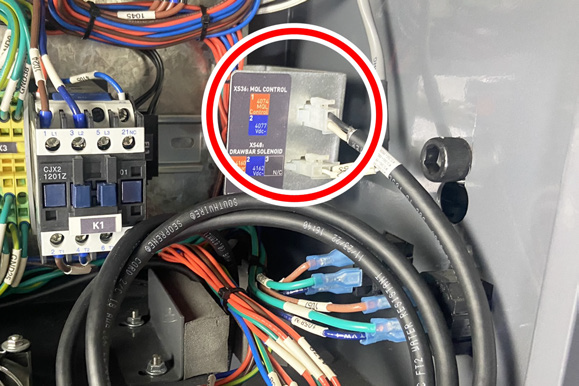

  1. In the bottom left corner of the electrical cabinet, plug the solenoid wire into the XS36: MQL Control connector. Pull the extra wire into the electrical cabinet, coil it up, and secure it with a cable tie.

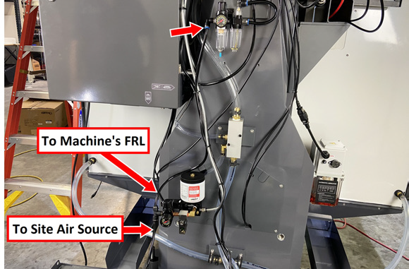

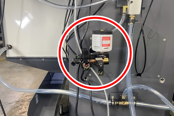

  1. On the back of the machine, identify the air line that's connected to the machine's FRL (with the fitting installed on the end). Disconnect it from the FRL, and connect it to the inlet valve of the MQL's solenoid.
  2. Identify the air line included with this kit, and connect it to the outlet valve of the MQL's solenoid. Connect the loose end of the air line to the FRL.
Figure 15: MQL's air line connections.
