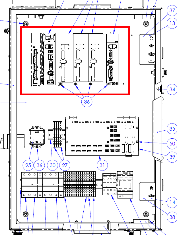

Examine the Servo Drives
Reason: The servo drive has an error present.
  1. Examine the Servo Drives in the electrical cabinet for an error code.
  2. Power cycle the machine to see if the error reappears.
  3. If so, contact Technical Support.

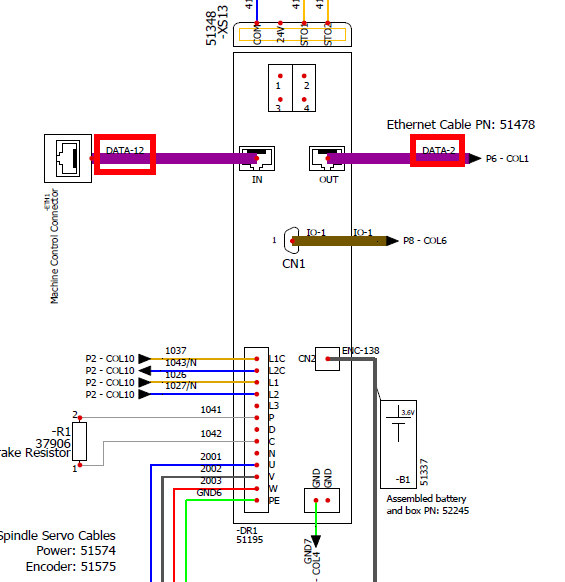

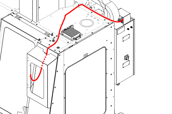

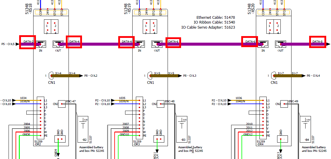

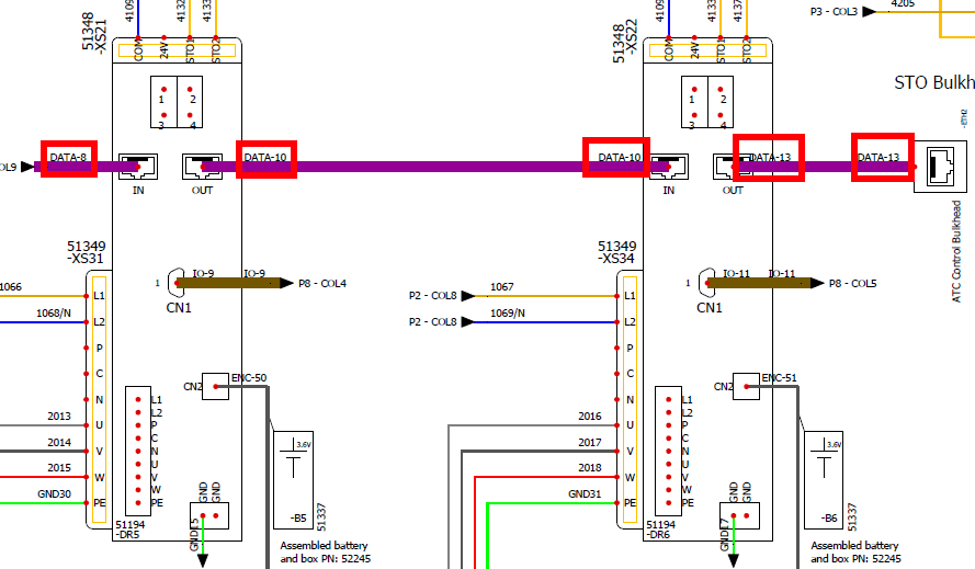

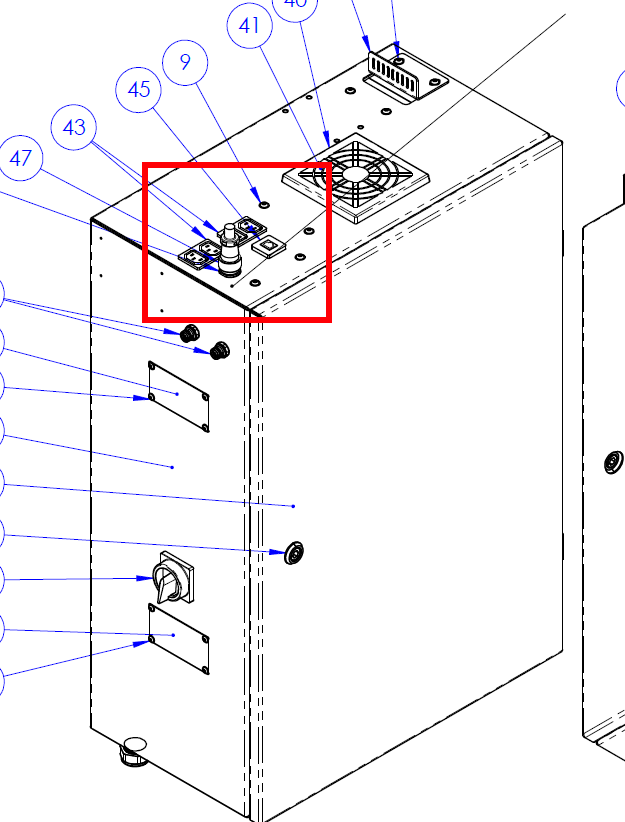

  1. Power off the machine (See Verify the Installation | Power off the Machine).
  2. Examine the EtherCAT connectors at each servo drive. All servo drives must be connected for the machine to function. Verify that the connectors are firmly seated, and examine the connectors for loose or damaged pins.
  3. Examine the DATA-12, DATA-2, DATA-4, DATA-6, and optional DATA-8 and DATA-10 cables connecting the servo drives. Also examine the Ethernet cable connecting the ETH1 Machine Control Connector to the PathPilot controller.
