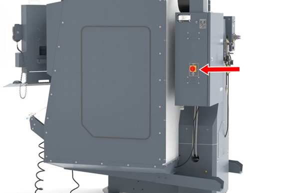

  2. Find the Main Disconnect switch, and then remove the hang tag.
Figure 1: The Main Disconnect switch on the side of the machine's electrical cabinet.

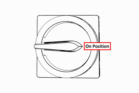

  1. Turn the Main Disconnect switch to ON.
Figure 2: Example of the Main Disconnect switch in the On position.
Mains power is now connected to the machine.

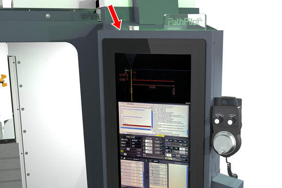

  1. Push the Power button on the PathPilot operator console, if it's not already powered on.
Figure 3: Power button on the top of the operator console (to the left of the key).

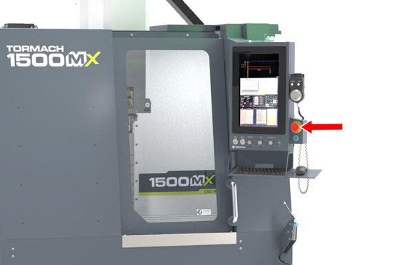

  1. Rotate the Emergency Stop button one-quarter turn clockwise to release it.
Figure 4: Emergency Stop button.

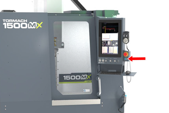

  1. Push the blue Reset button to enable the machine.
Figure 5: Reset button.
The axis drives are now powered on.

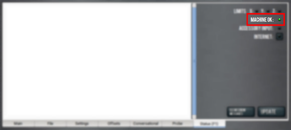

  1. Verify that the blue Reset LED comes on. From the PathPilot interface, on the Status tab, verify that the Machine OK light changes from yellow to green.
Figure 6: Machine OK light on the Status tab.

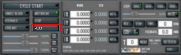

  1. Select Reset.
Figure 7: Reset button.
This initializes the connection between the machine and controller.

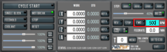

Verify Spindle Function
You must confirm that the spindle correctly operates.
  1. Close and latch the spindle door.
  2. From the PathPilot interface, in the RPM DRO field, type 500. Then select the Enter key.
NOTE: If you have an operator console, confirm that the RPM knob isn't set to 0%. If it is, turn the RPM knob.
  1. Select FWD.
Figure 8: Spindle controls.
The spindle rotates clockwise (viewed from above) at 500 rpm.
  1. Select STOP.
    The spindle stops rotating.
  2. Select REV.
    The spindle rotates counterclockwise (viewed from above) at 500 rpm.
  3. Select STOP.
  4. In the RPM DRO field, type 1000. Then select the Enter key.
  5. Select FWD.
    The spindle rotates clockwise (viewed from above) at 1000 rpm.
  6. Repeat the procedure at 1000 rpm.

  1. Push the Emergency Stop button to lock it into the disabled position.
Figure 9: Emergency Stop button.
With the Emergency Stop button in the disabled position all motion and spindle function stops, the Reset button is disabled , and the blue Reset LED goes off. From the PathPilot interface, on the Status tab, the Machine OK light illuminates yellow.

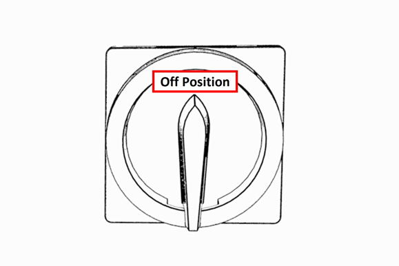

  1. From the PathPilot interface, select Exit.
  2. When prompted, select OK.
  3. Once the PathPilot interface indicates that it's safe to power off the machine, turn the Main Disconnect switch to OFF.
Figure 10: Example of the Main Disconnect switch in the Off position.
