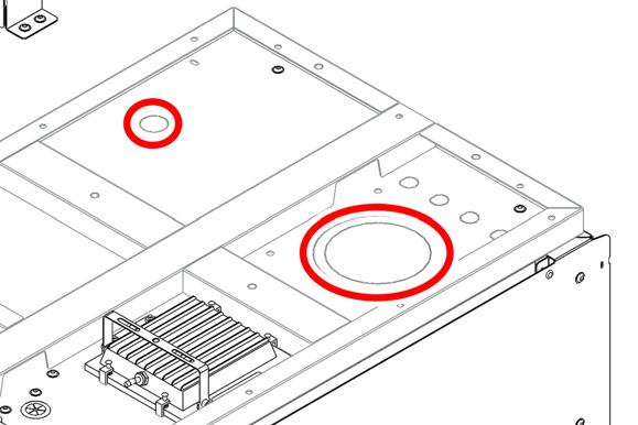

  1. To prepare the enclosure for the mist collector installation, remove the 150 mm and 34 mm knockouts from the enclosure's top right panel using a punch to break the tabs. Discard the knockouts.

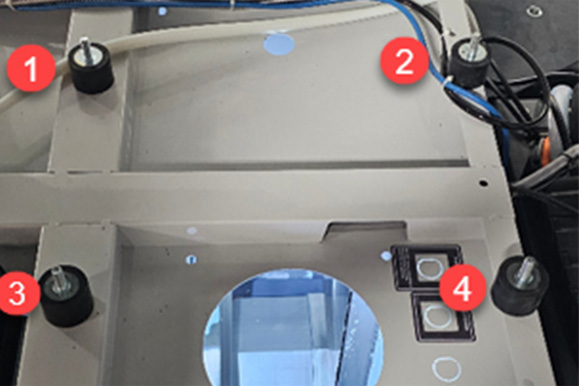

  1. Identify the eight provided vibration isolation mounts: four are flat (for floor installation), and four have threaded rods on both ends (for enclosure installation). Remove and discard the nuts from the bottom threaded rod of the mounts.
  2. Install the four vibration isolation mounts onto the enclosure’s top right panel. Remove and set aside the nuts and washers from the top threaded rod of the mounts.

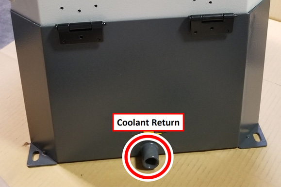

  5. Attach the threaded-to-barbed adapter elbow to the mist collector’s coolant return. Tighten using an adjustable wrench until the fitting is snug and the barbed section is pointing downwards.

  1. Using a gantry crane, forklift, or other suitable lifting device, place the mist collector on the enclosure's top right panel. Align the slots in the mist collector’s foot flanges with the previously installed vibration isolation mounts.
  2. Secure the mist collector to the vibration isolation mounts using the M8 washers and nuts that you previously removed and set aside.

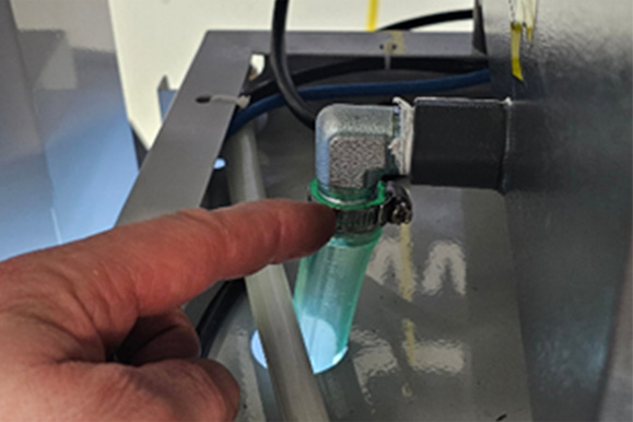

  4. Secure the coolant drain hose to the mist collector’s drain using the provided hose clamp. Trim the excess coolant drain tubing inside the enclosure. The coolant drain tube should extend 1 in. (25 mm) into the enclosure.
