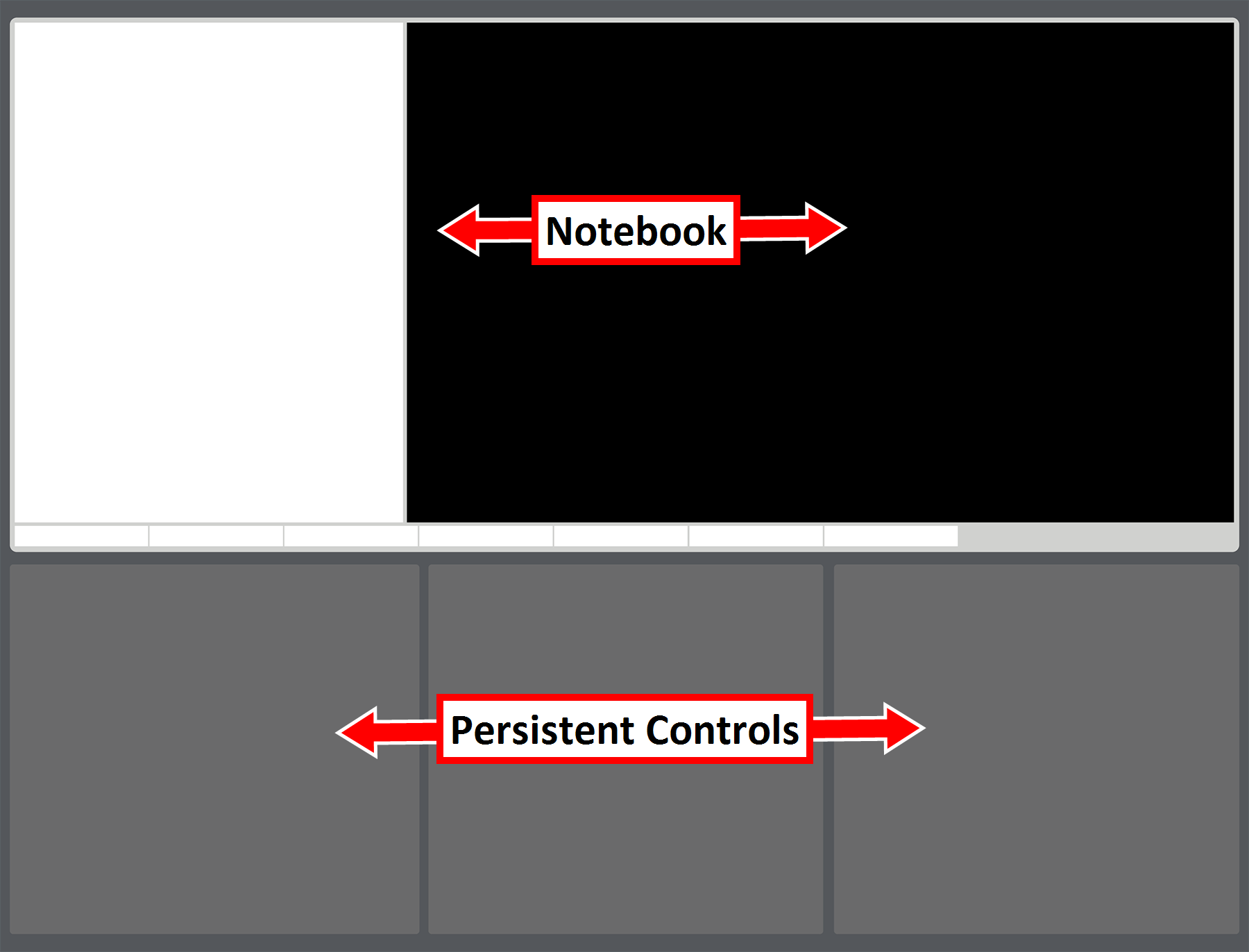

Figure 1: Sections in the PathPilot interface.
Notebook Section
Figure 2: Notebook section.

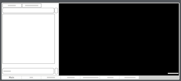

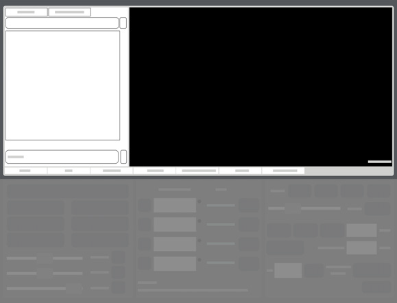

Main Tab
Figure 3: Main tab.
  • Access G-code files that are already loaded into PathPilot, and open or close them.
    For information, see “Load G-Code
  • Send G-code commands directly to the machine using the Manual Data Input (MDI) Line DRO field.
  • In a G-code program, do tasks like finding specific terms in the code, reading the code, or viewing the generated tool path.
    For information, see “Read G-Code”.

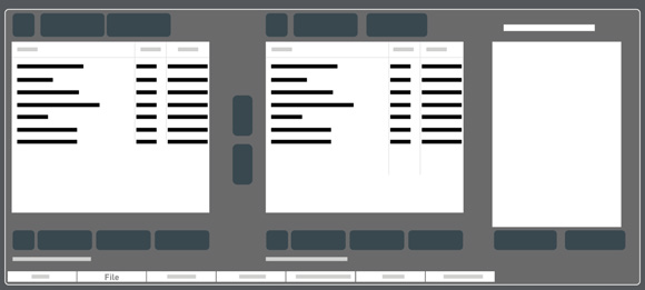

File Tab
Figure 4: File tab.
  • Transfer G-code files into the PathPilot controller.
    For information, see “Load G-Code”.
  • Edit G-code files.
    For information, see “Edit G-Code”.
  • Load .nc files into PathPilot to run a program.
  • Move files within the system.
    For information, see “Load G-Code”; “Manage System Files”.

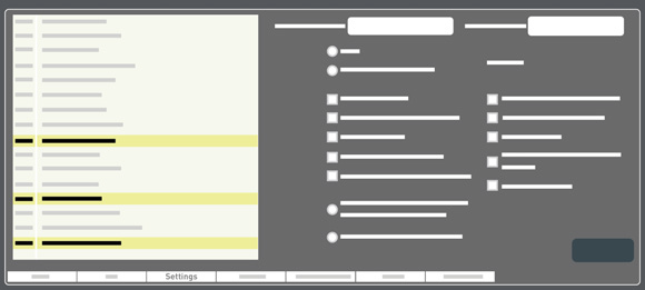

Settings Tab
Figure 5: Settings tab.

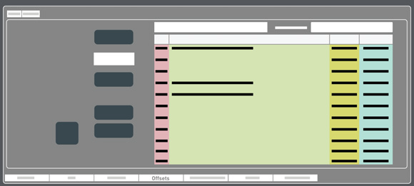

Offsets Tab
Figure 6: Offsets tab.

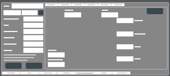

Conversational Tab
Figure 7: Conversational tab.

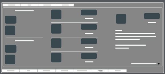

Probe Tab
Figure 8: Probe tab.
From the Probe tab, you can do the following activities:

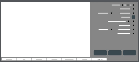

Status Tab
Figure 9: Status tab.

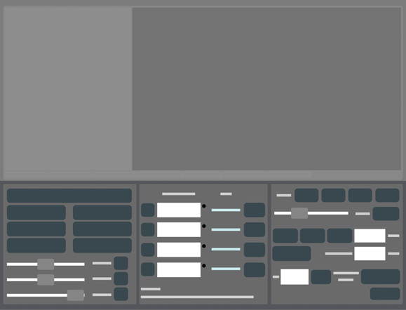

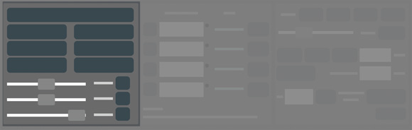

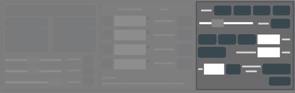

Persistent Controls
Figure 10: Persistent Controls section.
Program Control Area
Figure 11: Program Control area.

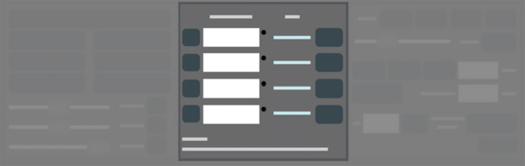

Position Status Area
Figure 12: Position Status area.
Manual Control Area
Figure 13: Manual Control area.

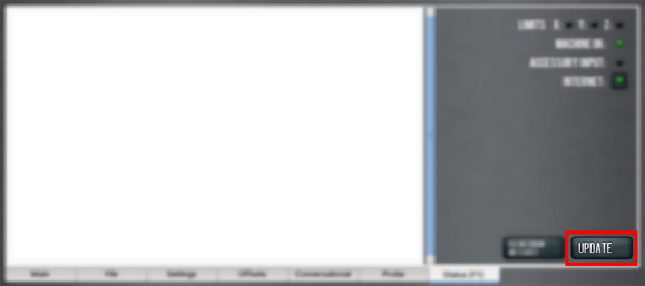

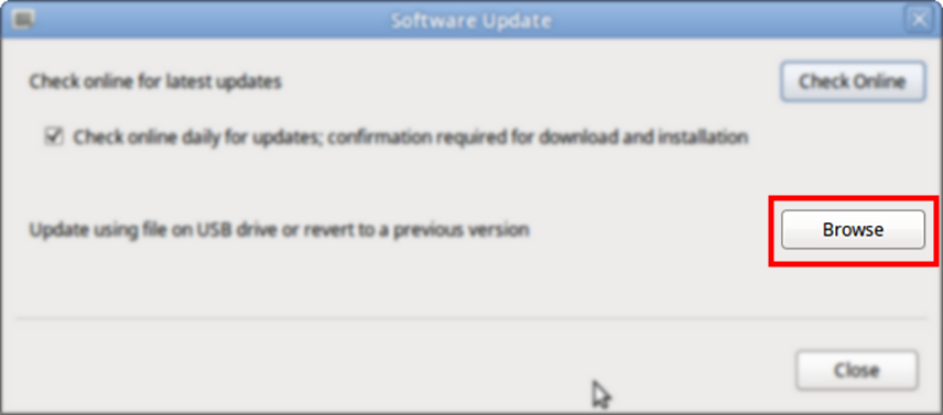

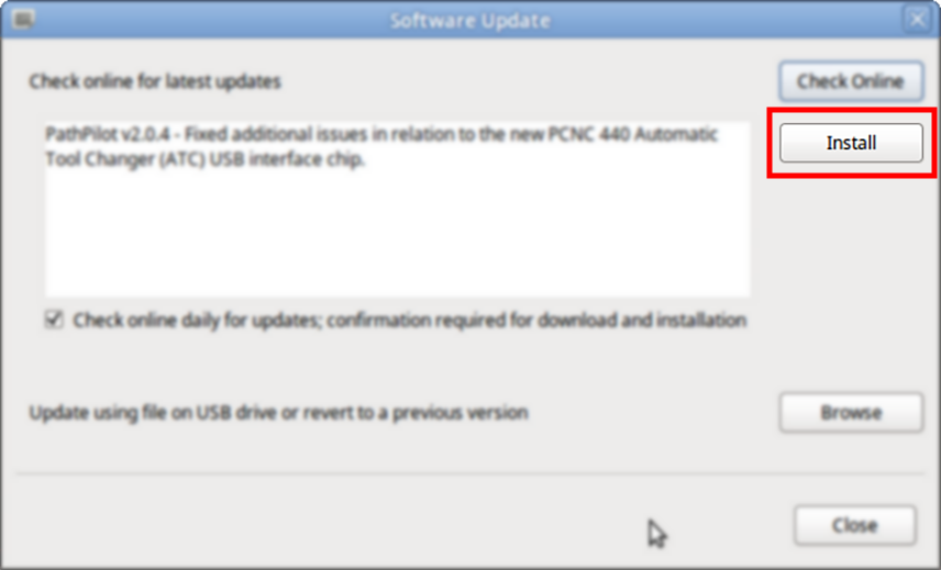

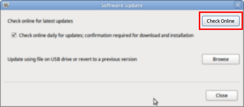

Manage PathPilot Versions
Figure 14: Update button on the Status tab.
Figure 15: Software Update dialog box.
  1. Select Install.
Figure 16: Install button on the Software Update dialog box.

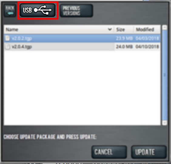

Figure 17: Update button on the Status tab.
Figure 18: Software Update dialog box.

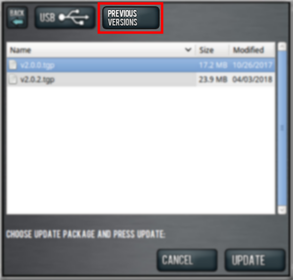

Figure 19: Browse dialog box.
  2. From the Status tab, select Update.
Figure 20: Update button on the Status tab.
Figure 21: Software Update dialog box.
  1. From the Browse dialog box, select Previous Versions.
Figure 22: Browse dialog box.
