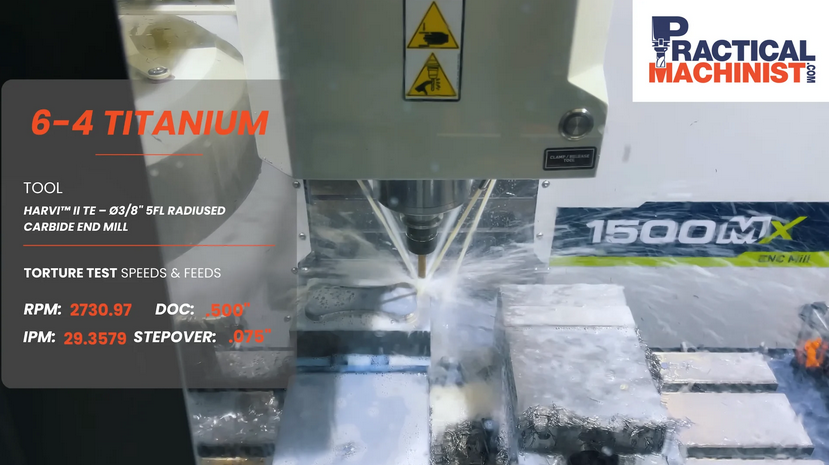

The 1500MX Takes on Superalloys and Titanium
The test then moved into less familiar territory with Inconel 625, 6Al-4V titanium, and Hastelloy C22. For Inconel, adaptive cutting remained stable at moderate spindle load. During heavier engagement, load approached higher levels and required a reduction in stepover. Once adjusted, the machine completed the operation and maintained consistent wall finish.
Titanium presented a different profile. Adaptive cutting ran at moderate load, and the heavier stepover pass stayed within manageable levels. Despite this being a first time cutting titanium in this setup, the results showed smooth transitions and stable tool performance.
