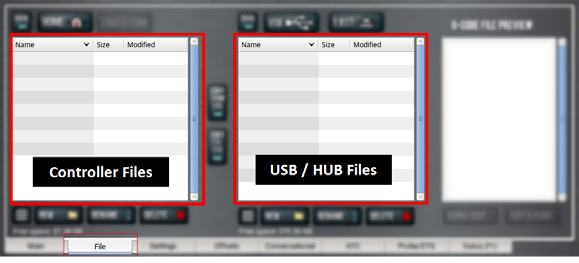

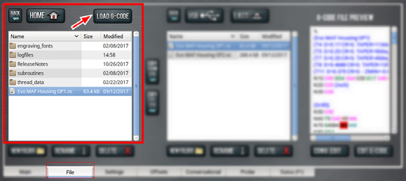

Load G-Code
To load G-code:
  2. Select Load G-Code.
Figure 1: Controller Files window on the File tab.
Figure 2: File tab.

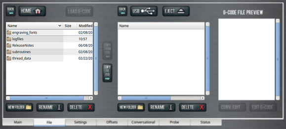

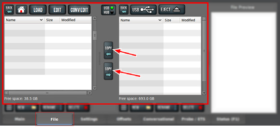

  2. Select either Copy ← or Copy →.
Figure 3: File tab.
  1. If you're using a USB drive, select Eject.

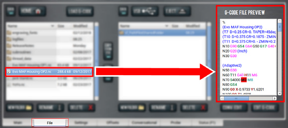

Preview G-Code Files
To preview G-code files:
Figure 4: File tab.

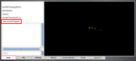

Close the Current Program
Figure 6: Recent Files menu on the Main tab.

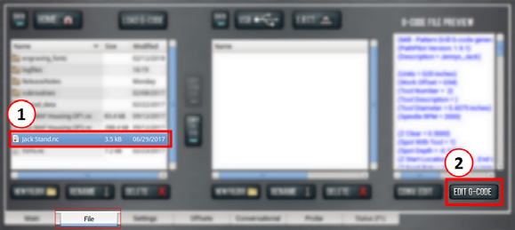

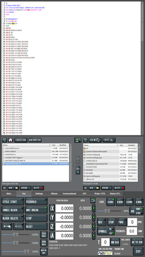

Edit G-Code
Figure 7: Edit G-code button on the File tab.
  2. Close the text editor.

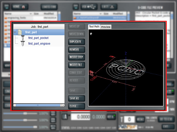

  2. Select Conv. Edit.
Figure 8: Job assignment editor.
    1. Change the Step Order
    2. Create a New Job Assignment
    3. Load an Existing G-Code File
    4. Edit a Job Assignment
  2. Select Save.
  1. Select Insert Step.
  3. Select Insert.
  3. Select Open.
  1. Select the job assignment, and then select Conv. Edit.
  2. Edit the job assignment.
  3. Select Finish Editing.

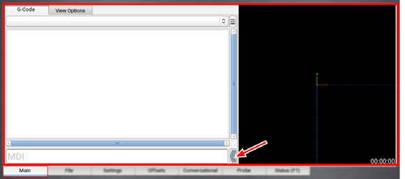

Read G-Code

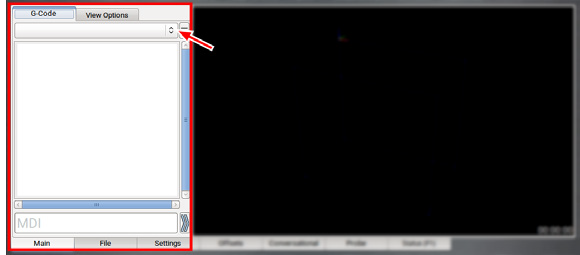

Expand the G-Code Tab
To expand the G-Code tab:
  • Select the Window Expander.
Figure 9: Window Expander on the Main tab.

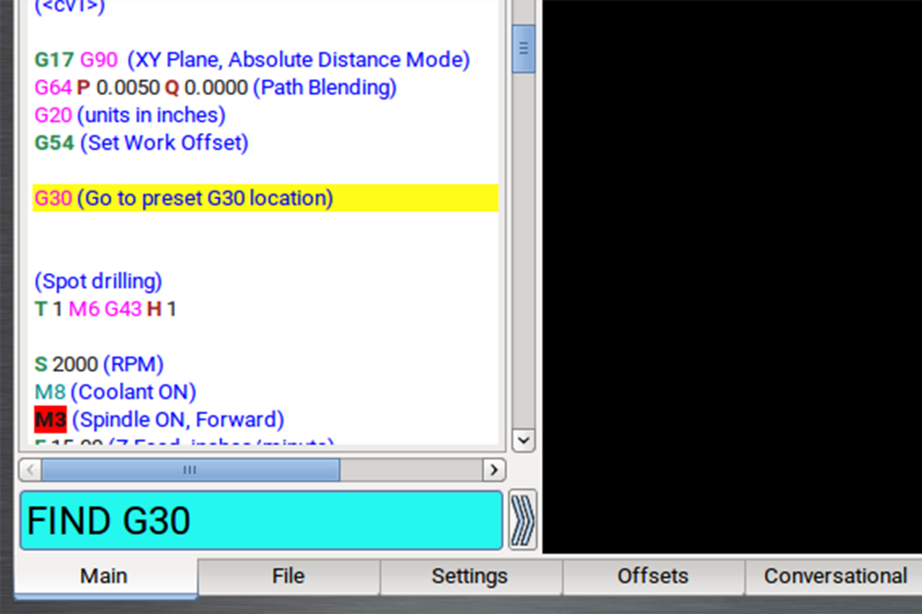

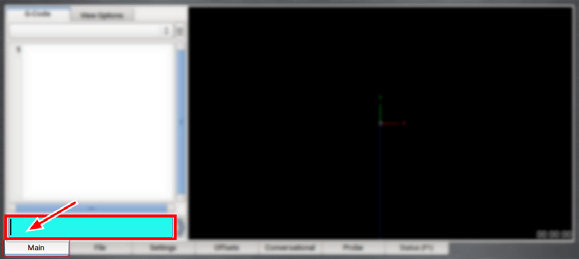

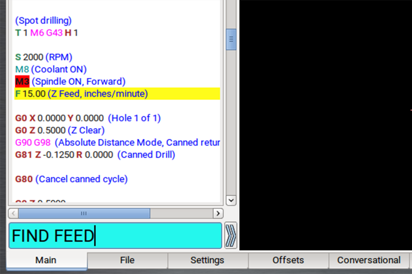

Search in the Code
To search in the code:
    1. Any text. PathPilot searches for instances of the specific number or code.
Figure 10: Search for a text command.
b. Feed. PathPilot searches for instances of the actual word Feed and any F G-code command.
Figure 11: Search for a feed command.
c. Speed. PathPilot searches for instances of the actual word Speed and any S G-code command.
d. Tool. PathPilot searches for instances of the word Tool and any T G-code command.
  1. Select the Enter key.
  2. (Optional) Select Enter.

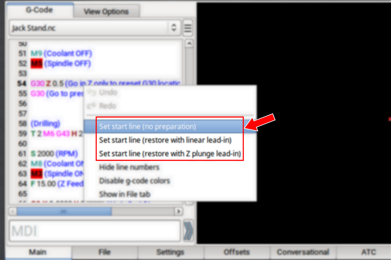

Set a New Start Line
To set a new start line:
  • Right-click any line in the program.
Figure 12: Accessing the Options menu by right-clicking.
  • Tap the line. Then, select the Options menu.

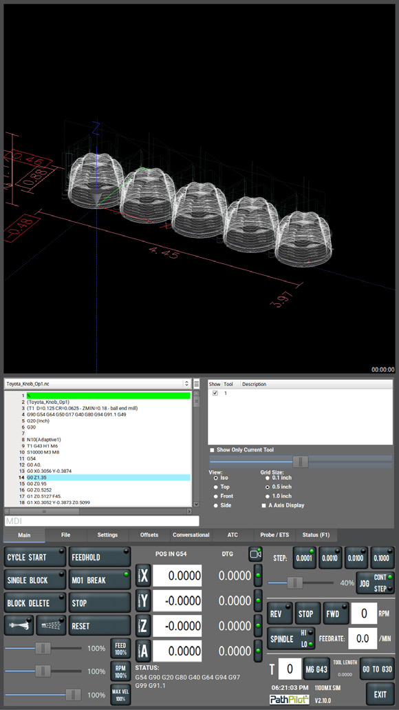

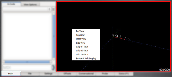

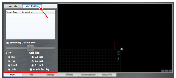

Figure 13: Tool Path display on the Main tab.
Figure 14: View Options tab on the Main tab.
  1. Select a new view.
About the Tool Path Display
  • Front
  • Iso
  • Side
  • Top
  • G20 Mode 1/2 in. intervals
  • G21 Mode 5 mm intervals
  • Select Reset.

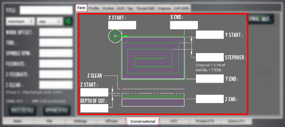

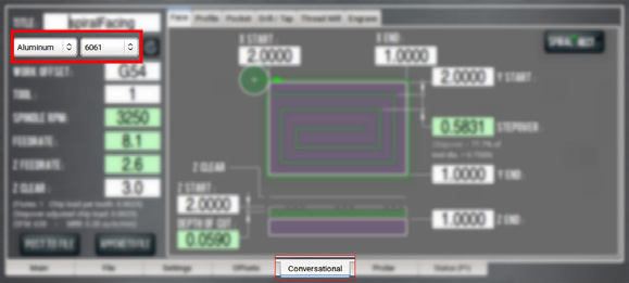

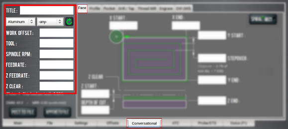

Create a Face on a Part
Using conversational programming, you can program PathPilot to take multiple cuts — each following the last — on an X/Y plane over a Z range. For information, see "About Facing".
  • The area from the rear, left corner of the workpiece to the rear, right corner of the workpiece must be clear of any obstructions from the Z Start position to the Z End position.
  • The top of the workpiece must be free of any workholding devices.
  • The value used in the Z End DRO field must be such that it is above the workholding device.
  • The value used in the Z Clear DRO field must be such that it is above any obstruction in the tool path between the end of one pass and the beginning of the next.

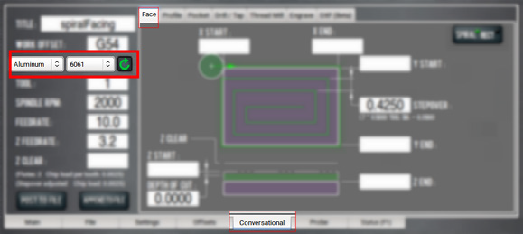

To create a face on a part:
Figure 15: Conversational DROs on the Face tab.
    1. In the X Start DRO field and the X End DRO field, type the location of the workpiece edges. We recommend using the rear left corner of the part for the X Start value.
    2. In the Y Start DRO field and the Y End DRO field, type the location of the workpiece edges. We recommend using the front right corner of the part for the Y End value.
    3. In the Stepover DRO field, type the required distance between tool paths. To prevent uncut areas in the spiral corners, we recommend limiting this value to 80% of the tool diameter. For information, see "Facing Reference".
    4. In the Z Start DRO field and the Z End DRO field, type the location of the first and last Z passes. For a single Z pass at the location typed in the Z End DRO field, type a value of 0 or a full Z range value into the Depth of Cut DRO field.
    5. In the Depth of Cut DRO field, type the desired amount of material to remove.
NOTE: The depth of cut is later adjusted within the Z range so that each pass in the Z range has the same depth (rather than the last Z pass having a short depth of cut).
Figure 16: Program-specific DROs on the Face tab.
About Facing
Face milling is the process of cutting a surface that's perpendicular to the axis of the cutting tool. A facing program is usually used to cut an accurate, finished top surface on a rough piece of stock material. After a facing program is complete, tool marks remain — creating a fairly flat surface, with microscopic height differences.
Facing in PathPilot
When using a facing routine, each tool pass along the X-/Y-axis begins off to the side of the workpiece to avoid plunging into the workpiece. To compensate for this procedure, PathPilot sets lead-in tool paths outside of the workpiece using the part's work offsets, the tool's diameter, and the predetermined stepover value. PathPilot also adjusts the depth of cut to make sure each tool pass has the same depth, rather than cutting a short depth on the last pass of the program.
  1. Moves the machine to the predefined G30 position, or the tool change position.
  2. If required, performs or requests a tool change.
  3. Makes a rapid move in the X and Y direction to the beginning of the workpiece.
  4. Makes a rapid move in the Z direction to the predefined Z Clear position.
  5. Begins the cut in the X/Y plane at an adjusted Z depth of cut.
NOTE: The value entered into the Depth of Cut DRO field is adjusted within the Z range (the value entered into the Z End DRO field minus the value entered into the Z Start DRO field).
  1. Makes cuts in a rectangular spiral from the workpiece perimeter to the workpiece center.
    For information on using conversational programming in PathPilot to face a part, see "Create a Face on a Part".
Facing Reference
PathPilot uses the following terms when creating a face on a part in conversational programming:
  • Stepover Indicates how much space PathPilot creates between each spiral tool path.
  • Z Clear Indicates the Z location that the tool moves (retracts) to when starting or ending a tool pass.

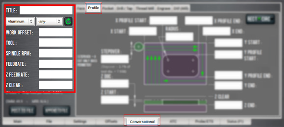

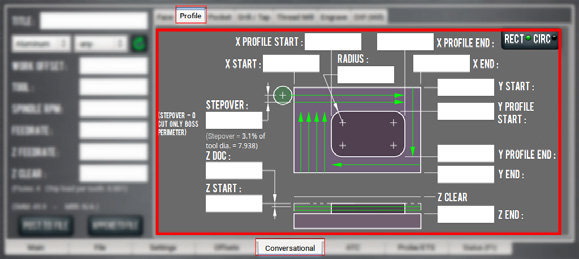

To create a profile on a part:
  2. From the Conversational DROs group, set the parameters for the profiling operation.
Figure 17: Conversational DROs on the Profile tab.
    3. In the X Profile Start DRO field, the X Profile End DRO field, the Y Profile Start DRO field, and the Y Profile End DRO field, type the location of the profile's outer edges.
    4. In the Stepover DRO field, type the required distance between tool paths. If you want a single cut in the workpiece (to create a slot), type 0.
    5. In the Radius DRO field, type the required radius for the corners of the profile. For no corner radius, type 0.
    6. In the Z Start DRO field and the Z End DRO field, type the location for the first and last Z passes. For a single Z pass at Z End, type 0 — or a full Z range value — in the Z DOC DRO field.
    7. In the Z DOC DRO field, type the desired amount of material to remove.
Figure 18: Program-specific DROs on the Profile tab.

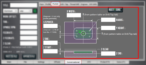

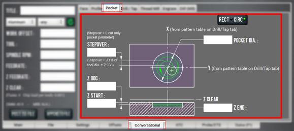

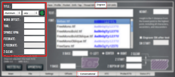

Create a Pocket on a Part
Using conversational programming, you can program PathPilot to take multiple cuts — each following the last — on an X/Y plane over a Z range to form a circular or rectangular pocket. For information, see "About Pockets".
  • The value used in the Radius DRO field must be between 0 and either:
    • One half of the pocket's narrow width, or
    • The full radii on the long ends of the pocket

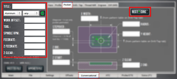

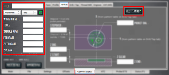

To create a circular pocket on a part:
  1. From the Conversational tab, select the Pocket tab.
  2. From the Conversational DROs group, set the parameters for the pocket operation.
Figure 19: Pocket tab.
    1. In the X Center DRO field and the Y Center DRO field, type the location of the pocket's center.
    2. In the Pocket Dia. DRO field, type the required diameter for the pocket.
NOTE: The radius of the tool is used to set the tool path diameter.
c. In the Stepover DRO field, type the required distance between each rotation of the spiral cut. For a single cut around the inside perimeter of the pocket (to create a slot), type 0.
d. In the Z Start DRO field and the Z End DRO field, type the location of the first and last Z passes. For a single Z pass at the location typed in the Z End DRO field, type a value of 0 or a full Z range value into the Depth of Cut DRO field.
e. In the Z DOC DRO field, type the desired amount of material to remove.
Figure 20: Pocket tab.
To create a rectangular pocket on a part:
Figure 21: Pocket tab.
    1. In the X Start DRO field, the X End DRO field, the Y Start DRO field, and the Y End DRO field, type the location of the pocket edges.
    2. In the Radius DRO field, type the required radius for the corners of the pocket. For no corner radius, type 0.
    3. In the Stepover DRO field, type the required distance between adjacent tool paths. For a single cut around the inside perimeter of the pocket (to create a slot), type 0.
    5. In the Z DOC DRO field, type the desired amount of material to remove.
Figure 22: Pocket tab.
About Pockets
A pocket program is usually used to remove a large amount of material from a part.
Creating Pockets in PathPilot
For more information about creating a pocket on a part using conversational programming, see of the following sections, depending on the shape of the pocket:
For information on using conversational programming in PathPilot to make a pocket on a part, see "Create a Pocket on a Part".

  • Tool Diameter Just Small Enough to Fit Within Pocket Parameters PathPilot does the following in the order listed:
  1. Uses a straight Z plunge into the pocket center. You must use a center-cutting end mill.
  2. Makes a single pass around the perimeter of the pocket at the adjusted Z depth of cut.
  3. Continues to make single passes around the perimeter of the pocket.
  • Length of Pocket More Than Two Times Diameter of Tool PathPilot uses a linear ramp entry.
  • Pocket Parameters More Than Two Times Diameter of Tool PathPilot uses a helical entry.

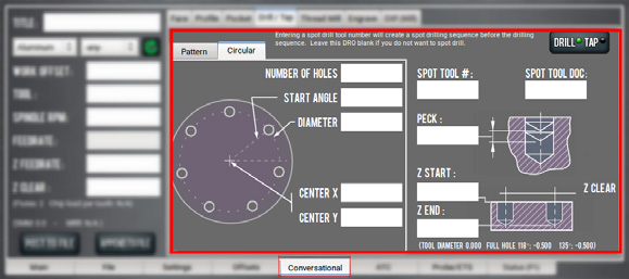

Create Hole Locations on a Part (Drill/Tap)
Using conversational programming, you can program PathPilot to make multiple holes on a part. For information, see "About Drilling and Tapping".
  • In the Conversational DROs group, the value in the Z Clear DRO field must be set to clear any obstructions between hole changes.
To make a specific hole pattern of evenly spaced holes around a circumference (also know as a bolt pattern):
  1. From the Conversational tab, select the Drill/Tap tab.
Figure 23: Drill/Tap tab on the Conversational tab.
  1. From the Drill/Tap tab, select the Circular tab.
  2. In the Number of Holes DRO field, type the number of holes (greater than 0) required for the pattern.
  3. In the Start Angle DRO field, type the value of the angle from angle 0 (from -90 to 90).
  4. In the Diameter DRO field, type the size of the circular pattern (as defined by a line through the center point of each hole).
  5. In the Center X DRO field and the Center Y DRO field, type the location for the center of the hole.
  6. Depending on if you're drilling or tapping the holes, do one of the following:
Use the Location table to make a list of X and Y locations for each hole using the same tool, the same Z location, and the same values in the Conversational DROs group.
NOTE: You can create holes using different tools or different parameters. You must first post the first group of hole locations, enter the second group of hole locations, and then append the second group to the existing posted file.

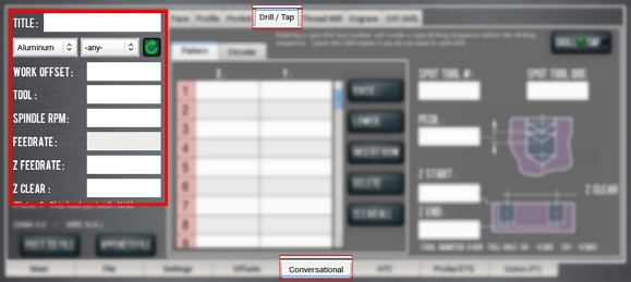

To make a hole pattern based on X and Y locations on a part:
Figure 24: Drill/Tap tab on the Conversational tab.
  1. From the Drill/Tap tab, select the Pattern tab.
  2. In the Location table, select the row, then select the cell to edit.
    Holes indicated in the Location table are completed from top to bottom.
  3. Depending on if you're drilling or tapping the holes, do one of the following:
Tips
  • To rearrange the row order, select a row, and then select Raise or Lower.
  • To clear all values in the table, select Clear All.
  • To make sure that the value is a valid number, leave the cell. If the value isn't a valid number, it's erased, and an error displays on the Status tab.
  • Before posting the file, make sure that there are none of the following:
    • X values without a Y value
    • Y values without an X value
    • An empty row before the last row with values

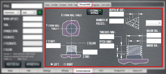

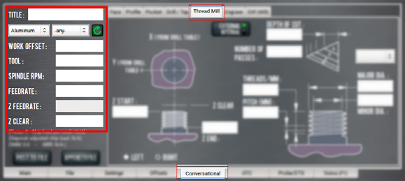

To create threads on a part:
  1. From the Conversational tab, select the Thread Mill tab.
  2. From the Conversational DROs group, set the parameters for the thread milling operation.
Figure 25: Conversational DROs on the Thread Mill tab.
  1. Depending on the type of threads, do one of the following:
  • For external threading (creating threads on a boss, for example), select External.
  • For internal threading (creating threads inside a hole, for example), select Internal.
    1. From the Quick Reference drop-down, select the thread size.
      The Threads/In DRO field, Pitch (In) DRO field, Major Dia. DRO field, and Minor Dia. DRO field auto-fill.
NOTE: The threads listed follow the current unit setting: either inches (G20) or millimeters (G21).
b. In the Z Start DRO field, type the location of the first Z pass (where you want the thread to start).
c. In the Z End DRO field, type the location of the last Z pass (where you want the thread to end).
NOTE: The tool actually goes beyond the value entered in the Z End DRO field, due to the cutting tip width and the Z component of the compound feed angle and thread depth.
d. In the Depth of Cut DRO field or the Number of Passes DRO field, type a value to represent the amount of material to remove in each helical pass. For information, see "Thread Milling Reference".
NOTE: The Depth of Cut DRO field and the Number of Passes DRO field are linked — after you type a value in one and press Enter on the keyboard, the other is auto-filled.
Figure 26: Program-specific DROs on the Thread Mill tab.

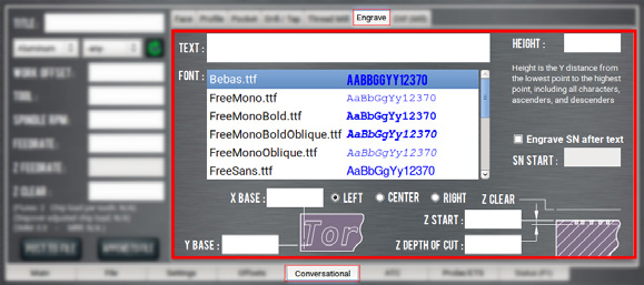

Create Text to Engrave on a Part
Using conversational programming, you can program PathPilot to engrave a single line of text on a part. For example, you could use this feature to engrave True Type stick or outline fonts into things like simple plaques, control panels, or data plates. For information, see "About Engraving" (page 28).
To create an engraving sequence on a part:
  1. From the Conversational tab, select the Engrave tab.
  2. From the Conversational DROs group, set the parameters for the engraving operation.
Figure 27: Conversational DROs on the Engrave tab.
    1. In the Text DRO field, type the desired text to engrave.
      The text appears in the Preview window.
b. From the Font list, select the desired font for the engraved text.
NOTE: To search the Font list, select a font and begin typing the font's name. PathPilot scrolls to the result.
The Preview window updates to display the font selected.
NOTE: You can add True Type font files to the PathPilot controller. For information, see "Transfer Files to and From the Controller".
c. Use the Alignment radio buttons to select the desired alignment of the text: either Left, Center, or Right.
d. In the Height DRO field, type the distance in the Y direction from the top of the text to the bottom of the text.
PathPilot uses the height value, along with font data, to calculate scale for character paths in the G-code program.
NOTE: The value typed in the Height DRO field includes ascenders and descenders, but no the tool cutting diameter. For a more accurate value, subtract the diameter from the overall height.
e. In the X Base DRO field and the Y Base DRO field, type the location of the left side of the first character’s baseline.
NOTE: If any characters in the text have descenders, like y or g, they extend below the baseline.
f. In the Z Start DRO field, type the location of the surface on which to engrave.
g. In the Z Depth of Cut DRO field, type the desired depth the that the cutting tool is fed into the workpiece.
h. In the Z Clear DRO field, type the value for the tool to move or retract to — in the Z direction — at the start and end of the engraving sequence and between characters.
Figure 28: Program DROs on the Engrave tab.

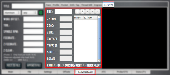

Import a DXF File
Figure 29: DXF tab on the Conversational tab.
  1. Select the File DRO field.
Example

Working in the Preview Window
  • Cyan Selected paths
  • Gray Disabled paths
  • White Drawing path
  • Magenta Cut path
    • Red X-axis
    • Green Y-axis
    • Blue Z-axis

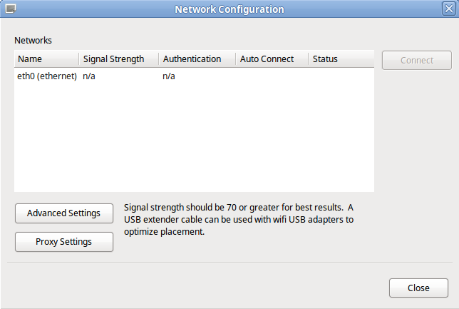

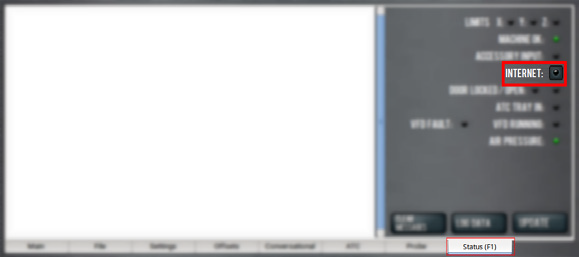

Enable an Internet Connection
If desired, you can enable an internet connection on your PathPilot controller. An internet connection allows you to receive automatic PathPilot updates and transfer files with PathPilot HUB instead of a USB drive.
Figure 30: Internet button on the Settings tab.
Figure 31: Network Configuration dialog box.

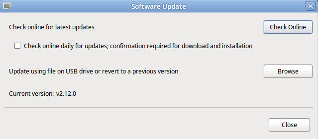

Enable Automatic Updates
To enable automatic updates:
Figure 32: Software Update dialog box.
  2. Select Close.

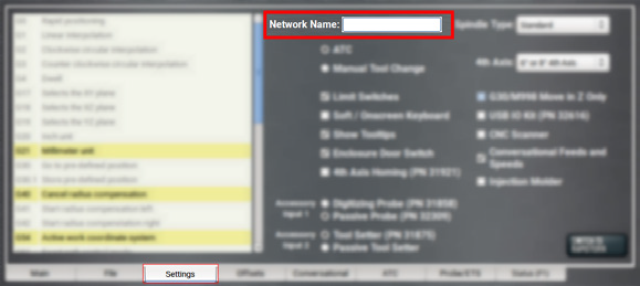

Change the Network Name
To change the network name:
Figure 33: Network Name field on the Settings tab.

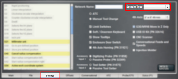

Select the Spindle Type
If you have an additional spindle (separate from the standard spindle), you must first select it in PathPilot.
To select the spindle type:
  • From the Settings tab, from the Spindle Type drop-down, select the appropriate spindle option.
Figure 34: Spindle Type field on the Settings tab.

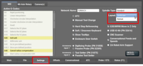

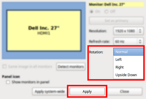

Change the Screen Orientation
A vertical orientation for 1920 × 1080 monitors is supported in PathPilot v2.10.0 and later. For more information on the portrait layout, go to "About Portrait Screen Layout" (page 33).
Figure 35: Layout drop-down menu on the Settings tab.
Figure 36: Monitor configuration dialog box.
Figure 37: Tool Path window in portrait screen layout.
Figure 38: File tab G-code preview in portrait screen layout.

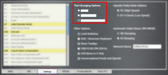

Figure 39: Tool change method options on the Settings tab.
About Automatic Tool Changes
If you're using an Automatic Tool Changer (ATC) to make tool changes, PathPilot does the following:
  1. Looks for an ATC.
    In the PathPilot interface, the ATC tab displays.
  2. When PathPilot finds a Txx M06 command in the G-code program, the ATC loads the specified tool into the spindle.
About Manual Tool Changes
If you're making manual tool changes, PathPilot pauses when it finds an M06 command in the G-code program. While it's paused, PathPilot does the following:
  1. The Cycle Start button flashes.
  2. The Tool Path display shows the requested tool number.

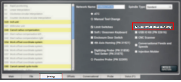

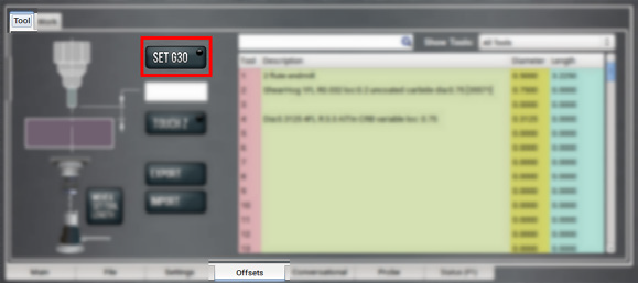

Limit G30 Moves
To limit G30 moves:
Figure 40: Settings tab.
About G30

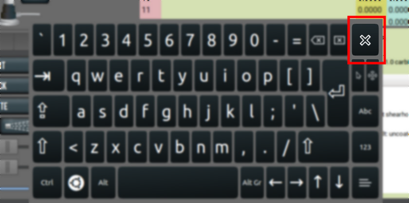

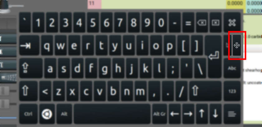

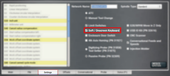

Figure 41: Settings tab.

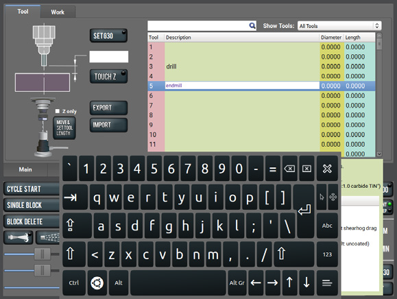

Figure 42: Soft Keyboard
Figure 43: Soft Keyboard
About Soft Keyboards
Figure 44: Soft (on-screen) keyboard.
Figure 45: Settings tab.

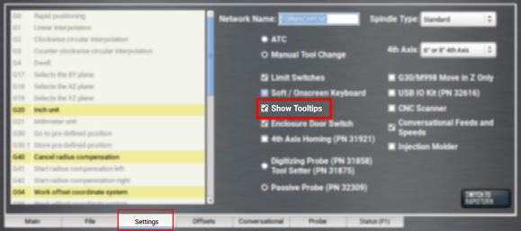

Enable Tooltips
Figure 46: Show Tooltips checkbox.
Figure 47: Settings tab.

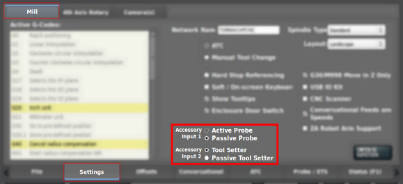

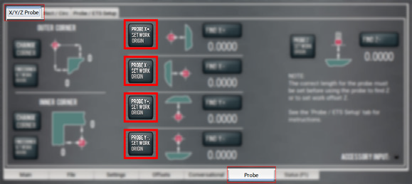

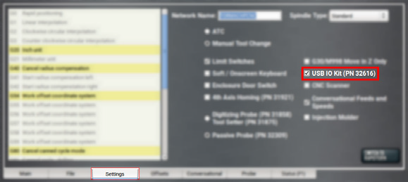

Specify Probing and Tool Measuring Options
If you have any of the following accessories, you must first specify which you're using in the PathPilot interface:
  • Wireless Probe and Tool Setter Kit (PN 51785)
To specify a probe or a tool setter:
  • From the Settings tab, select the correct probing or tool measuring options for both Accessory Input 1 and Accessory Input 2.
Figure 48: Settings tab.

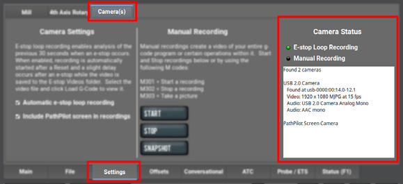

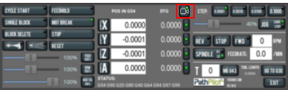

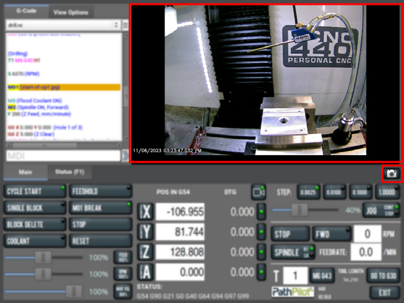

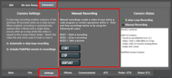

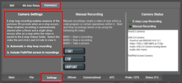

Use a USB Camera
Figure 49: USB camera status.
NOTE: If a camera isn't shown after plugging it in or starting a video recording, it might require too much power from the USB ports on the controller. This is very likely when more than one camera is used. Try using a powered USB hub to add the camera(s).
About USB Cameras
Manual Recording
Figure 50: Manual recording controls.
Figure 51: Video Camera Recording button.
Figure 52: Camera settings.
    The Main tab displays.
Figure 53: Example of taking a photo.
To view E-stop videos:
Review Video and Image Files
File Naming Convention
File Name
Description of File
Left Bracket Op1_0.mp4
Camera 0 mp4 video file
Left Bracket Op1_0.log
Left Bracket Op1_1.mp4
Camera 1 mp4 video file
Left Bracket Op1_1.log
Left Bracket Op1_PP.mp4
Left Bracket Op1_PP.log

  1. Press the probe tip and make sure that, from the PathPilot interface, on the Probe tab, the Accessory Input light comes on.
    This indicates that the probe polarity is correctly specified.
If the Accessory Input light does not come on, you must change the probe polarity setting. For information, see "Specify Probing and Tool Measuring Options".

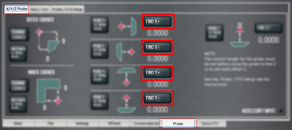

Use a Probe to Find a Feature's Location
To find the location of a workpiece or vise in the current work offset coordinates:
  1. From the PathPilot interface, on the Probe tab, select the X/Y/Z Probe tab.
  2. Position the probe near the workpiece or vise.
  3. One at a time, select Find X+, Find X-, Find Y+, Find Y-, or Find Z-.
Figure 54: Probe tab.
The axis is probed, and the location of the probed surface is displayed.

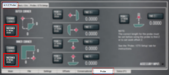

Set the X and Y Work Offset Zero on the Corner of a Feature
  2. Position the probe so that it is below the surface of the feature and 1 in. away from the vice jaw corner in the X and Y directions.
  3. Select Find Corner, Set Work Origin.
Figure 55: Probe tab.
The axes are probed, and the location of the probed surface is set as the current work offset's X/Y origin.
NOTE: Select Change Corner to change the corner on which to probe.
Set the Work Offset Zeroes on a Feature
  3. One at a time, select Probe X+, Set Work Origin, Probe X-, Set Work Origin, Probe Y+, Set Work Origin, Probe Y-, Set Work Origin, or Probe Z-, Set Work Origin.
Figure 56: Probe tab.
The axis is probed, and the location of the probed surface is set as the current work offset's origin.

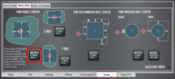

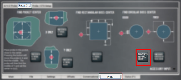

Use a Probe to Find the Center of a Feature
You can find the center of a pocket, slot, or boss on a part using a probe.
Find the Center of a Pocket
  1. From the PathPilot interface, on the Probe tab, select the Rect/Circ tab.
  2. Position the probe near the center of the pocket.
  3. Select Find Center, Set Work Origin as shown in the following image.
Figure 57: Probe tab.

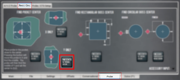

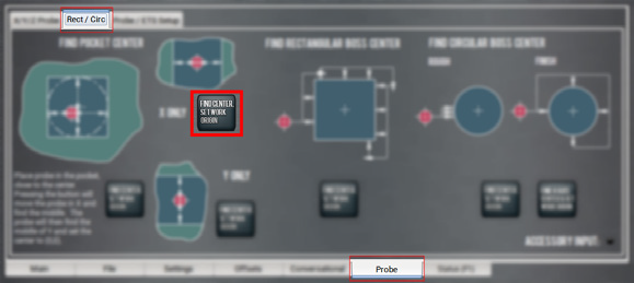

Find the Center of a Slot
  2. Position the probe near the center of the slot.
  3. Depending on the slot, do one of the following:
    1. To probe the slot in the X direction only, select Find Center, Set Work Origin as shown in the following image.
Figure 58: Probe tab.
b. To probe the slot in the Y direction only, select Find Center, Set Work Origin as shown in the following image.
Figure 59: Probe tab.

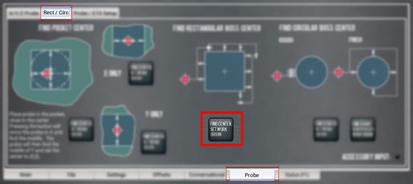

Find the Center of a Rectangular Boss
  2. Position the probe below the top surface of the boss and on the left-hand side.
Figure 60: Probe tab.
The probe moves around the edge of the workpiece to find the center.
Find the Center of a Circular Boss
Figure 61: Probe tab.
The probe moves around the workpiece three times to determine the approximate center of the curve, and then makes four additional move to confirm the center of the circle.

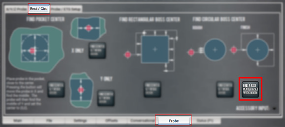

Find the Center Rotation of an A-Axis
  2. Position the probe directly above the A-axis center of rotation.
  3. Select Find A Axis Center & Set Work Origin.
Figure 62: Probe tab.
The probe moves around the round workpiece mounted in the A-axis to find the center rotation of the A-axis.

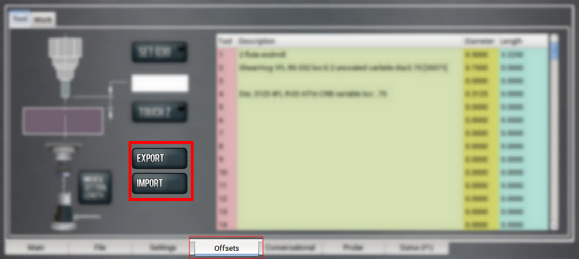

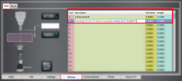

Set Tool Length Offsets

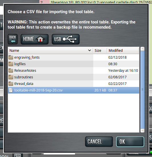

NOTE: You can import a .csv file with tool length offset data. For information, see "Import and Export the Tool Table".
To set tool length offsets:
    For information, see "Set Up Tooling".
Figure 63: Tool Table window on the Offsets tab.

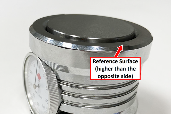

    1. Use a Tool Height Setter For information, see "Use a Tool Height Setter to Measure Tools".
    2. Use an Electronic Tool Setter For information, see "Use an Electronic Tool Setter (ETS) to Measure Tools".
    3. Touch Off of a Known Reference Height For information, see "Touch Off the Tool Length Offsets".
About Tool Offsets
Set a Known Reference Height
  2. Verify that the drive dogs won't contact the reference surface before the end face of the spindle.

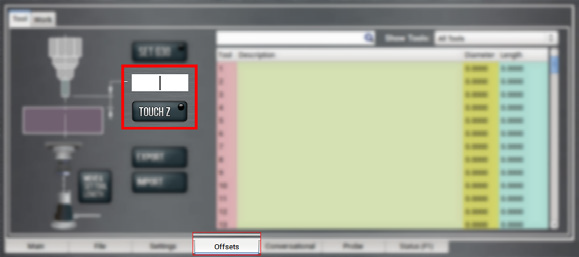

  8. While moving the paper back-and-forth across the reference surface, slowly step the Z-axis down (-Z) until you feel a light pull on the piece of paper. This indicates that the paper is contacting the end face of the spindle.
Figure 64: Z-axis work offset DRO field.
Figure 65: Tool DRO field.
Figure 66: Touch Z DRO field and button.
  1. Select Touch Z.
  4. Jog the Z-axis up (+Z).
Figure 67: Tool DRO field.
Figure 68: Tool tab on the Offsets tab.

  4. From the PathPilot interface, on the Offsets tab, in the Tool Table window, in the Description column, type a description for the tool.
  5. In the Diameter column, type the diameter of the tool. Then select the Enter key.
  6. Install a tool into the spindle.

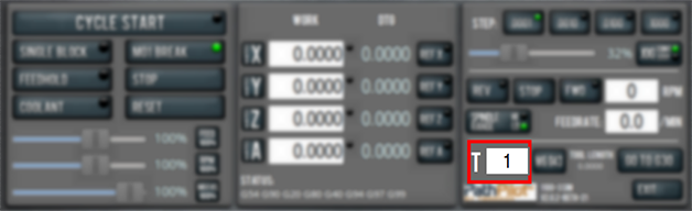

  7. From the PathPilot interface, type the tool number in the Tool DRO field. Then select the Enter key.
 Figure 69: Tool DRO field.

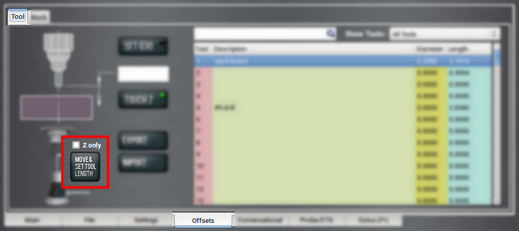

  1. On the Offsets tab, find the Move and Set Tool Length button and the Z only checkbox. Verify that the checkbox is cleared, and then select Move and Set Tool Length.
Figure 70: Tool tab on the Offsets tab.
Note: You should only use the Z only checkbox to manually measure tools with a larger diameter. When it’s selected, the machine doesn’t go to the G37 position - instead, it just moves straight down (Z-) to measure the tool.
The machine moves to the G37 position and measures the tool with the ETS.

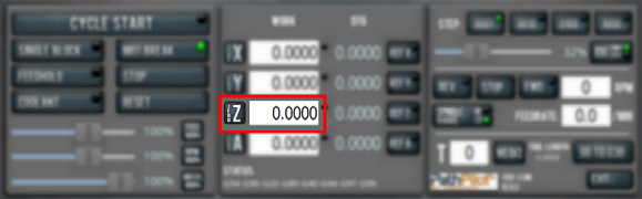

Figure 71: Z-axis work offset DRO field.
Figure 72: Tool Height Setter.

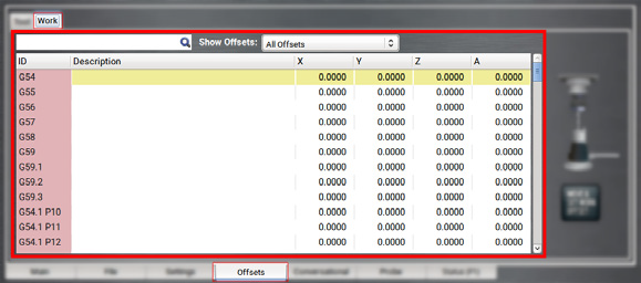

Set Work Offsets
  • Select Zero [Axis].
Figure 73: Work Offset DRO fields.
To change work offsets:
Figure 74: Work offset indicated in the PathPilot interface.
About Work Offsets
Work Offset Naming
Offsets 1-9 (Use either name)
Offset
Extended Name
Name
G54.1 P1
G54
G54.1 P2
G55
G54.1 P3
G56
G54.1 P4
G57
G54.1 P5
G58
G54.1 P6
G59
G54.1 P7
G59.1
G54.1 P8
G59.2
G54.1 P9
G59.3
Offset
Extended Name
Name
G54.1 P10
Not used
11
G54.1 P11
Not used
499
G54.1 P499
Not used
500
G54.1 P500
Not used
View Work Offsets
Figure 75: Work Offsets Table window.

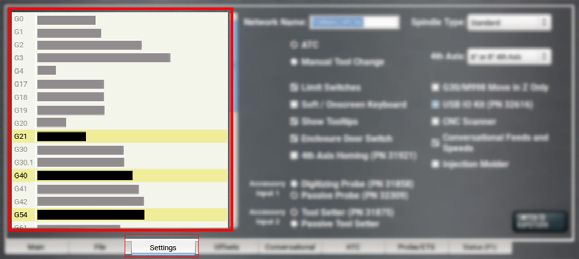

View Available G-Code Modes
Figure 76: G-code Description window on the Settings tab.

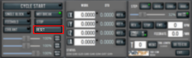

Run G-Code Programs
  • Select Reset.
Figure 77: Reset button.
About Reset Mode
  • Clears alarms

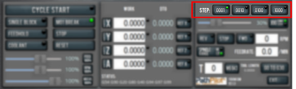

Jog in Step Mode
To select the step size:
In the Manual Control Area, select the step size.
Figure 84: Step buttons (in G20 mode).
About Step Jogging

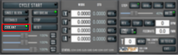

Operate the Coolant Pump
To turn coolant on or off:
  • Select Coolant.
Figure 89: Coolant button.
About Coolant

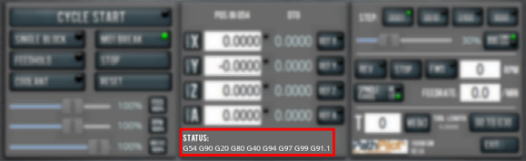

View the Active G-Code Modes
Figure 90: Status read-only DRO field.

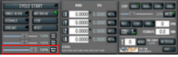

Figure 93: Feed Rate Override slider.
  • Select Feed 100%.
About Feed Rate Override

Use a G30 Position
To set a G30 position:
Figure 101: Set G30 button.
To go to a set G30 position:
  • Select Go To G30.
Figure 102: Go to G30 button.
About G30

Manually Enter Commands
To manually enter commands:
Figure 104: MDI Line DRO field.
The DRO field highlights.
2. Type the command.
About the MDI Line DRO Field

Admin Network
Configure a Wi-Fi network.

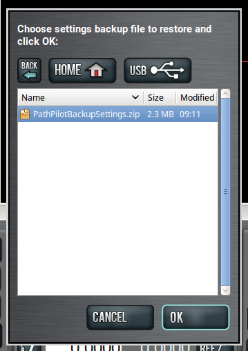

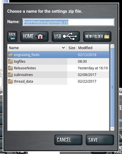

Admin Settings Backup
Admin Settings Restore

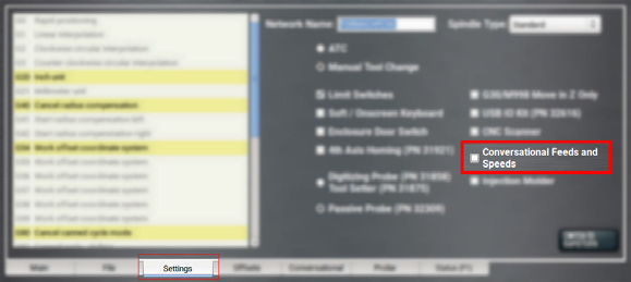

ADMIN TOOLTIP MAXDISPLAYSEC
Admin Touchscreen
Admin Version
Figure 105: Settings tab.
Figure 106: Feeds and speeds suggestions on the Conversational tab.
  • Spindle RPM
  • Feedrate
  • Z Feedrate
  • Depth of Cut
  • Stepover
  • Peck (if drilling)
Refresh DRO Field Values
Figure 107: Refresh button on the Conversational tab.
Use Additional Provided Information
The following tips are displayed based on the calculations that PathPilot is performing:
  • Chip Load Information Chip load — the amount of material removed per tooth — is based on the number of flutes, RPM, and feed rate.
    As the stepover value decreases, the actual chip load decreases. If the stepover is too small, the cutter may not have enough contact with the material to cut — effectively resulting in premature tool wear.
  • Cutting Speed Information Cutting speed is the speed that a given tooth (flute) on the cutter will be moving when it cuts through the material. All materials have a documented cutting speed.
    In imperial units, cutting speed is measured as surface feet per minute (SFM).
    In metric units, cutting speed is measured as surface meters per minute (SMM).
  • Material Removal Information The material removal rate (MRR) indicates how much material is removed by the tool per minute while cutting.

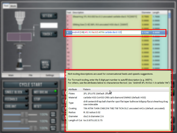

Create Tool Descriptions
  1. From the PathPilot interface, on the Offsets tab, identify the Tool Table window.
  2. Select a blank line.
Figure 108: A manually-entered tool description.
Examples
Example
Dia:.3125 4FL R:03 AlTiN CRB variable loc:.75
  • 0.3125 tool diameter
  • Four flutes
  • 0.03 radius, or "bullnose"
  • Carbide
  • Variable helix
  • 0.75 length of cut (loc)
Example
Gold colored end mill from middle drawer
This description provides very little information, and PathPilot defaults to basic cutter features:
  • Two flutes
NOTE: If you don't know the part number, you can search for the tool at tormach.com.
  2. Type the part number for the tool, like 35571.
Figure 109: An automatically-generated tool description for a Tormach tool.
Tool Keywords Reference
Item
Pattern
Example
Notes
type
Drill, Ball, Flycut, Drag
flutes
4FL, 12FL, 2flute
length of cut (or flute length)
loc:0.875
tool coating
TiN, ZrN, TiB2
No coating is specified same as “uncoated.”
tool diameter
Diameter:.0341, dia:.750
tool material
HSS, CoHSS, crb
No tool material is specified the same as HSS (high-speed steel).
tool radius
R:.02, radius:0.02

System File Management
Manage System Files
Use the File tab to manage system files on the PathPilot controller. For information, see "Transfer Files to and From the Controller".
To manage system files:
    • Select a file, and go to the Options menu. Then, select Copy, Cut, or Paste.
  • Select Back or Home.
Create Backup Files
Figure 110: Admin Settings Backup dialog box.
  2. Select Save.
Figure 111: Controller Files window on the File tab.
  • logfiles
  • media
  • ReleaseNotes
  • subroutines
  • USB
  1. Select Copy to USB.
About Backup Files
Restore Backup Files
Figure 112: Admin Settings Restore dialog box.
Figure 113: USB Files window on the File tab.
  2. Select Copy From USB.

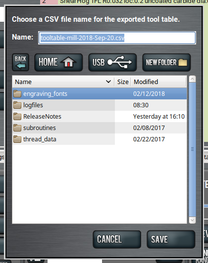

Figure 114: Export and Import buttons on the Offsets tab.
Import a .csv File
Figure 115: Import dialog box.
Figure 116: Export dialog box.
  2. Select Save.
  4. Select Eject.
