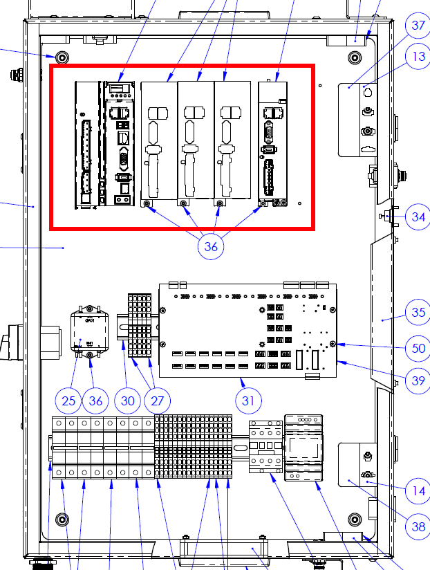

Examine the Servo Drives
Reason: The servo drive has an error present.
  1. Examine the Servo Drives in the electrical cabinet for an error code.
  2. Power cycle the machine to see if the error reappears.
  3. If so, contact Technical Support .
