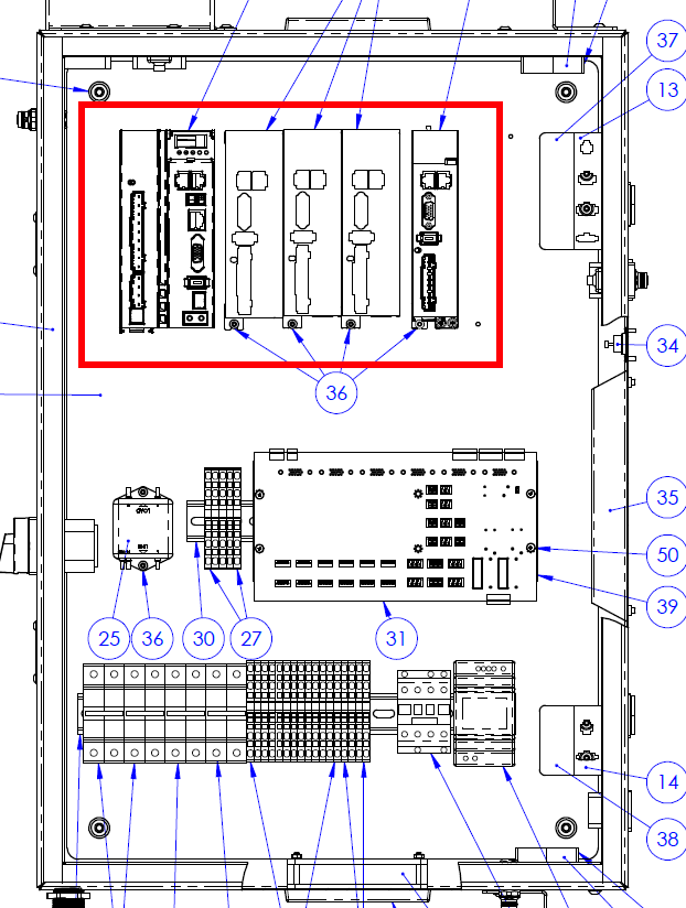

Check Driver Connections
Reason: There’s a loose wire connection or failed connector.
  1. Power off the machine (see Verify the Installation | Power off the Machine). Then check all driver connections.
1500MX Driver Location
