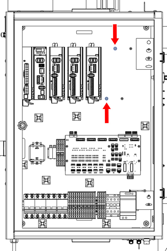

Install the A-Axis Driver

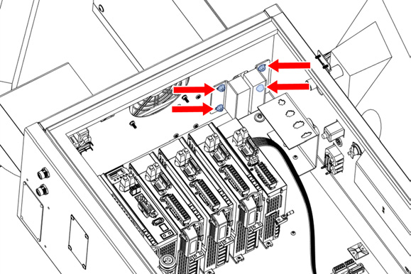

  2. Open the electrical cabinet door.
  3. Locate the two screws next to the Z-axis driver. Remove the top screw and set it aside, and loosen the bottom screw with a 2.5 mm hex wrench.
Figure 1: A-axis driver screws pre-installed in the electrical cabinet.
  1. Remove the ground wire from the bottom screw. You'll connect it to the A-axis driver later in this procedure.

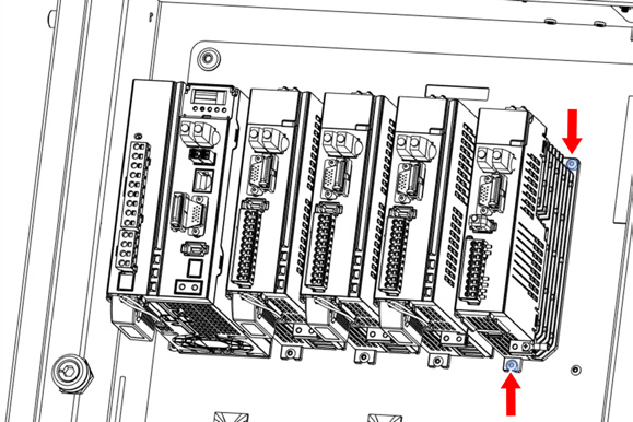

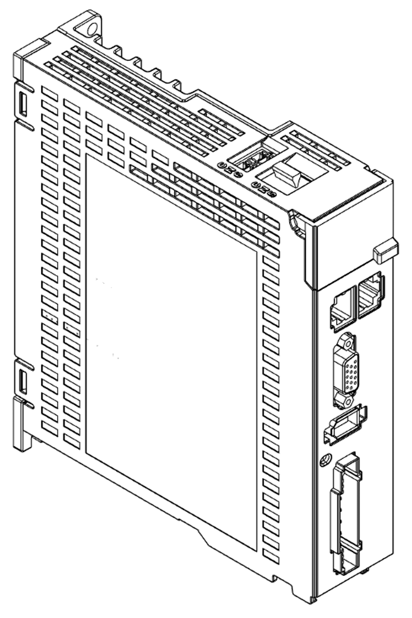

  2. Find the A-axis driver included with this kit.
Figure 2: A-axis driver.
  1. Install the A-axis driver into the electrical cabinet next to the Z-axis driver using the two screws that you identified in Step 3. Place the driver onto the loosened bottom screw and reinstall the top screw with a 2.5 mm hex wrench. Tighten both screws.
Figure 3: A-axis driver installed in the electrical cbinet.

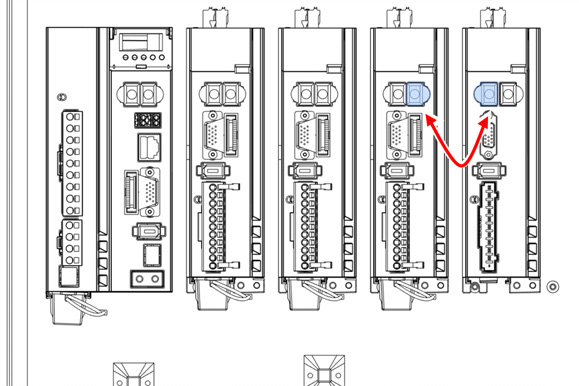

  1. Identify the EtherCAT cable that's connected to the right port of the Z-axis driver. Disconnect the cable from the Z-axis driver and connect it to the output port on the A-axis driver.
Figure 4: EtherCAT cable connection on the Z-axis and A-axis drivers.

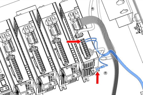

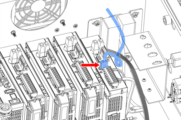

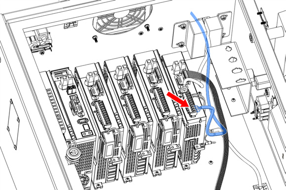

  1. Identify the STO cable that's pre-installed in the electrical cabinet. Connect it to the A-axis driver.
Figure 5: STO cable connected to the A-axis driver.

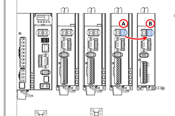

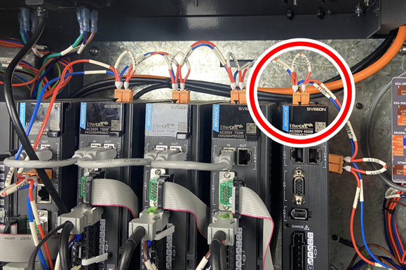

  1. Identify the EtherCAT jumper cable included in this kit. Connect it to both the Z-axis driver and the A-axis driver.
Figure 6: EtherCAT jumper cable connections on the Z-axis and A-axis drivers.

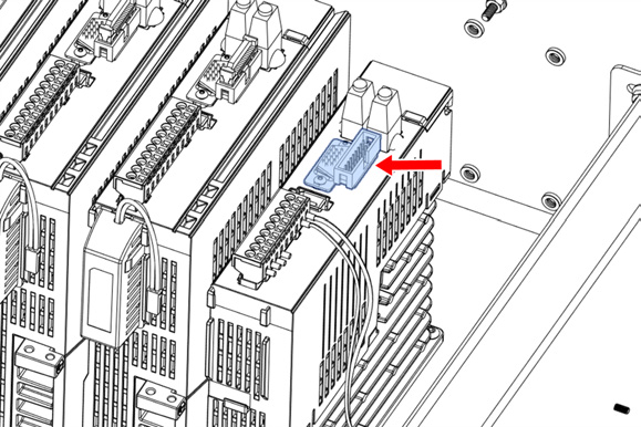

  1. Identify the 9-pin connector that's pre-installed in the electrical cabinet's wiring harness. Connect it to the A-axis driver.
Figure 7: 9-pin connector connected to the A-axis driver.

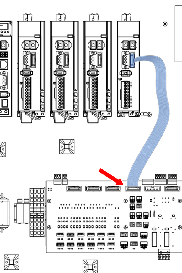

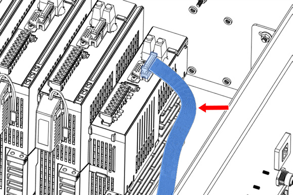

  1. Identify the IDC ribbon cable that's included in this kit. Connect one end to the A-axis driver.
Figure 9: IDC ribbon cable connected to the A-axis driver.
  1. Connect the loose end of the IDC ribbon cable to the IDC header on the machine control board.
Figure 10: IDC ribbon cable connected to the machine control board.

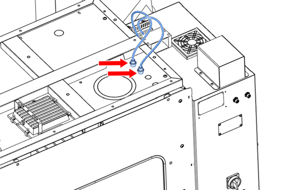

  1. On the top right panel of the enclosure, identify the A-Axis Motor and A-Axis Encoder knockout holes. Use a hammer and punch to remove the knockouts.
  2. Identify the motor and encoder cables, which are shipped connected to the microARC itself. Disconnect them.
  3. Remove the nut from the bulkhead connector for the power cable (the cable with the 4-pin connector). Put it in the A-Axis Motor hole, and thread the nut onto the bottom from inside the enclosure. Repeat this step to secure the encoder bulkhead into the top panel.
Figure 11: A-axis motor and encoder cables routed through the enclosure's knockout holes.

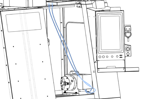

  1. Route the loose end of the power and encoder cable through the channel on the top of the enclosure, and toward the electrical cabinet.
  2. Identify the cable gland plate on the top right of the electrical cabinet. Loosen the four nuts that secure it to the cabinet, insert the encoder and power cables through the cable gland plate, and tighten the four nuts.

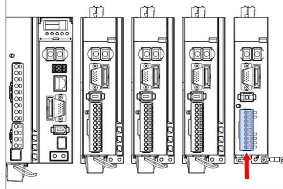

  1. On the 9-pin connector that you previously connected to the A-axis driver, connect the four motor power cables to the A-axis driver according to their labels (U, W, V, PE).
Figure 14: A-axis motor power wires connected to the A-axis driver.

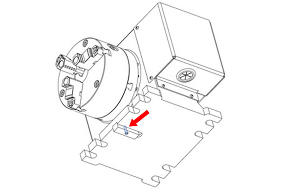

  4. Identify the T-slot alignment pin (PN 51851) included in this kit. Install it onto the bottom of the microARC with its screw (PN 51839) and a 2 mm hex wrench.
Figure 16: T-slot alignment pin installed.

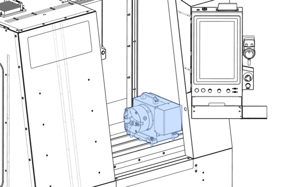

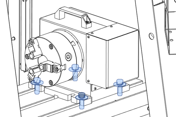

  1. Place the microARC 6 on the machine table.
Figure 17: microARC on the machine table.
  1. Secure the microARC to the machine table with the mounting hardware and a 3/8 in. hex wrench.
Figure 18: microARC secured to the machine table.

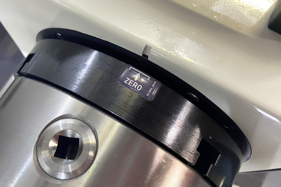

    3. Press the Reset button.
  2. Manually jog the A-axis to align the reference mark on the casting within the bracket on the reference label. Once aligned, from the PathPilot interface, select Reference A-Axis.
Figure 20: microARC aligned to the Zero label.
