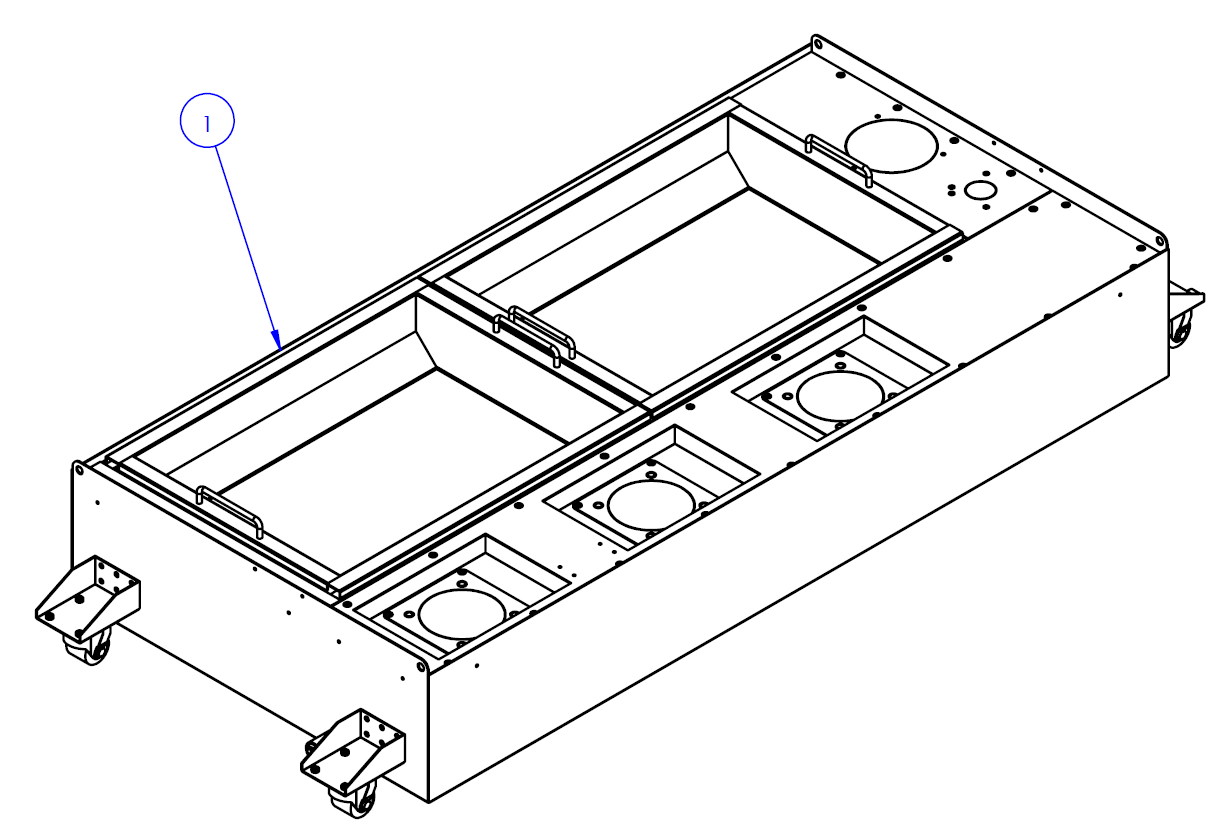

1500MX Coolant Tank Assembly with Chip Baskets (PN 51371)
For details, go to "Coolant Tank Assembly".

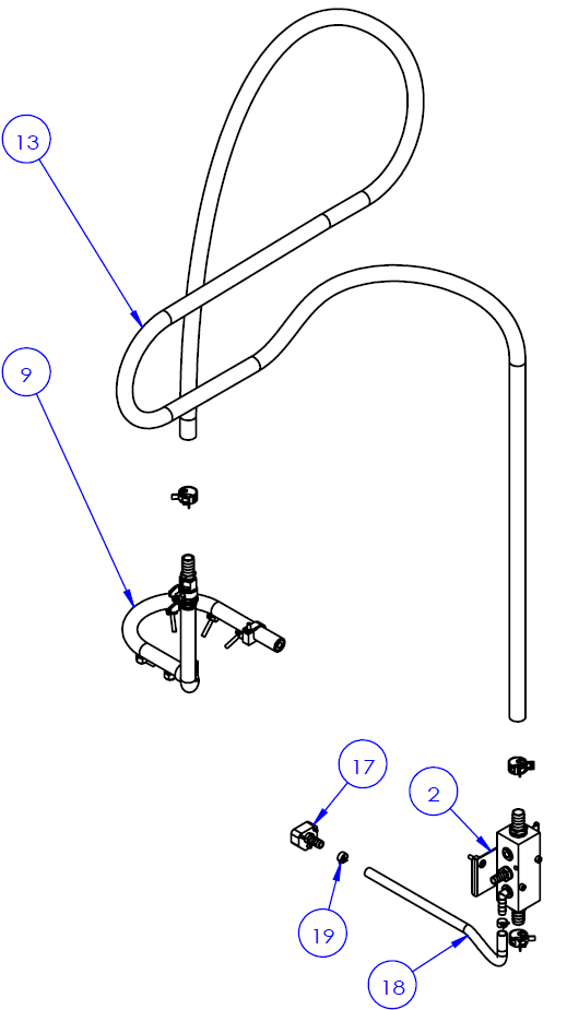

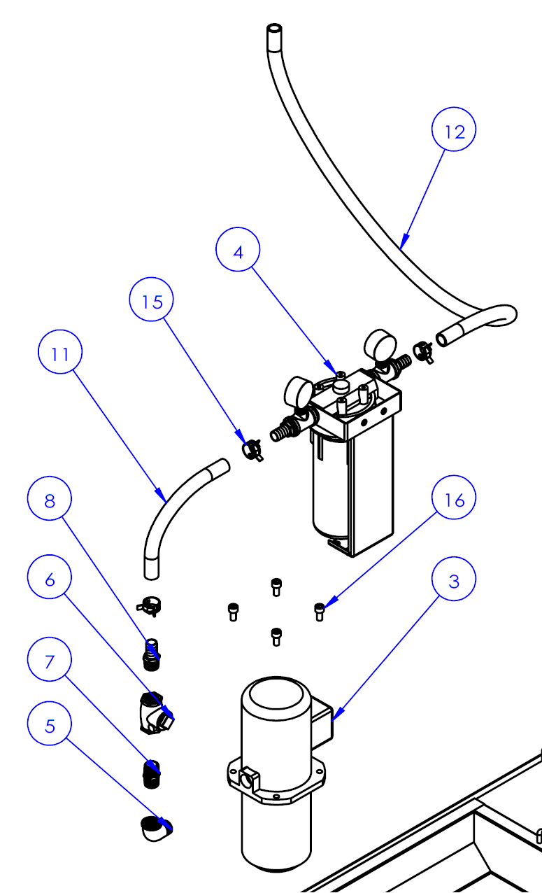

Flood Coolant Manifold Assembly, 1500MX (PN 51565)
Coolant Pump, Dual Voltage (Preset to 240), 1/4 hp, 180 mm
Length, 3/4 NPT Outlet, 2 m 14 AWG Cord (with Right-Angle C14
Plug) (PN 51384)
Flood Coolant Filter Assembly, 1500MX (PN 51614)
Fitting, Street Elbow Adapter, 3/4 in. NPT (Male) - 3/4 in. NPT
(Female), Brass
McMaster-Carr: 4429K154
Fitting, Swing Check Valve, 3/4 in. NPT (Female) - 3/4 in. NPT
(Female)
McMaster-Carr: 4708K54
Fitting, Straight Connector, 3/4 in. NPT (Male) - 3/4 in. NPT
(Male), Brass
McMaster-Carr: 5485K25
Fitting, Straight Adapter, 3/4 in. NPT (Male) - 3/4 in. Barb, Brass
McMaster-Carr: 5346K28
Coolant Ring Assembly, 1500MX (PN 51247)

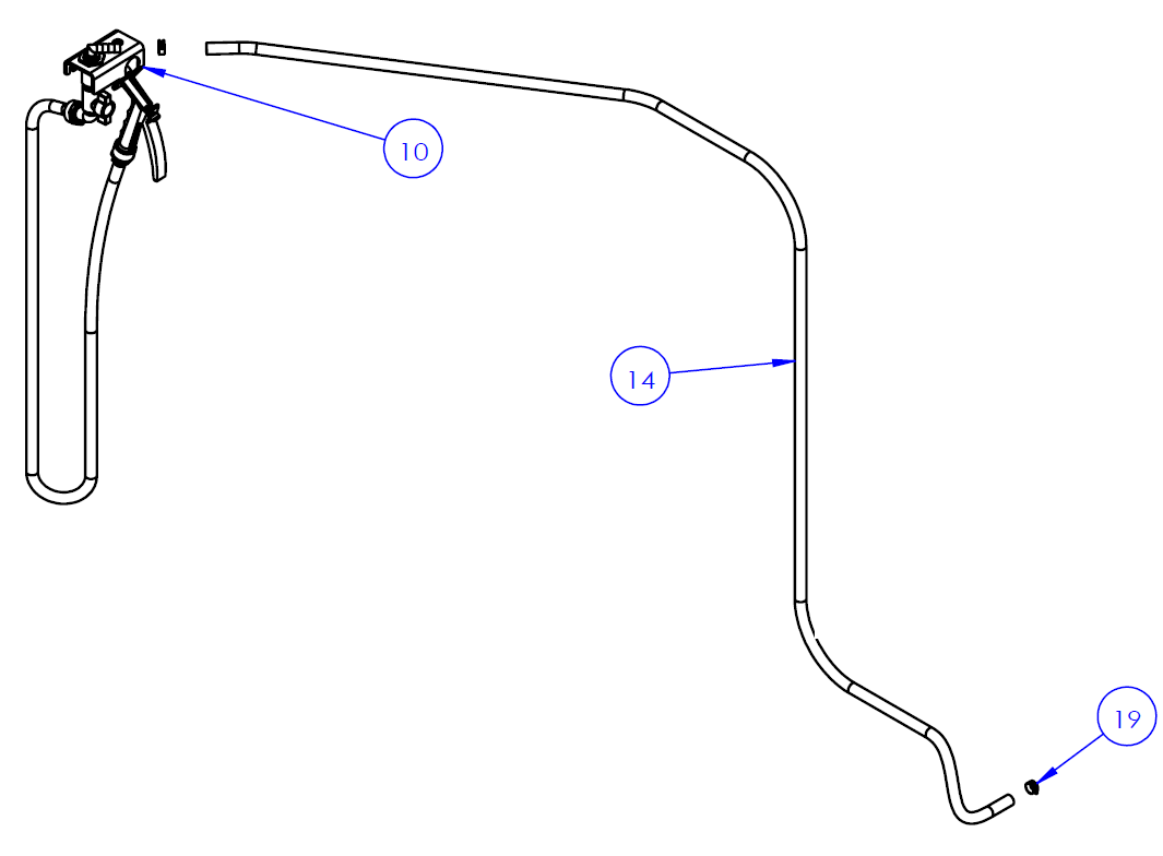

Washdown gun Kit (PN 51509)
11
Hose, 3/4 in. ID × 1 in. OD, PVC, 300 mm Long
McMaster-Carr: 5233K71
12
Hose, 3/4 in. ID × 1 in. OD, PVC, 1300 mm Long
13
Hose, 3/4 in. ID × 1 in. OD, PVC, 3700 mm Long
14
Hose, 1/2 in. ID × 5/8 in. OD, PVC, 2200 mm Long
McMaster-Carr: 9446K71
15
Hose Clamp, Spring, for 1 in. OD Hose
McMaster-Carr: 7329K16
16
Screw, Socket Head Cap, M10 × 1.5 - 20
McMaster-Carr: 91290A516
17
Y-Axis Washdown Nozzle, 1500MX (PN 51578)
18
Hose, 1/2 in. ID × 5/8 in. OD, PVC, 500 mm Long
19
Hose Clamp, Spring, for 5/8 in. OD Hose
McMaster-Carr: 7329K42
