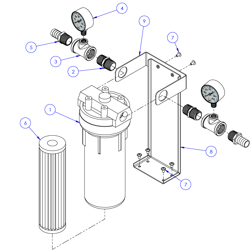

Flood Coolant Filter Housing, 3/4 in. NPT Inlets
McMaster-Carr: 4422K3
Fitting, Straight Connector, 3/4 in. NPT (Male) - 3/4 in. NPT (Male), Brass
McMaster Carr: 5485K25
Fitting, Inline Tee Reducer, 2x 3/4 in. NPT (Female) x 1/4 in. NPT (Female), Brass
McMaster-Carr: 4429K229
Fitting, Pressure Gauge, 1/4 in. NPT, 0-60 psi, for Water
McMaster-Carr: 4089K61
Fitting, Straight Adapter, 3/4 in. NPT (Male) - 3/4 in. Barb, Brass
McMaster Carr: 5346K28
Replacement Filter Cartridge, For Flood Coolant Filter
McMaster-Carr: 7191K11
McMaster-Carr: 90909A722
Bracket, Flood Coolant Filter, 1500MX (PN 51612)
Upper Bracket, Flood Coolant Filter, 1500MX (PN 52615)
