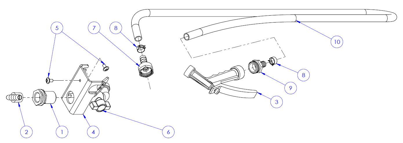

Washdown Gun Kit
Alternative Part Number
Fitting, Tank Bulkhead, 3/4 in. GHT (Male) - 1/2 in. NPT (Female) (PN 51508)
Fitting, Elbow Adapter, 1/2 in. NPT (Male) - 1/2 in. Barb
McMaster-Carr: 53525K58
Hose Nozzle, 3/4 in. GHT (PN 51513)
Hose Nozzle Bracket (PN 51621)
McMaster-Carr: 90909A727
Fitting, Hose Bibb (Quarter-Turn), 1/2 in. NPT (Male) - 3/4 in. GHT (Male)
McMaster-Carr: 4792K61
Fitting, Straight, 3/4 in. GHT (Female) - 1/2 in. Barbed, Brass
McMaster-Carr: 70705T63
Hose Clamp, Spring, for 5/8 in. OD Hose
McMaster Carr: 7329K42
Fitting, Straight, 3/4 in. GHT (Male) - 1/2 in. Barbed, Brass
McMaster-Carr: 2706N22
Hose, 1/2 in. ID × 5/8 in. OD, PVC
McMaster-Carr: 5108K62
