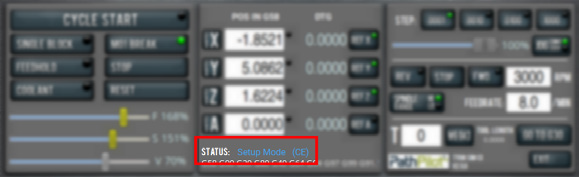

  1. If you haven't yet done so, turn the key on the top of the operator console into the setup mode position. You can identify which mode the controller is in by referencing the Statusread-only field.
Figure 1: PathPilot indicates the controller's current mode.

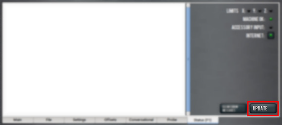

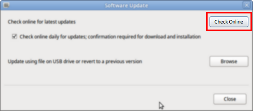

Update PathPilot
Figure 2: Update button on the Status tab.
Figure 3: Software Update dialog box.

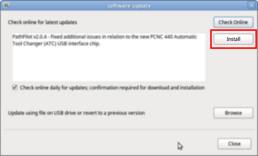

  1. Select Install.
Figure 4: Install button on the Software Update dialog box.

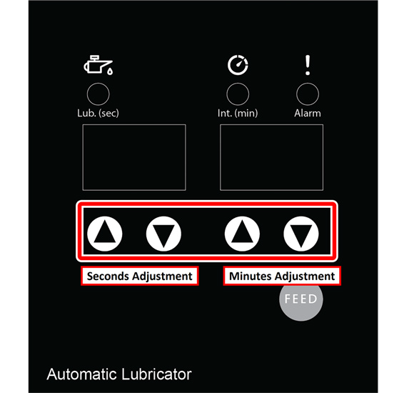

  1. Refer to "About the Automatic Oiler" for recommended interval and actuation times.
  2. On the oiler's control panel, push and hold either of the Minutes Adjustment buttons. It doesn't matter which button you push.
Figure 5: Automatic oiler control panel.
The oiler beeps.
  1. While looking at the Minutes display, do one of the following:
  • To increase the interval time, push the Up Arrow.
  • To decrease the interval time, push the Down Arrow.
NOTICE! Pressure Hazard: To avoid potential equipment damage, don't set the interval time to less than five minutes.

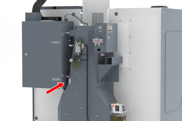

The automatic oiler is powered whenever the machine is powered on. To prevent the excess use of oil, we recommend powering off the machine at the end of day to prevent the automatic oiler from continuing to pump oil overnight.

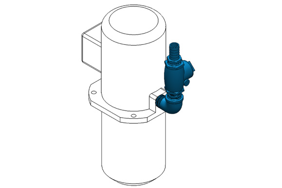

Install the Flood Coolant Pump
  1. Identify the 1/4 hp flood coolant pump (PN 51384) and the elbow fitting included in this kit. Wrap the threads of the elbow fitting with thread seal tape, and hand tighten it onto the flood coolant pump.
Figure 6: Coolant pump assembly.

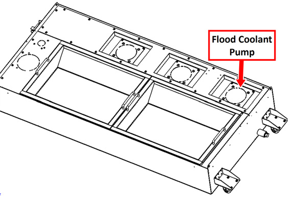

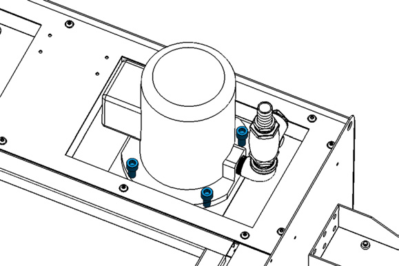

  1. On the coolant tank, identify the location for the flood coolant pump as shown in the following image. Remove the mounting plate, and knock out the center with a hammer and punch. Then, reinstall the mounting plate onto the coolant tank.
Figure 7: First mounting plate used for the flood coolant pump.
  1. Put the coolant pump into its mounting plate. Orient the pump so that the elbow fitting is nearest to the end of the coolant tank. Secure the coolant pump to the mounting plate with four M10 × 1.5 - 20 socket head cap screws (PN 32625) and an 8 mm hex wrench.
Figure 8: Flood coolant pump installed into the coolant tank.

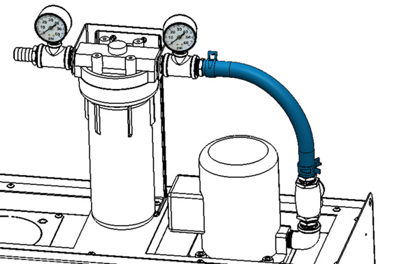

Install the Flood Coolant Filter

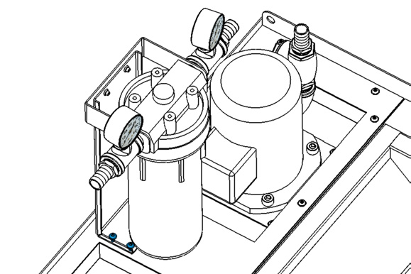

  1. Identify the flood coolant filter included with this kit. Place it next to the flood coolant pump on the coolant tank, and secure it to the rear mounting holes with four M5 × 0.8 - 10 flanged button head cap screws (PN 38205) and a 3 mm hex wrench.
Figure 9: Filter installed next to the pump.
  1. Identify the 1 ft long, 1 in. OD hose included with this kit. Install it between the barbed fittings on the outlet of the coolant pump and the inlet of the coolant filter with hose clamp springs (PN 51558) and a pair of pliers.
Figure 10: Hose installed between the filter and the pump.

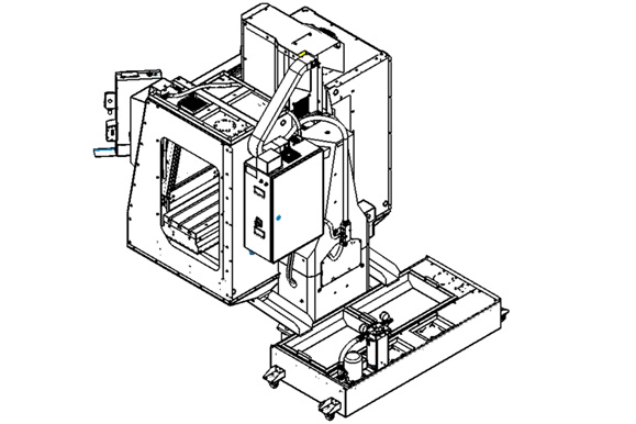

Make Coolant Connections
  1. Roll the coolant tank behind the machine and push it up to the back of the machine against the base casting. Center the tank behind the machine, making sure that the chip chutes dump into the chip baskets.
Figure 11: Coolant tank behind the machine.

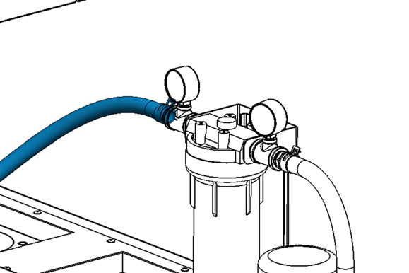

  1. Identify the 4 ft, 1 in. OD hose (PN 51608) included with this kit. Connect one end to the barbed fitting on the outlet of the coolant filter with a pair of pliers and one hose clamp (PN 51558).
Figure 12: Hose connected to the coolant filter.

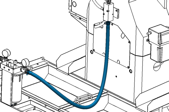

  1. Connect the loose end of the hose to the barbed fitting on the bottom of the coolant manifold with a pair of pliers and one hose clamp (PN 51558).
Figure 13: Hose connected to the coolant manifold.
