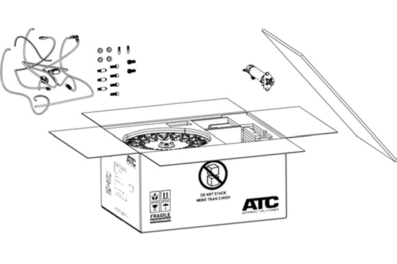

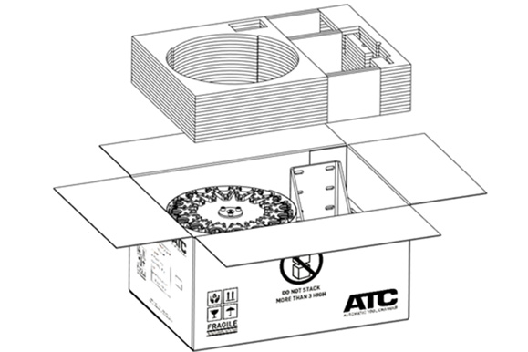

Unpack the ATC Box
  1. Open the box and remove the foam cover. From the top level of foam, remove and set aside the ATC actuator assembly (PN 51856) and the ATC accessory kit (PN 53065).
Figure 1: Removing the accessory kit and the actuator assembly from the top level of foam.
  1. Remove the top level of foam from the box and discard it.
Figure 2: Removing the top level of foam from the crate.
  1. Remove and set aside all remaining components from the box.

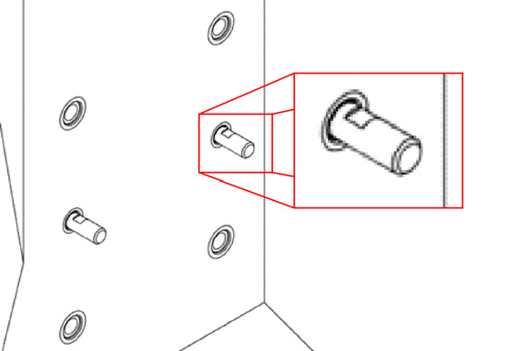

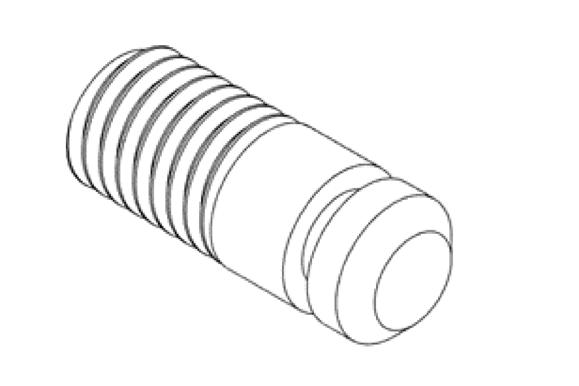

  1. Identify the accessory kit and the column mount assembly (PN 51857).

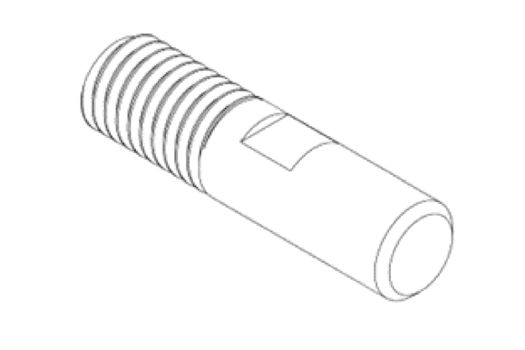

  2. From the accessory kit, remove the two 10 mm standoffs (PN 52492).
Figure 3: 10 mm standoffs pins (PN 52492).

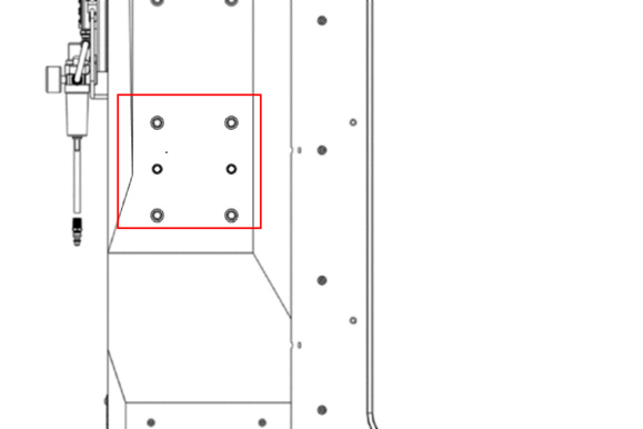

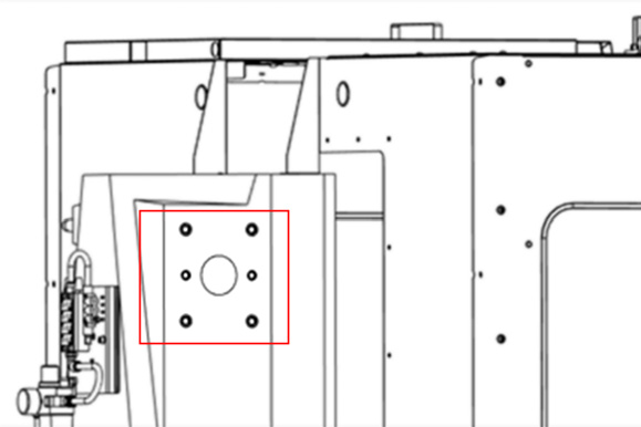

  1. On the left side of the machine's main column mounting area, identify the six threaded inserts as shown in the following image.
Figure 4: Threaded holes in the machine column.

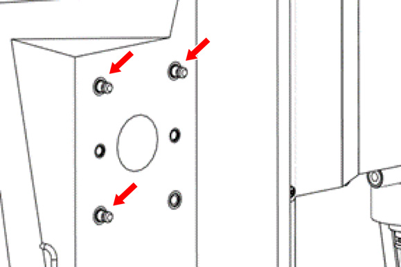

  1. Thread both 10 mm standoffs into the two center threaded holes as shown in the following image. Thread in the standoffs until the flats on the standoffs are flush to the column.
Figure 5: 10 mm slide pins threaded into the machine column.

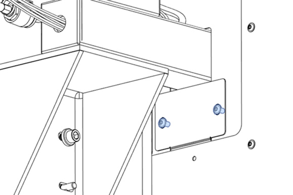

  1. If the machine's enclosure is already installed, remove the 12 M6 × 12 flanged button head screws securing the ATC panel to the enclosure with a 4 mm hex wrench. Set the screws aside.
Figure 6: ATC panel on the machine's enclosure.

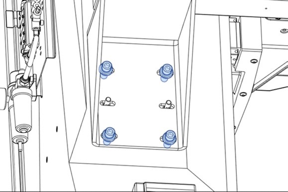

  1. From the accessory kit, remove four M12 washers (PN 52288) and four M12 × 30 mm screws (PN 52448).
  2. Secure the ATC column mount assembly to the column by screwing four M12 × 30 mm screws and four M12 washers into the remaining threaded inserts, tightening them with a 10 mm hex wrench (not included in the accessory kit). Realign the column mount if necessary and, once it's fully aligned, completely tighten the four screws.
Figure 8: M12 screws and washers fastened onto the column mount assembly.

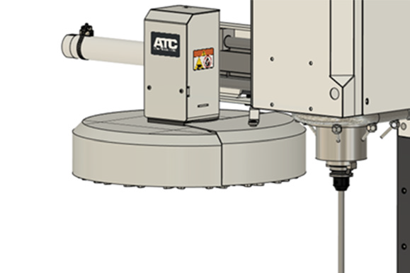

Assemble the ATC
  1. From the accessory kit, remove two M14 × 25 socket head cap screws (PN 53055) and the 12 mm hex wrench.

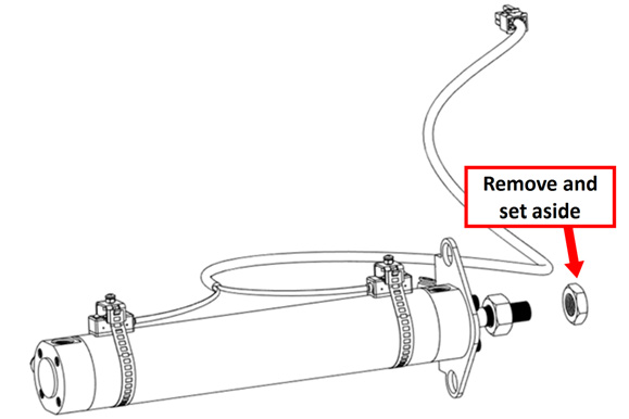

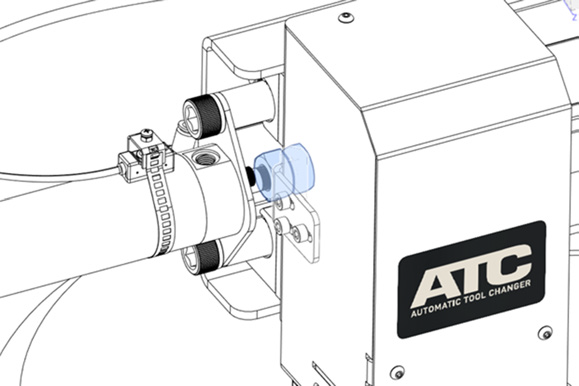

  2. Identify the ATC actuator assembly that you set aside earlier. Unscrew the thin nut from its piston rod, and set the nut aside.
Figure 9: Nut removed from the piston rod.

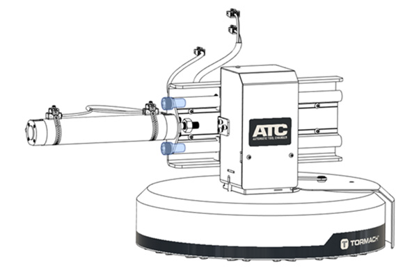

  1. Install the ATC actuator assembly on the left side of the ATC slide assembly with two M14 × 25 socket head cap screws and a 12 mm hex wrench.
Figure 10: Actuator assembly installed onto the ATC's slide assembly.
  1. Slide the motor box toward the piston until the motor box bracket fits into the piston rod. Secure the motor box to the piston rod using the thin nut that you set aside in Step 2. Tighten the lock nuts finger-tight for now.
Figure 11: Securing the motor box to the piston rod.

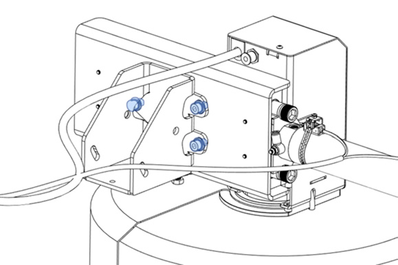

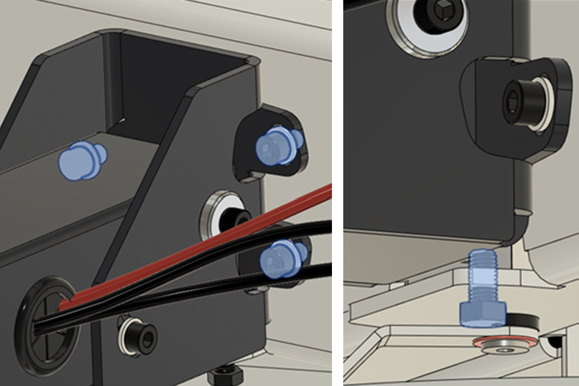

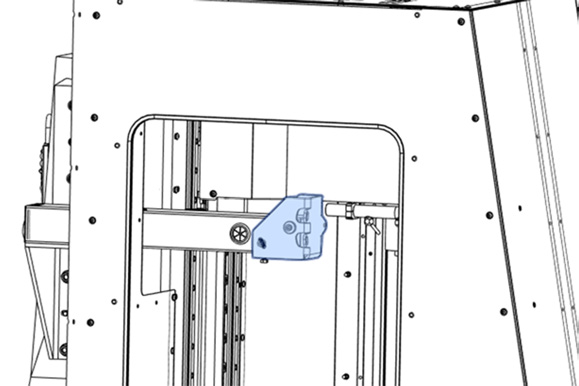

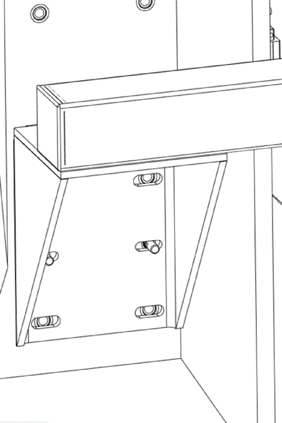

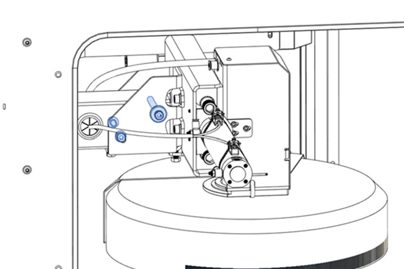

  1. Identify the ATC tilt bracket on the column mount assembly. Remove the bracket from the assembly by removing the M8 × 100 and M8 × 12 socket head cap screws and their washers with a 6 mm hex wrench. Set aside the fasteners.
Figure 12: ATC tilt bracket on the column mount.
  1. From the accessory box, remove three M8 × 1.25 - 12 screws (PN 50578) and three flat washers (PN 30531). Attach the tilt bracket to the ATC's slide plate with the three screws, three washers, and a 6 mm hex wrench. Loosen the M8 hex head screw at the bottom of the ATC tilt bracket if necessary.
Figure 13: ATC tilt bracket installed on the slide plate.

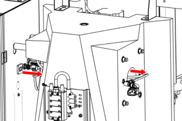

  1. On the left side of the machine's main column mounting area, identify the upper arrangement of threaded inserts as shown in the following image.
Figure 16: Threaded holes for the ATC electrical cabinet.
  1. Thread the three M12 × 15 mm standoffs into the threaded holes as shown in the following image.
Figure 17: Installing the standoffs in the threaded holes.

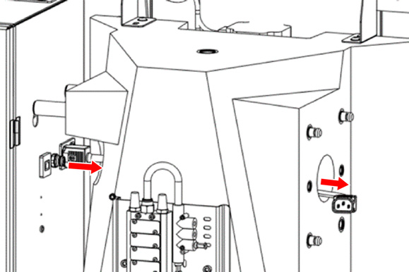

  1. Connect the black IEC cable (PN 51969) to the ATC Power connector on the right side of the machine's electrical cabinet. Bring the cable through the column as shown in the following image.
Figure 18: Connecting the black IEC cable to the machine's electrical cabinet.
  1. Connect the EtherCAT cable (PN 51970) to the ATC Communication connector on the right side of the machine's electrical cabinet. Bring the cable through the column as shown in the following image.
Figure 19: Connecting the EtherCAT cable to the machine's electrical cabinet.
  1. Connect the ATC STO cable (PN 51965) to the ATC STO connector on the right side of the machine's electrical cabinet. Bring the cable through the column as shown in the following image.
Figure 20: Connecting the ATC STO cable to the machine's electrical cabinet.

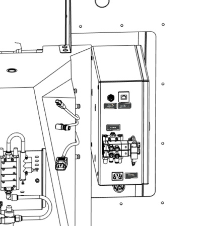

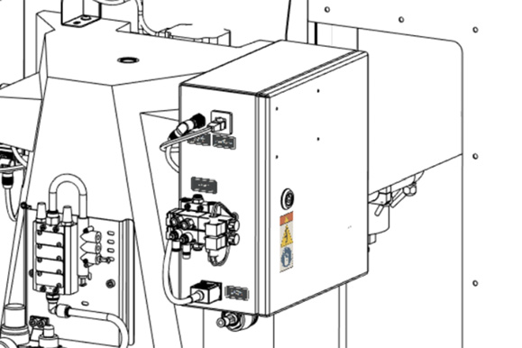

  1. Identify the ATC electrical cabinet (PN 51949). Align its three keyhole slots on the back with the three standoffs previously installed on the machine's column. Once the standoffs fit into the cabinet's slots, let the weight of the cabinet guide the standoffs into the narrow part of the slot. Adjust the cables so that they don’t get pinched.
Figure 21: Installing the ATC's electrical cabinet onto the standoffs.
  1. Connect the loose ends of the IEC cable, the EtherCAT cable, and the ATC STO cable to the ATC Power, ATC Communication, and ATC STO connectors on the outer left side of the ATC's electrical cabinet.
Figure 22: Connecting the IEC, EtherCAT, and ATC STO cables to the ATC's electrical cabinet.

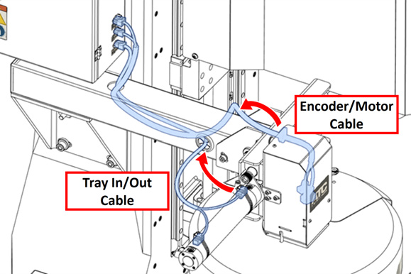

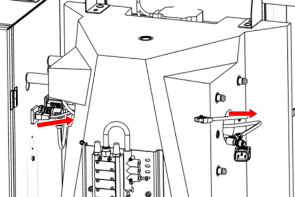

  1. Identify the loose end of the encoder/motor power cable and the tray in/out cable that are pre-installed on the ATC. Route the loose ends of the cables as follows:
    1. Route the encoder/motor power cable (PN 51967) through the grommet on the right side of the ATC column mount and out through the upper hole on the arm.
    2. Route the tray in/out cable (PN 51966) through the grommet on the left side of the ATC column mount and out through the upper hole on the arm.
Figure 23: Cable routing from the ATC to the electrical cabinet.
c. Connect the loose ends of the cables to the ATC Tray Position Sensor, ATC Motor Encoder, and ATC Motor Power connectors on the outer right side of the ATC's electrical cabinet.

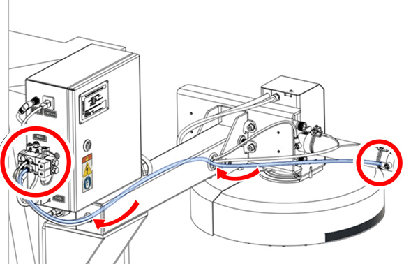

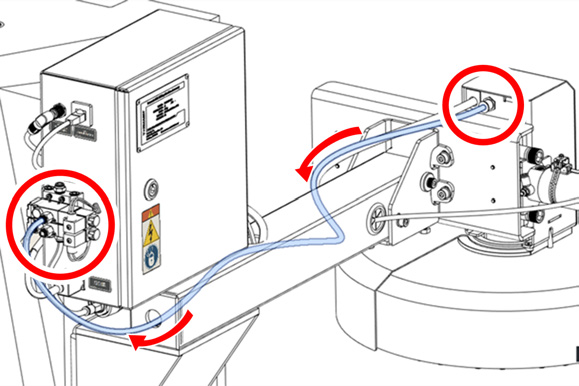

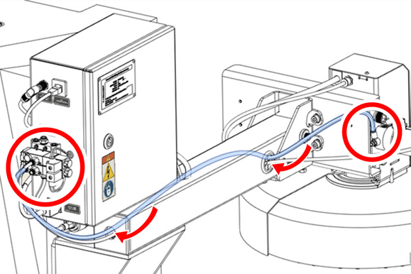

  1. Identify the air line labeled Blaster. Connect one end of the air line to the rear of the ATC's motor box. Route the loose end as follows:
    1. Route the air line through the grommet on the right side of the ATC column mount and out through the plug in the rear hole on the arm.
    2. Connect the loose end of the air line to the right port of the upper solenoid valve on the ATC's electrical cabinet.
Figure 24: Blaster air line connections.
  1. Identify the air line labeled Tray In. Connect one end of the air line to the fitting on the ATC actuator assembly that's closest to the motor box. Route the loose end as follows:
    1. Route the air line through the grommet on the left side of the ATC column mount and out through the plug in the rear hole on the arm.
    2. Connect the loose end of the air line to the left port of the lower solenoid valve on the ATC's electrical cabinet.
Figure 25: Tray In air line connections.
  1. Identify the air line labeled Tray Out. Connect one end of the air line to the fitting on the ATC actuator assembly that's furthest from the motor box. Route the loose end as follows:
    2. Connect the loose end of the air line to the right port of the lower solenoid valve on the ATC's electrical cabinet.
Figure 26: Tray Out air line connections.

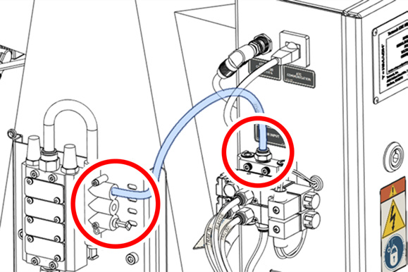

  1. Identify the air line labeled Air Input. Connect one end of the air line to the upper (main) fitting of the ATC's pneumatic distributor, and connect the loose end to the upper port of the machine's pneumatic distributor.
Figure 27: Air In air line connections.

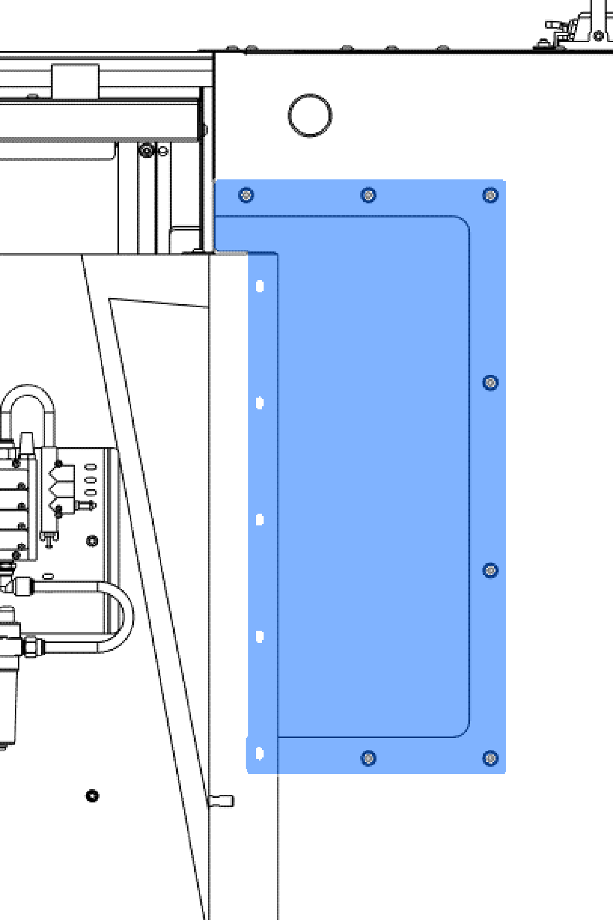

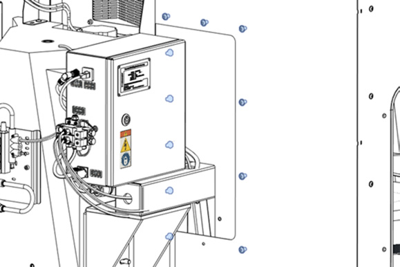

  1. Depending on your machine configuration, do one of the following:
  • Enclosure Installation Completed:
a. Fasten the ATC mount cover panel (PN 52374) to the left rear panel using 12 M6 × 1.0 - 12 screws.
Figure 28: ATC mount cover panel installed onto the left rear panel.
b. Identify the mount gap plate (PN 52450). Install it from the outside of the left rear panel using two M6 × 12 flanged button head screws.
Figure 29: Mount gap plate installed onto the left rear panel.

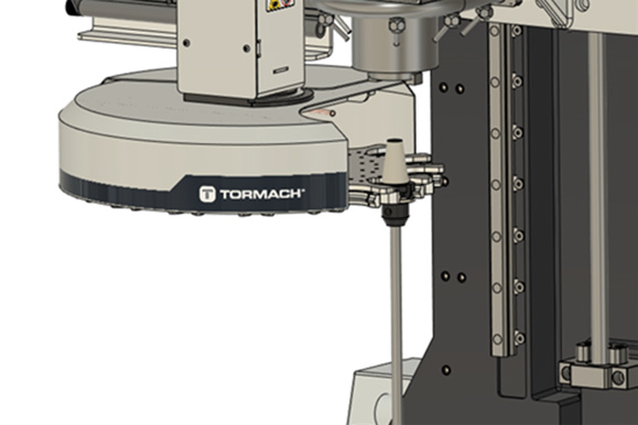

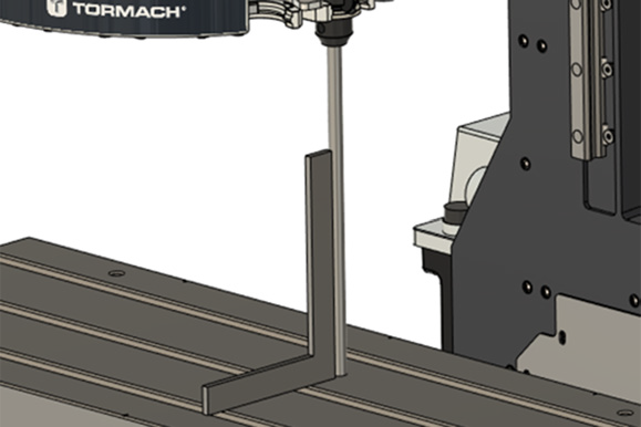

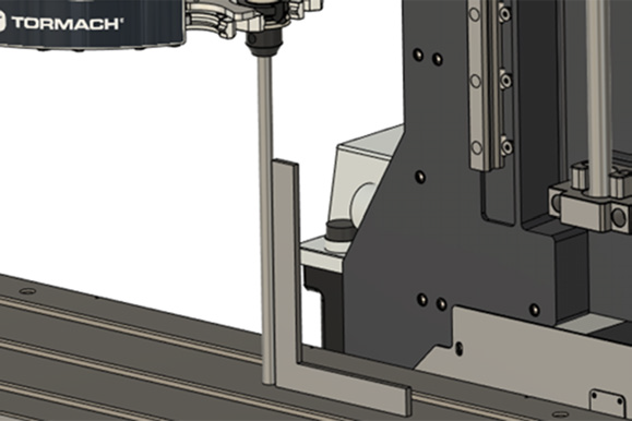

  1. Disconnect the air from the machine, and manually move the ATC to its tool change position (if the spindle interferes, power on the machine and jog the spindle to its highest position, and then power off the machine). Mount a tool holder with a 1/2 in. rod in the slot of the tool tray closest to the spindle, as shown below.
Figure 30: Tool holder with a 1/2 in. rod mounted in the tool tray.
  1. Put the precision square on the machine table so that it's standing on its short end and aligned along the Y-axis (perpendicular to the table slots).
Figure 31: Precision square aligned along the Y-axis.
  1. Adjust the tilt of the ATC along the X-axis:
    1. Slightly loosen the three M8 screws on the mounting assembly and turn the bottom jack screw with a wrench.
Figure 32: Screws used to adjust the tilt of the ATC along the X-axis.
b. Repeat Step A until the rod is perfectly parallel with the precision square.
c. Retighten the three M8 screws, adjusting with a ratchet torque wrench with a 6 mm hex tip.
  1. Turn the precision square so that it's aligned along the X-axis (parallel to the table slots).
Figure 33: Precision square aligned along the X-axis.
  1. Adjust the tilt of the ATC along the Y-axis:
    1. Slightly loosen the three M8 screws that connect the tilt bracket and the side plate, and turn the lower jack screw with a wrench.
Figure 34: Screws used to adjust the tilt of the ATC along the Y-axis.

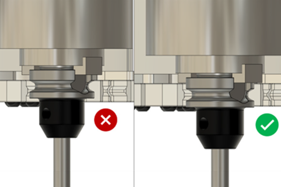

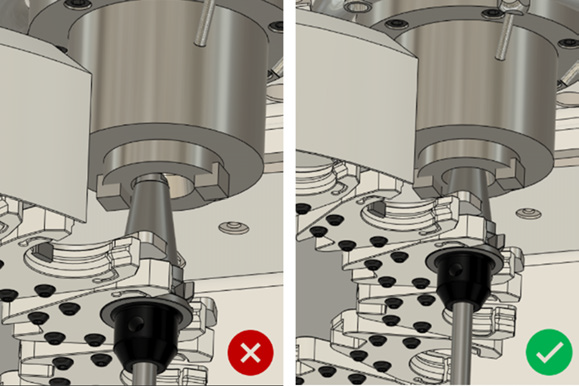

  4. Manually move the ATC to its tool change position (with the piston fully extended), and slowly jog the spindle over the tool holder. Stop jogging just before contacting the tool holder. If the tool tray is offset, press the Emergency Stop button, and manually rotate the tool tray until it's aligned.

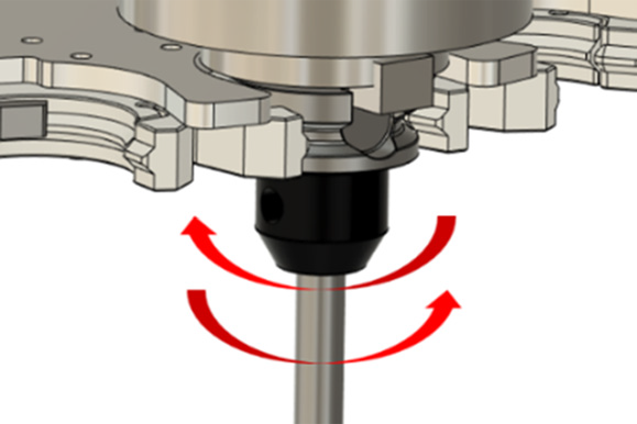

  5. Verify the X alignment of the ATC. Depending on the deviation in the tool on the X-axis with respect to the spindle center, move the M14 fine thread piston rod nuts surrounding the connection bracket of the motor box with your fingers, and move the ATC until the tool holder is perfectly aligned with the spindle in the tool change position (with the piston fully extended). Tighten both nuts with your fingers.
Figure 35: Examples of X alignment.

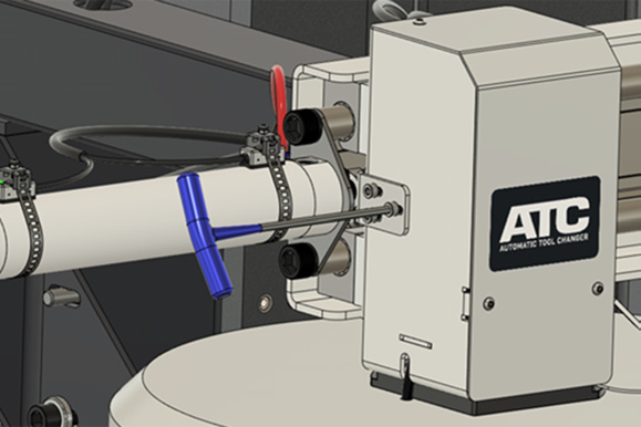

  1. Jog the spindle up, manually move the ATC to an intermediate position, and tighten the two M14 fine thread nuts of the actuator stem between them as locknuts, with a wrench (holding the nut closest to the piston) and a ratchet with a 22 mm or 7/8 in. socket mounted on it with an extension (turning and tightening the nut furthest from the piston) as shown below.
Figure 36: Adjusting the nuts on the actuator stem.
  1. Manually move the ATC in and out from end-to-end on the actuator rod travel, and ensure that both the actuator sensors light up at the travel limits. If the sensors don't light up, adjust the position of the sensor by loosening the clamp screw, adjusting, and then retightening with a Phillips screwdriver.
Figure 37: Adjusting the clamp screws.

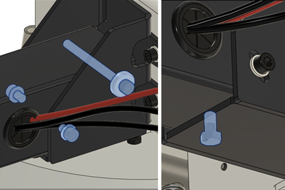

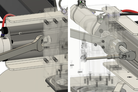

  1. If moving the ATC outward manually feels forced, the motor box bracket may be flexing the piston rod. Bring the ATC to its retracted position, and loosen the three M5 × 10 socket screws that hold the bracket to the motor box. When the bracket has settled on its own, retighten the screws. If the ATC movement feels smooth, go to the next step.
Figure 38: Adjusting the screws on the motor box bracket.

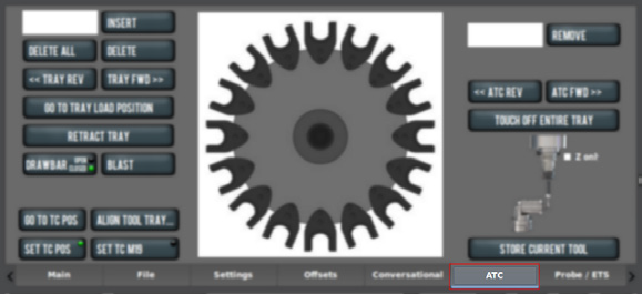

  4. Verify that, in the PathPilot interface, the ATC tab displays.
Figure 39: ATC tab in PathPilot.

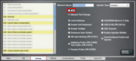

  1. If the tab doesn't display, verify that the machine is in setup mode. Use the key on the top of the operator console to switch between modes.
  2. From the Settings tab, select the ATC radio button.

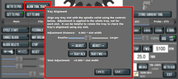

  1. Jog the spindle down and manually bring the ATC closer to its tool change position, without directly contacting the tool holder to the tray. From the PathPilot interface, on the ATC tab, select Align Tool Tray.
Figure 42: Tray Alignment dialog box.

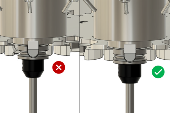

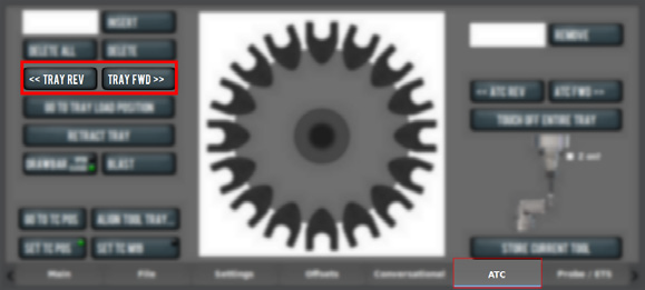

  1. In the Tray Alignment dialog box, use the controls to rotate the tool tray until the tool holder is perfectly aligned vertically with the spindle. Once finished, select Save.
NOTE: If the machine isn't in setup mode, the controls in the Tray Alignment dialog box won't work. Use the key on the top of the operator console to switch between modes.
Figure 43: Examples of tool holder alignment vertically within the tool slots.
  1. Jog the spindle up or down so that the tool holder slot is horizontally aligned within the tool tray slot. Verify this by manually moving the ATC, ensuring that the tool tray's slot contacts the tool holder in the spindle, as if you were going to make a tool change. If the movement feels strained, or if you notice the tool tray flexing up or down while doing this, manually remove the ATC from the tool holder, and readjust the height of the spindle by jogging the Z-axis.
Figure 44: Examples of tool holder alignment horizontally within the tool slots.

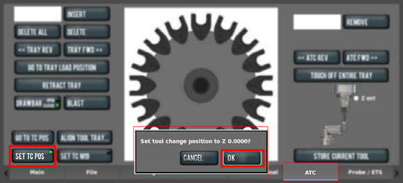

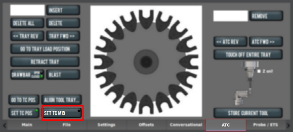

  1. From the PathPilot interface, on the ATC tab, select Set TC POS, and then select OK.
    The height at which the spindle makes tool changes is saved.
Figure 45: Set TC POS button on the ATC tab.

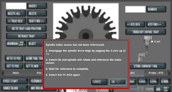

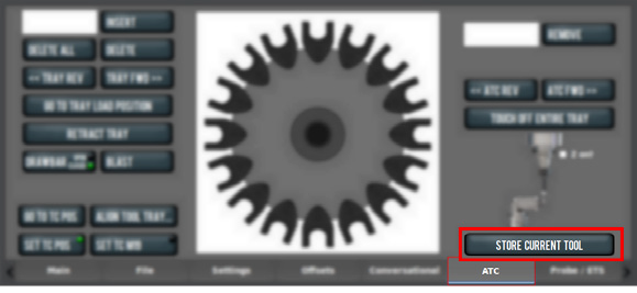

  1. Manually move the ATC to its retracted position. From the PathPilot interface, on the ATC tab, select Set TC M19.
  1. If the spindle hasn't previously been referenced, a dialog box displays with instructions to reference the spindle index sensor. Select OK, and wait for the spindle to rotate a few times to adjust the encoder.
Figure 46: Spindle index sensor dialog box.

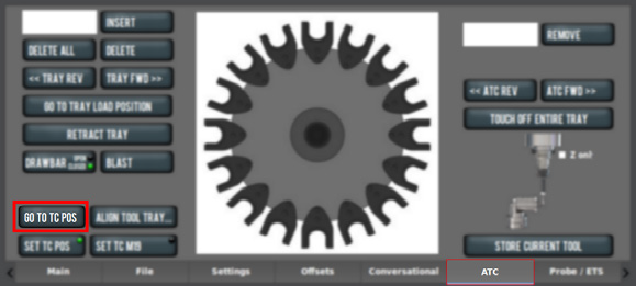

  1. From the PathPilot interface, on the ATC tab, select Go to TC POS
    The spindle lowers to its tool change position.
Figure 47: Go to TC POS button on the ATC tab.

  1. Load an empty tool holder into the spindle. From the PathPilot interface, in the Tool DRO field, assign a tool number (for example, 1). Then, press Enter on the keyboard.
  2. From the ATC tab, select Tray Rev or Tray Fwd to rotate the tool tray to an empty slot.
Figure 49: Tray rotation buttons on the ATC tab.
  1. Select Store Current Tool.
Figure 50: Store Current Tool button on the ATC tab.
The spindle lowers, and the ATC moves to store the tool in the assigned holder.
If the tool didn't store smoothly, or if there was any sound or collision, disconnect the air from the machine and locate the exact point and reason for the collision, and verify the adjustment and alignment of the critical points mentioned earlier in this procedure.
  1. From the PathPilot interface, in the Tool DRO field, type the tool number that you previously assigned (in our example, 1). Then, press Enter on the keyboard. In the dialog box that displays, select Yes.
    The ATC moves, and the spindle lowers to grab the selected tool.
    If the tool wasn't gripped smoothly, or if there was any sound or collision, disconnect the air from the machine and locate the exact point and reason for the collision, and check the adjustment and alignment of the critical points mentioned earlier in this procedure.
  2. Repeat the steps in this section, adding more tools and making more changes between them, to completely verify the operation of the ATC.
