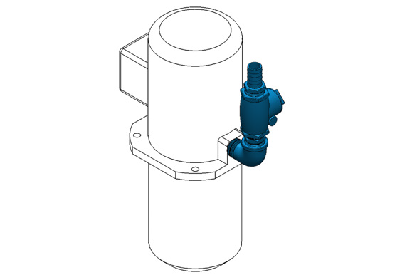

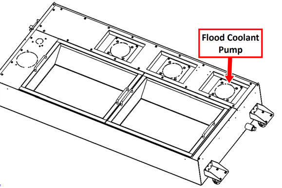

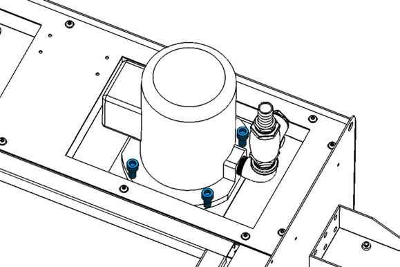

Install the Flood Coolant Pump
  1. Identify the 1/4 hp flood coolant pump (PN 51384) and the elbow fitting included in this kit. Wrap the threads of the elbow fitting with thread seal tape, and hand tighten it onto the flood coolant pump.
  1. On the coolant tank, identify the location for the flood coolant pump as shown in the following image. Remove the mounting plate, and knock out the center with a hammer and punch. Then, reinstall the mounting plate onto the coolant tank.
Figure 2: First mounting plate used for the flood coolant pump.
  1. Put the coolant pump into its mounting plate. Orient the pump so that the elbow fitting is nearest to the end of the coolant tank. Secure the coolant pump to the mounting plate with four M10 × 1.5 - 20 socket head cap screws (PN 32625) and an 8 mm hex wrench.
Figure 3: Flood coolant pump installed into the coolant tank.

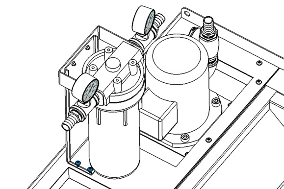

Install the Flood Coolant Filter
  1. Identify the flood coolant filter included with this kit. Place it next to the flood coolant pump on the coolant tank, and secure it to the rear mounting holes with four M5 × 0.8 - 10 flanged button head cap screws (PN 38205) and a 3 mm hex wrench.
Figure 4: Filter installed next to the pump.

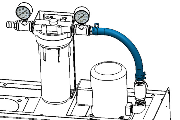

  1. Identify the 1 ft long, 1 in. OD hose included with this kit. Install it between the barbed fittings on the outlet of the coolant pump and the inlet of the coolant filter with hose clamp springs (PN 51558) and a pair of pliers.
Figure 5: Hose installed between the filter and the pump.

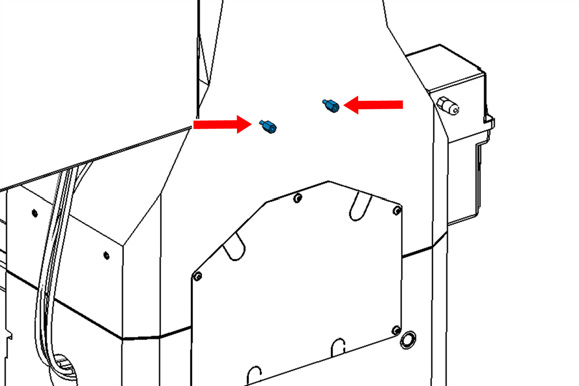

Install the Coolant Manifold
  1. On the back of the machine column, identify the bottom set of M6 threaded inserts. Identify two standoffs (PN 51566) included with this kit. Then, install and tighten them into the back of the machine column with a 13 mm wrench.
Figure 6: Two standoffs installed on the back of the machine column.

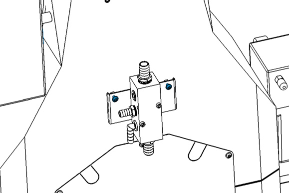

  1. Identify the coolant manifold assembly (PN 51565) and two M6 × 1 - 10 flanged button head cap screws (PN 51616) included with this kit. Secure the manifold to the standoffs with a 4 mm hex wrench. Make sure that the manifold is oriented with the mounting screws toward the top of the machine.
Figure 7: Coolant mainfold assembly installed onto the standoffs.

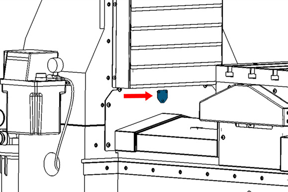

Install the Y-Axis Washdown Nozzle

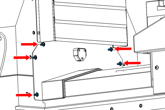

  1. On the front of the machine, identify the Y-axis rear way cover. Remove and set aside the six M6 screws securing the Y-axis rear way cover to the column with a 4 mm hex wrench. Slide the cover toward the table to gain access to the back of the cover.
Figure 8: Screws securing the Y-axis rear way cover to the column.
  1. Remove the three M4 screws that secure the cover plate onto the way cover with a 2.5 mm hex wrench. Discard the screws and the cover plate.
Figure 9: Y-axis washdown cover plate.

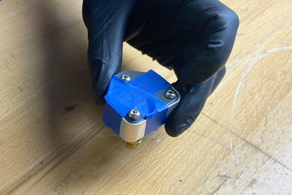

  1. Identify the Y-axis washdown block that's included in this kit.
IMPORTANT! The Y-axis washdown block contains 3 very small O-rings. Pay attention and use care when handling to prevent dropping or losing the O-rings. We recommend taping the assembly together to prevent the cover plate from falling off while you're installing the block onto the machine.
  1. Tape the washdown block assembly together. Then, remove the three hex nuts from the back of the washdown block with a 2.5 mm hex wrench and a 7 mm wrench. Do not remove the screws from the block because these help hold the O-rings in place. The nuts are for shipping purposes and can be discarded.
Figure 10: Y-axis washdown block assembly temporarily taped together.

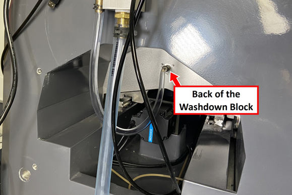

  2. On the back of the machine, identify the rear access panel. Remove the five M6 screws from the panel and set the screws aside.
Figure 12: Rear access panel on the back of the machine.

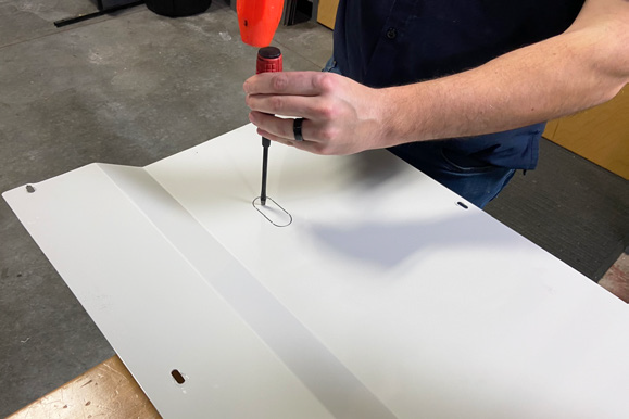

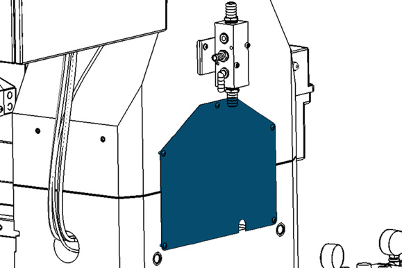

  1. Knock out the upper left knock-out on the access panel with a hammer and punch.

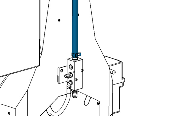

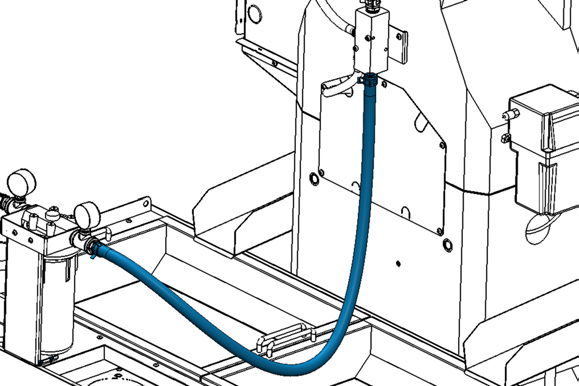

  2. Identify the 20 in. long, 5/8 in. OD hose (PN 51516) included in this kit. From the back of the machine, install the hose to the 1/2 in. barbed hose fitting on the back of the washdown block with one hose clamp (PN 51679) and a pair of pliers.
Figure 13: Hose installed on the washdown block.
  1. Route the loose end of the hose through the knock-out in the access panel, and re-install the access panel onto the back of the machine with the five M6 screws that you set aside earlier.

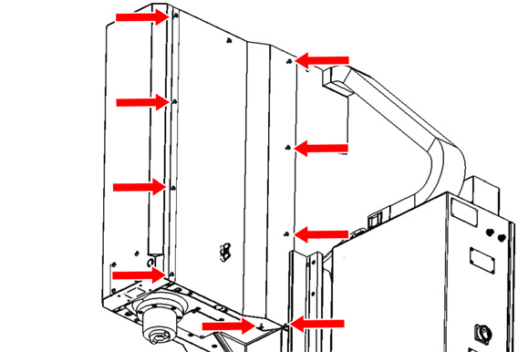

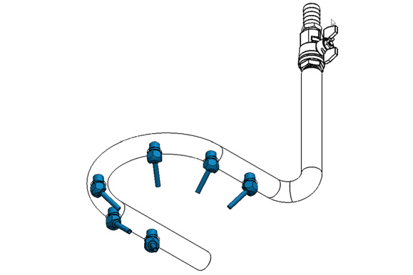

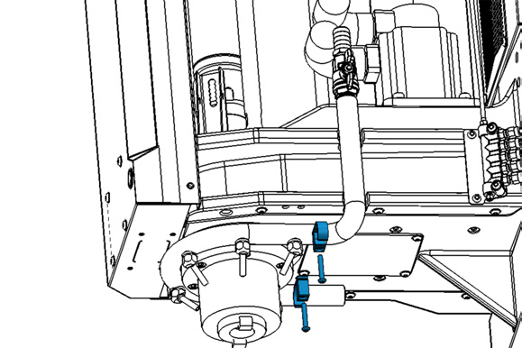

Install the Flood Coolant Ring
  1. On the front of the machine, remove the nine M6 flanged button head cap screws on the side of the right side spindle cover with a 4 mm hex wrench. Set the screws aside. Then, loosen or remove the three screws on the bottom of the spindle head cover. Remove the cover, and set it aside.
Figure 15: Screws securing the right side spindle cover.
  1. Identify the four swiveling coolant nozzles (PN 38348) and the coolant ring that are included in the kit. Install each nozzle into the coolant ring with a 17 mm wrench. Tighten the nozzles until they're pointed toward the center of the ring.
Figure 16: Coolant ring assembly.

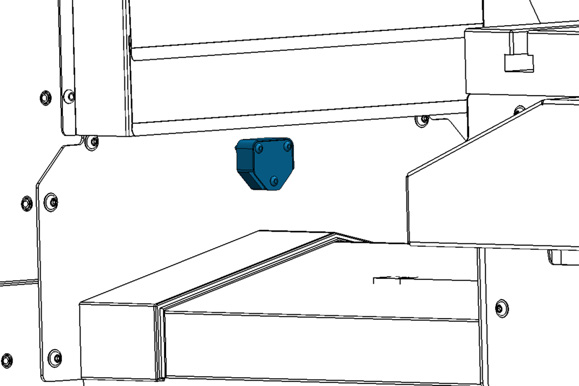

  1. Identify the two coolant ring mounts (PN 51249) included in this kit. Place one coolant ring mount on the right side of the coolant ring (the side opposite of the barbed fitting), and loosely install the coolant ring mount on the right side of the spindle with a 4 mm hex wrench.
Figure 17: Coolant ring mount.
  1. Slide the remaining coolant ring mount under the left side of the coolant ring. Then, tighten both screws with a 4 mm hex wrench.
Figure 18: Coolant ring mounted to t he bottom of the spindle head casting.

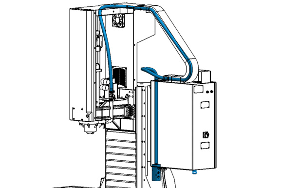

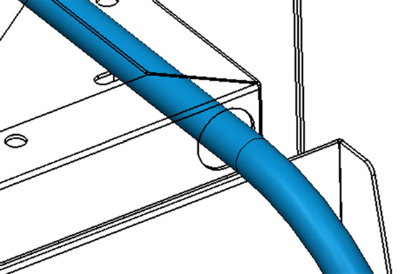

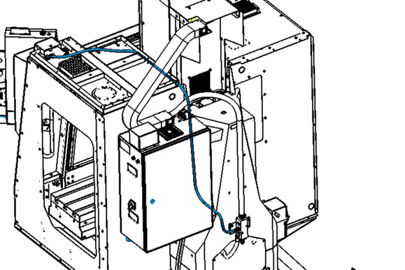

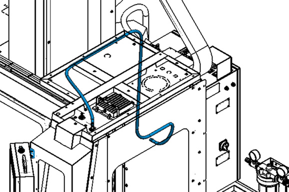

  1. Route the loose end of the hose toward the top of the electrical cabinet. Starting at the electrical cabinet, feed the hose through the energy chain toward the back side of the spindle head cover.
Figure 20: Hose routing to the electrical cabinet.
Tip! It may be helpful to have the Z-axis raised to its maximum height, and you may need to remove several of the energy chain covers with a flat-blade screwdriver (or similar) to help route the hose through the energy chain.
  1. Route the hose through the opening at the top left side of the spindle head cover.

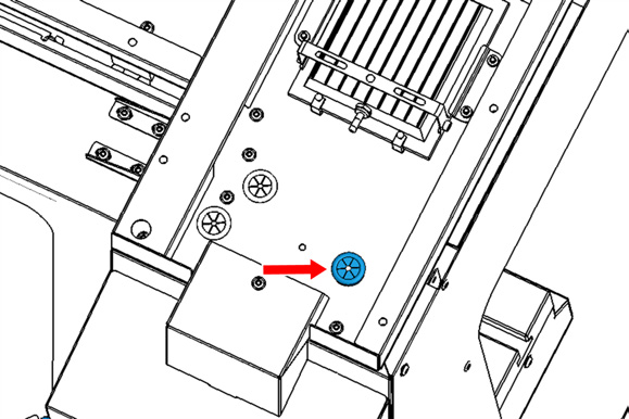

  1. On the top right panel of the enclosure, identify the hole for the washdown bulkhead fitting. Remove the plastic grommet.
Figure 23: Grommet over the washdown bulkhead fitting hole.

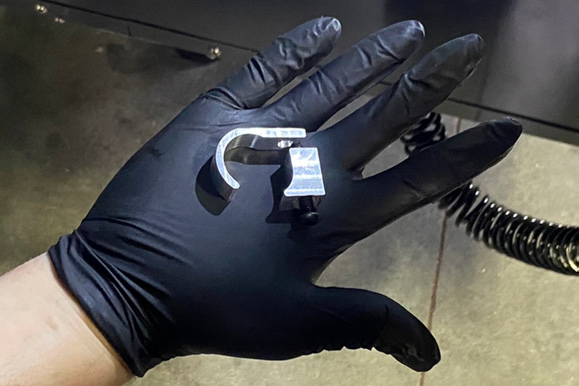

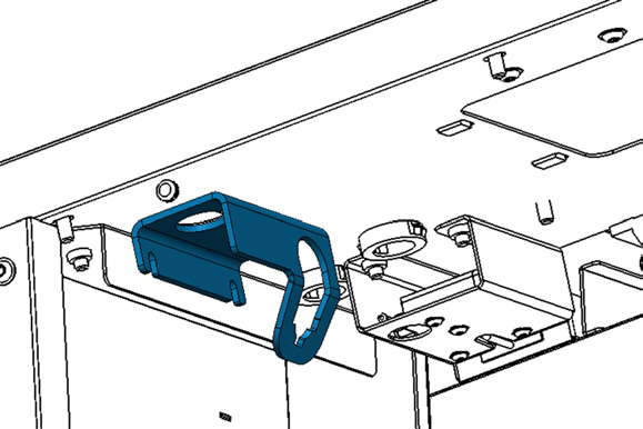

  1. Identify the hose nozzle bracket (PN 51621) and one M6 × 1 - 12 flanged button head cap screw (PN 38206) included in this kit. Mount the bracket to the underside of the top right enclosure panel with a 4 mm hex wrench. Make sure to align the large hole in the bracket with the hole in the top right enclosure panel.
Figure 24: Hose nozzle bracket mounted to the top right enclosure panel.

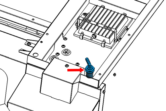

  1. Identify the bulkhead fitting included in this kit. Remove the locking nut from the bulkhead fitting, and install the fitting into the hole in the top of the enclosure panel with the elbow fitting on top of the enclosure. Turn the elbow fitting so that it's pointing at a 45 degree angle toward the spindle and the back of the machine. Then, re-install and tighten the locking nut onto the bulkhead fitting with a 30 mm wrench.
Figure 25: Fitting installed into the hole on the top of the enclosure panel.

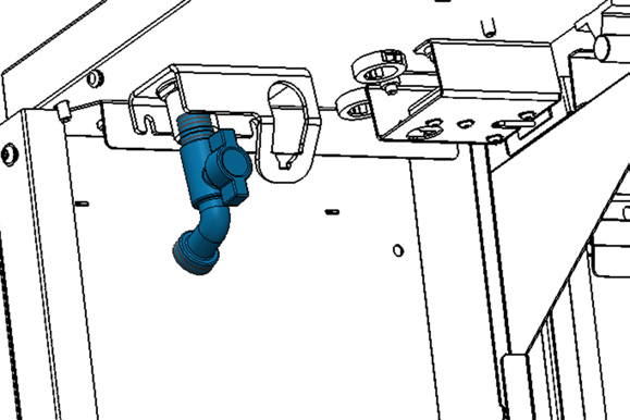

  1. Identify the hose bibb fitting included in this kit. Apply thread sealant tape to its threads. Then, tighten the hose bibb into the bulkhead fitting with a 32 mm wrench on top of the enclosure and an 8 mm hex wrench inserted into the end of the hose bibb. Tighten until the outlet of the hose bibb is pointing toward the front of the enclosure.
Figure 26: Bibb fitting installed into the bulkhead fitting.

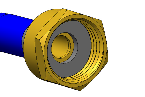

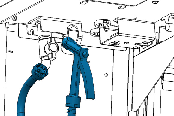

  1. Identify the hose and manual sprayer assembly that's included in this kit. Verify that the rubber seal is installed in the fitting on the loose end of the hose.
Figure 27: Rubber seal in the hose.
  1. Connect the hose to the outlet of the hose bibb, and hang the manual sprayer in the loop of the bracket.
Figure 28: Hose connected to the bibb fitting.

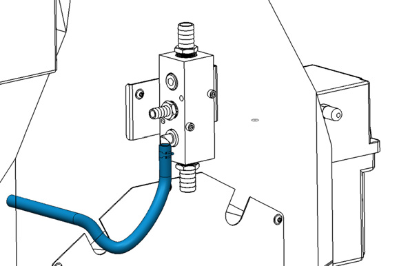

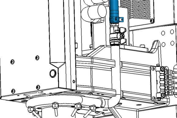

  1. Identify the 7 ft, 5/8 in. OD hose (PN 51516) included in this kit. Connect one end to the straight 1/2 in. barbed hose fitting on the side of the coolant manifold at the back of the machine with a pair of pliers and a hose clamp.
Figure 29: Hose connected to the coolant manifold.

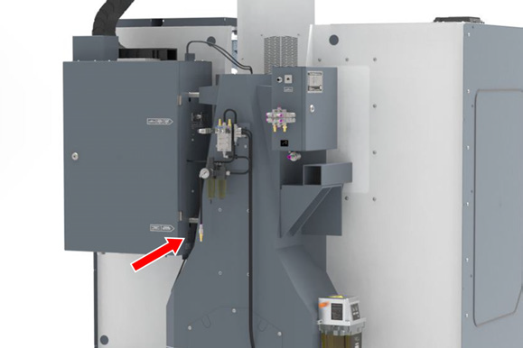

  1. Route the loose end of the hose as follows:
    1. From the coolant manifold, route hose in between the electrical cabinet and the column casting and then back toward the enclosure.
Figure 30: Hose routing to the front of the electrical cabinet.
b. Then, route it up toward the top of the enclosure, and through the hole near the spindle head (on the back of the top right enclosure panel).

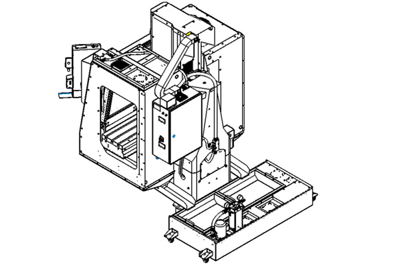

  1. Roll the coolant tank behind the machine and push it up to the back of the machine against the base casting. Center the tank behind the machine, making sure that the chip chutes dump into the chip baskets.
Figure 34: Coolant tank behind the machine.

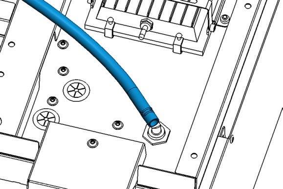

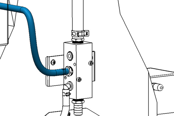

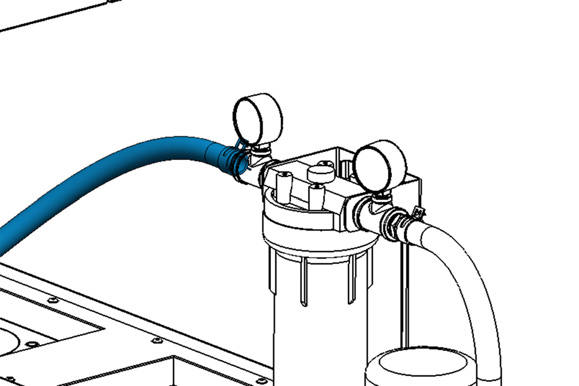

  1. Identify the 4 ft, 1 in. OD hose (PN 51608) included with this kit. Connect one end to the barbed fitting on the outlet of the coolant filter with a pair of pliers and one hose clamp (PN 51558).
Figure 35: Hose connected to the coolant filter.
  1. Connect the loose end of the hose to the barbed fitting on the bottom of the coolant manifold with a pair of pliers and one hose clamp (PN 51558).
Figure 36: Hose connected to the coolant manifold.
