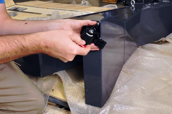

  2. Identify the two casters and eight M6 × 1 - 12 button head cap screws included with this kit.
  3. With the chip conveyor still on the pallet and laying on its side, install the two casters onto the end of the chip conveyor with a 5 mm hex wrench.

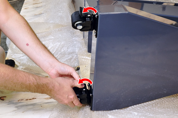

  1. Lock the casters to prevent the wheels from spinning while lifting the chip conveyor from the pallet.
Figure 3: Locking the caster.

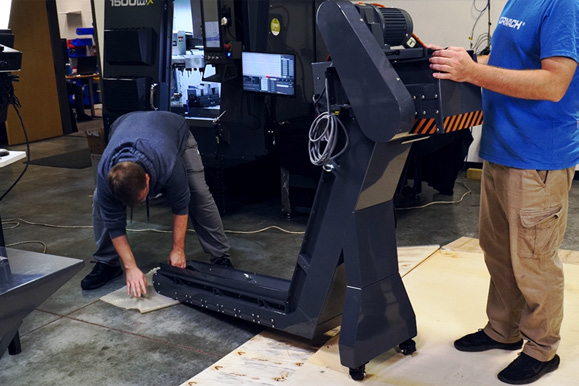

WARNING! Tip Hazard: Use at least two people to lift the machine into an upright position. You must use proper lifting techniques and keep the machine stable throughout the process. Failure to do so could result in serious injury or equipment damage.
  1. Slide the chip conveyor to the edge of the pallet. With the help of an assistant, slowly lift the chip conveyor upright, and lower it onto the ground.
Figure 4: Moving the chip conveyor off of the pallet.
  1. Discard the pallet and any remaining packaging.

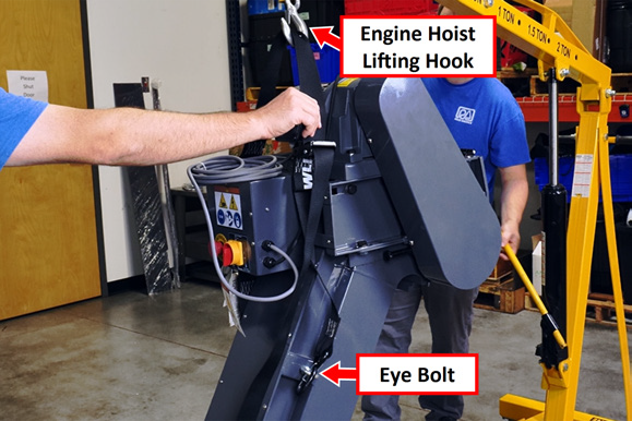

We recommend using an engine hoist and lifting straps rated for at least 1,000 lb (454 kg) to safely lift and position the chip conveyor into the coolant tank. You must have an assistant to guide the conveyor into position during this process. Follow the steps below carefully to avoid personal injury or damage to the equipment.

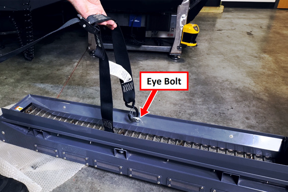

  1. Position the engine hoist behind the front leg of the chip conveyor.
  2. Secure a lifting strap to each eye bolt on either side of the front leg of the chip conveyor. Attach the front lifting straps to the lifting hook on the engine hoist.
Figure 5: Attaching a lifting strap to the front leg of the chip conveyor and the lifting hook on an engine hoist.
  1. Attach another set of lifting straps to the eye bolts on the rear section of the chip conveyor. These straps will be used to guide the conveyor into the coolant tank.
Figure 6: Lifting strap attached to the rear of the chip conveyor for guiding.
WARNING! Transportation and Lift Hazard: Before moving the machine, you must confirm that all persons are clear of the area below the machine. Qualified professionals must transport, lift, and move the machine. Moving parts can entangle, pinch, or cut you, causing death or serious injury.

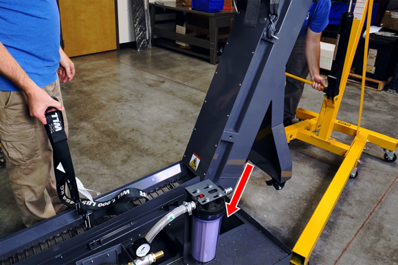

  1. Verify that all lifting straps are secure and that the load is balanced. Slowly raise the engine hoist to lift the front leg of the chip conveyor off the ground.
  2. While the front leg is lifted, have an assistant guide the rear of the conveyor using the lifting strap. Carefully lower the conveyor into the coolant tank, ensuring it aligns with the tank.
Figure 7: Guiding the chip conveyor into the coolant tank.

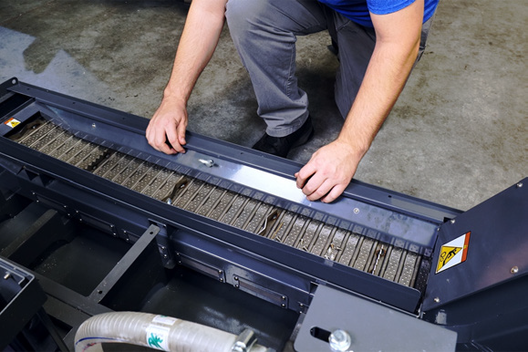

  1. Gradually lower the engine hoist to set the rear of the conveyor inside the coolant tank.
  2. Verify that the chip conveyor is fully seated and aligned within the tank, and that the front leg is stable on the floor. Remove the lifting straps.

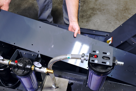

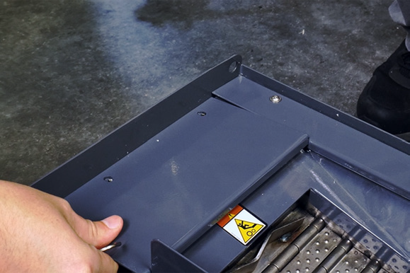

  4. Loosely install the three cover panels onto the coolant tank with a 3 mm hex wrench:
    1. Install the narrow panel along the side of the tank, making sure that the flange on the panel hooks into the inside of the chip conveyor.
Figure 8: Installing the narrow panel.
b. Install the short panel at the end of the tank.
Figure 9: Installing the short panel.
c. Install the wide panel between the conveyor and the pumps.
Figure 10: Installing the wide panel.
NOTE: The knock-outs on the wide panel are used to mount the oil skimmer. If you have an oil skimmer, remove the knock-outs before installing the panel.
d. Tighten the screws on all three panels.

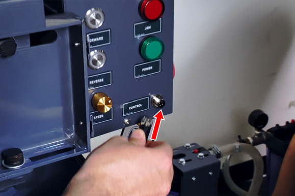

  2. Identify the control cable for the chip conveyor. Connect one end to the Control port on the chip conveyor's control box.
Figure 11: Connecting the control cable to the chip conveyor.

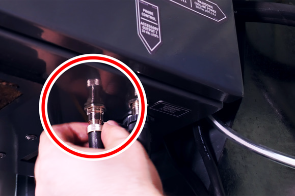

  1. Route the loose end of the control cable to the bottom of the machine's electrical cabinet, and connect it to the Accessory Output 1 port.
Figure 12: Connecting the loose end of the control cable to the mill.

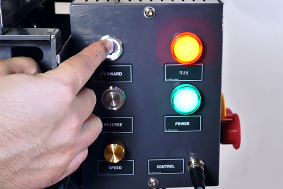

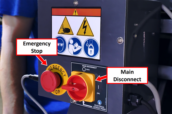

  1. With the machine still powered off, identify the Main Disconnect switch on the chip conveyor’s control box. Turn it to the on position.
Figure 13: Chip conveyor's control box.
  1. Twist out the Emergency Stop button on the chip conveyor.
  2. Turn the Speed knob to the halfway position.

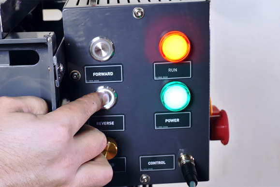

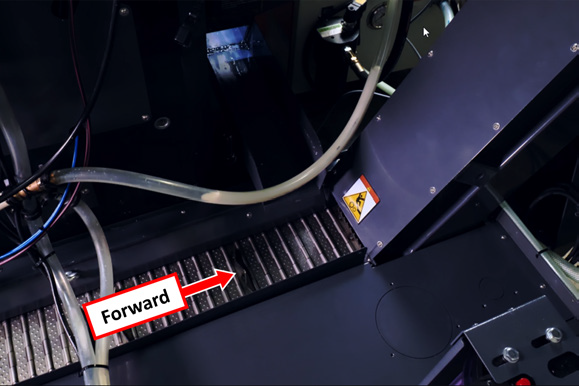

  3. Test the forward and reverse controls:
    1. Press and hold the Forward button on the chip conveyor control box. The chip conveyor runs forward (toward the control box), and the Run light illuminates.
Figure 14: Chip conveyor controls.
Figure 15: Chip conveyor's forward direction.
b. While holding the Forward button, push in the Emergency Stop button on the chip conveyor.
The chip conveyor stops running.
c. Release the Forward button, and twist out the Emergency Stop button.

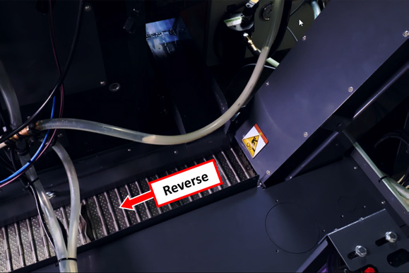

d. Press and hold the Reverse button on the chip conveyor control box. The chip conveyor runs backwards (away from the control box), and the Run light illuminates.
Figure 16: Chip conveyor controls.
Figure 17: Chip conveyor's reverse direction.
e. While holding the Reverse button, push in the Emergency Stop button on the chip conveyor.
    3. Press the Reset button.
  2. Observe the chip conveyor, which should not be running in either direction at this time.
