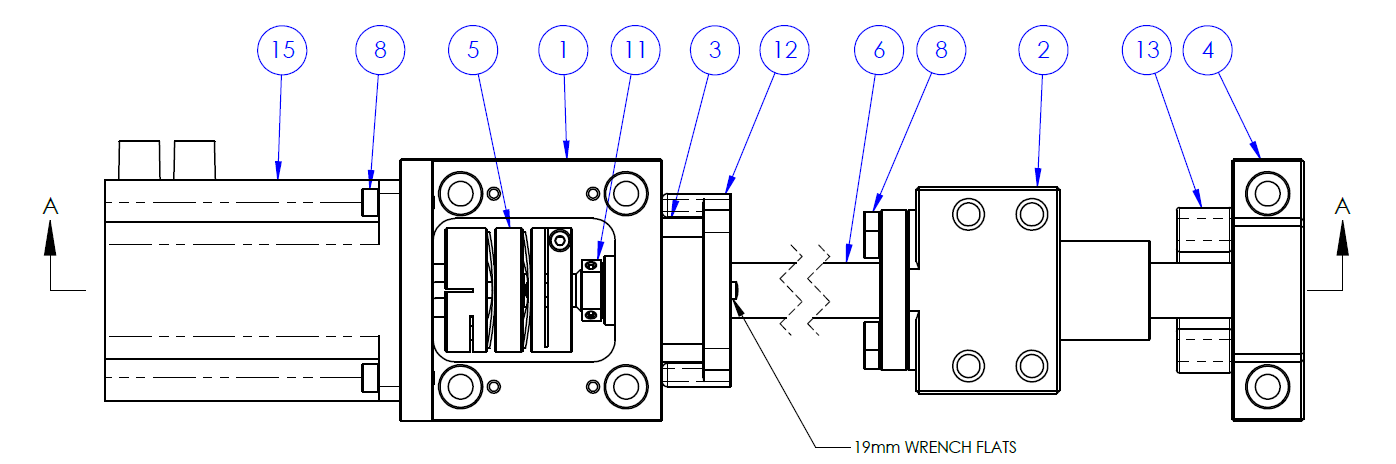

Inspect and Tighten Motor Coupler
Reason: The motor coupler is loose or cracked.
  1. Examine the motor coupling.
    You may find it useful to carefully run the axis with the cover removed. Make a paint line from the shaft through the coupling to the screw to examine if there’s any movement over time.
Axis Coupler (#5)
