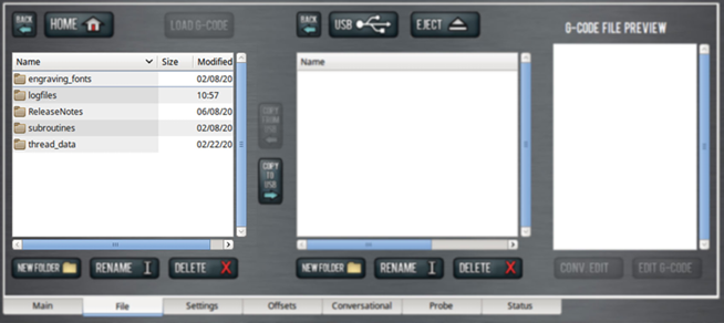

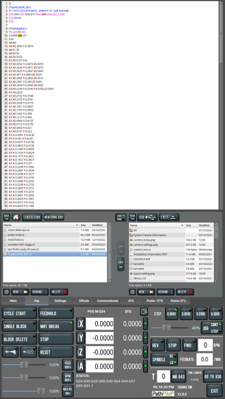

Load G-Code

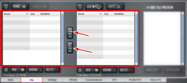

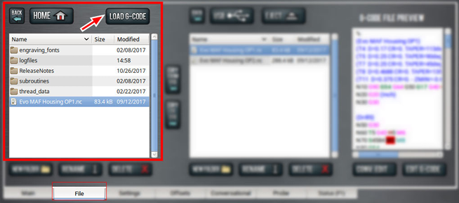

To load G-code:
  2. Select Load G-Code.
Figure 1: Controller Files window on the File tab.
Figure 2: File tab.

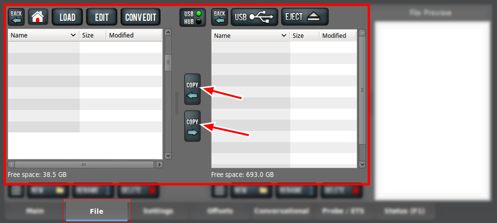

Figure 3: File tab.
  1. Select Eject.

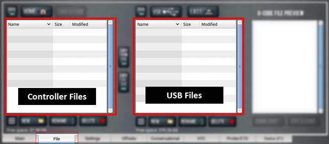

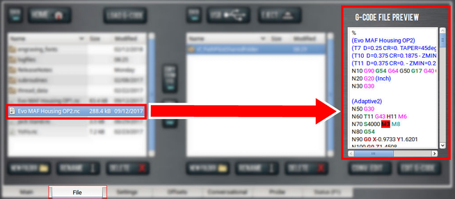

Preview G-Code Files
To preview G-code files:
Figure 4: File tab.

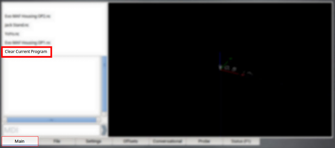

Close the Current Program
Figure 6: Recent Files menu on the Main tab.

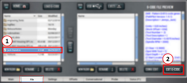

Edit G-Code
Figure 7: Edit G-code button on the File tab.
  2. Close the text editor.

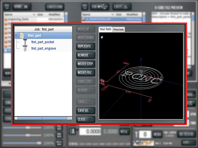

  2. Select Conv. Edit.
Figure 8: Job assignment editor.
    Change the Step Order
    Create a New Job Assignment
    Load an Existing G-Code File
    Edit a Job Assignment
  2. Select Save.
  1. Select Insert Step.
  3. Select Insert.
  3. Select Open.
  1. Select the job assignment, and then select Conv. Edit.
  2. Edit the job assignment.
  3. Select Finish Editing.

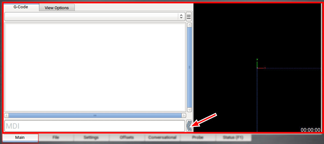

Expand the G-Code Tab
To expand the G-Code tab:
  • Select the Window Expander.
Figure 9: Window Expander on the Main tab.

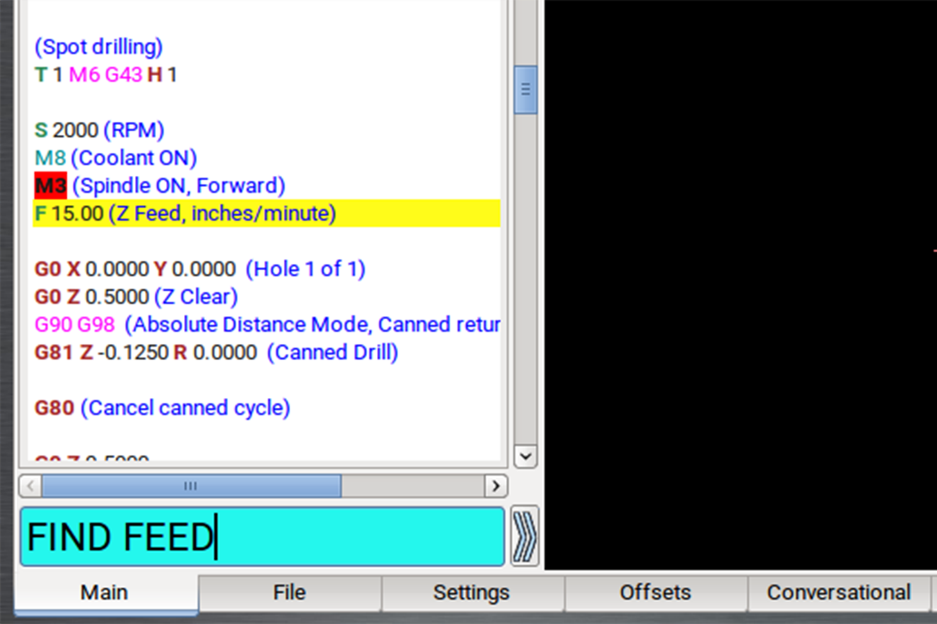

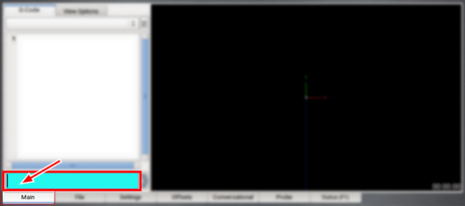

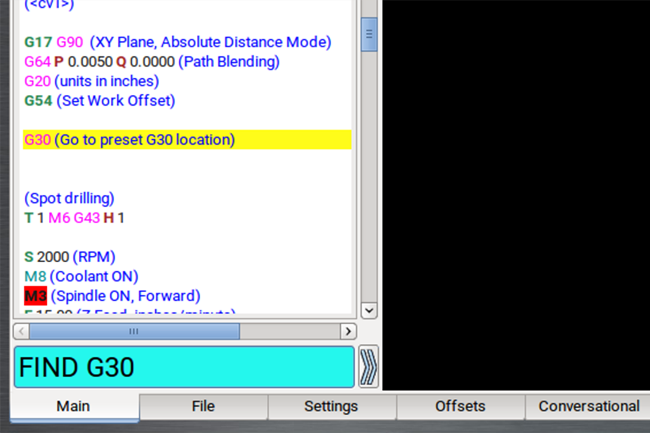

Search in the Code
To search in the code:
    1. Any text. PathPilot searches for instances of the specific number or code.
Figure 10: Search for a text command.
b. Feed. PathPilot searches for instances of the actual word Feed and any F G-code command.
Figure 11: Search for a feed command.
c. Speed. PathPilot searches for instances of the actual word Speed and any S G-code command.
d. Tool. PathPilot searches for instances of the word Tool and any T G-code command.
  1. Select the Enter key.
  2. (Optional) Select Enter.

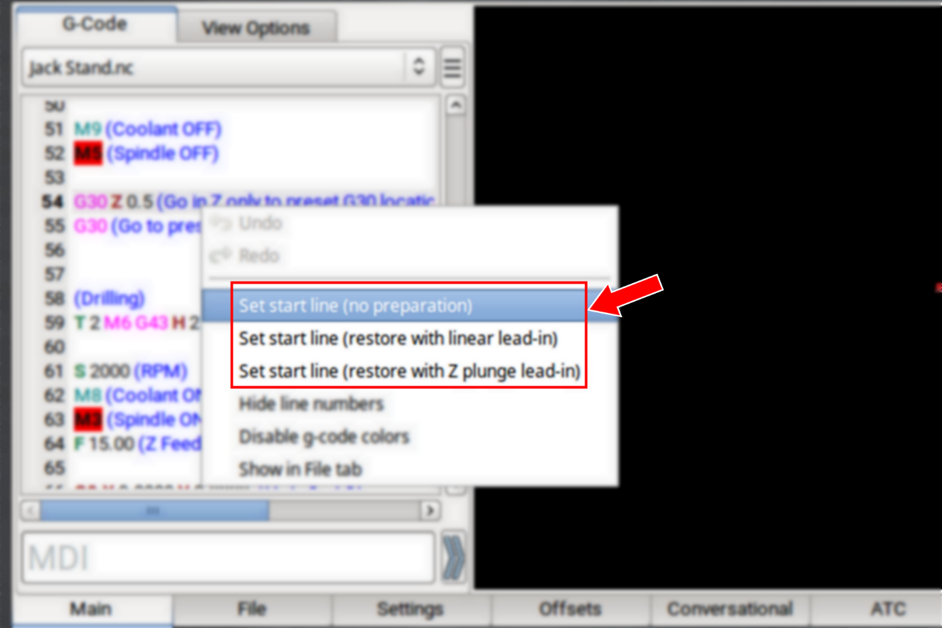

Set a New Start Line
To set a new start line:
    1. Right-click any line in the program.
Figure 12: Accessing the Options menu by right-clicking.
b. Tap the line. Then, select the Options menu.

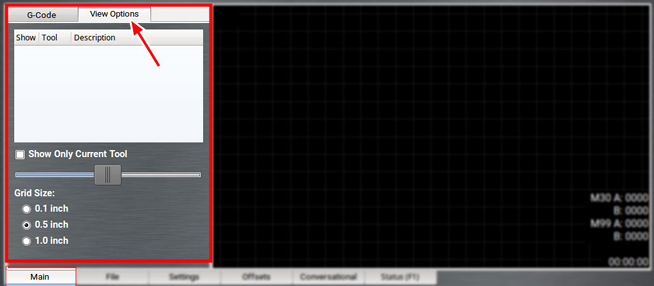

    1. Right-click the Tool Path display.
Figure 13: Tool Path display on the Main tab.
b. Select the View Options tab.
Figure 14: View Options tab on the Main tab.
  1. Select a new view.

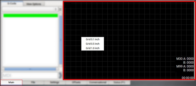

About the Tool Path Display
The Tool Path display is a graphical representation of the currently loaded G-code file's tool path. Depending on which programming mode you're in (G20 or G21), PathPilot defaults to one of the following grid line spacings:
  • G20 Mode 1/2 in. intervals
  • G21 Mode 5 mm intervals
  • Select Reset.

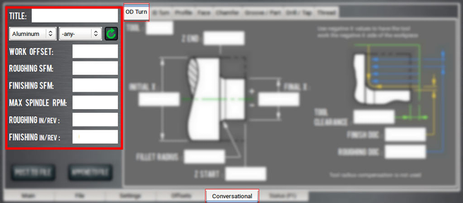

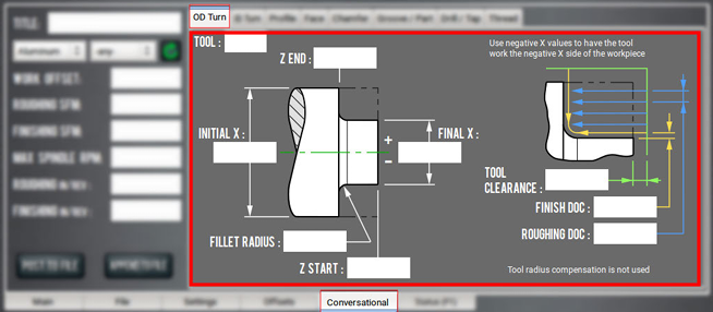

To create an outside diameter:
  1. From the Conversational tab, select the OD Turn tab.
  2. From the Conversational DROs group, set the parameters for the OD turning operation.
Figure 15: Conversational DROs on the OD Turn tab.
    1. In the Tool DRO field, type the currently selected tool as it's defined in the Tool Table window (on the Offsets tab).
      This DRO field is a command value — it sets the tool number for a tool change at the start of the program.
b. In the Initial X DRO field, type the value of the stock's outside diameter.
NOTE: This DRO field is a reference value. It's also used with the Tool Clearance DRO field to locate some of the transitions between rapid and feed rate. If the values in the Initial X DRO field and the Final X DRO field are both positive, the tool works on the positive X side of the spindle center (the side away from you). If they're both negative, the tool works the negative side of the spindle (the side closer to you). It's an error if there's a positive and a negative value for each DRO field.
c. In the Final X DRO field, type the desired value of the part's final outside diameter.
d. In the Z Start DRO field, type the location of the stock's face.
NOTE: This DRO field is used with the Tool Clearance DRO field to set the transition between rapid and feed rate on some Z moves.
e. In the Z End DRO field, type the desired location of the part's face.
f. In the Fillet Radius DRO field, type the desired radius between the part's outside diameter and its face. For no radius, type 0.
NOTE: If you type a value that's less than the tip radius, PathPilot drives the cutter to the corner. If you type a value that's larger than the Z range (the distance between the location of the stock's face and the desired location of the part's face) or the X range (half of the distance between the stock's outside diameter and the desired value of the part's outside diameter), the fillet starts or ends outside of the stock perimeter, and it doesn't end at the specified X and Z locations.
g. In the Tool Clearance DRO field, type the distance required for clearance when the machine makes rapid movements between the stock's outside diameter its face. Because there's only one value used for X and Z moves, use the greater of the two clearances.
NOTE: Use larger values to begin; once you're familiar with how the program works, smaller values may save time. This DRO field is also sometimes used as a location for retracting the tool while making cutting passes.
h. In the Roughing DOC DRO field, type the desired amount of material to remove from the radius of the stock on each roughing pass. The depth of cut is adjusted to get the value used in the G-code.
i. In the Finish DOC DRO field, type the desired amount of material required for one finish pass (completed after roughing).
Figure 16: Program-specific DROs on the OD Turn Tab.

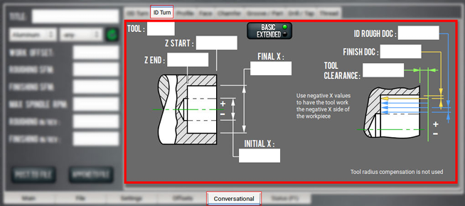

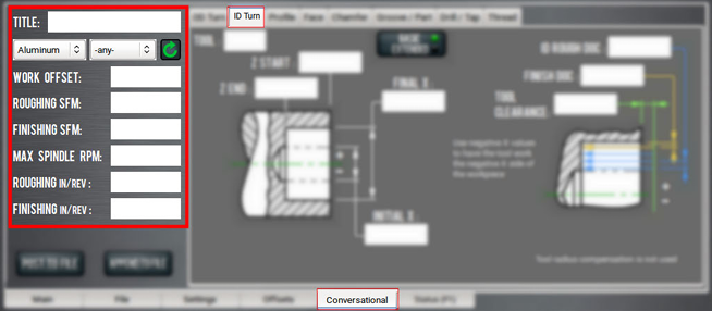

Create an Internal Diameter
Using conversational programming, you can program PathPilot to cut a basic or extended internal diameter on a part. For information, see "About ID Turning".
  • Valid tool orientations are limited to type 2 for a front tool, and type 3 for a rear tool.
  • The tool path changes by 90° on the same side of the tool, so a form tool (narrow tip angle) and separate roughing DOCs are needed.
Basic Internal Diameters
To create a basic internal diameter:

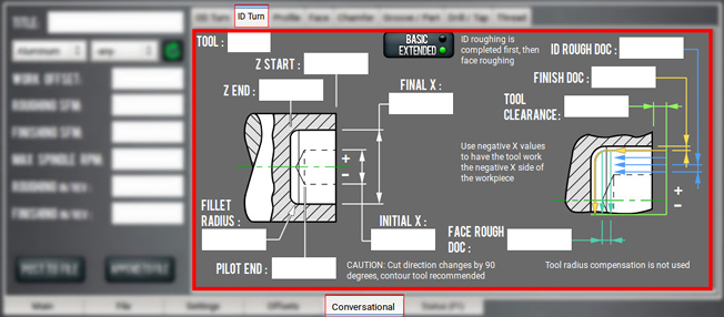

  1. From the Conversational tab, select the ID Turn tab.
  2. From the Conversational DROs group, set the parameters for the ID turning operation.
Figure 17: ID Turn tab on the Conversational tab.
    2. In the Initial X DRO field, type the diameter of the pilot hole. Make sure that the diameter is large enough to clear the tool holder's X width.
    3. In the Final X DRO field, type the desired final diameter of the internal diameter.
    4. In the Z Start DRO field, type the location of the stock's face.
e. In the Z End DRO field, type the desired final location for the part's face.
f. In the Tool Clearance DRO field, type the distance required to retract the tool and transition between rapid and cutting feed rate. Because there's only one value used for X and Z moves, use the greater of the two clearances.
NOTE: Use larger values to begin; once you're familiar with how the program works, smaller values may save time. Larger values bring the back of the tool holder closer to the ID wall on the end of facing cuts.
g. In the ID Rough DRO field, type the depth of material to cut on the radius of the bore. The depth of cut is adjusted to get the value used in the G-code.
h. In the Finish DOC DRO field, type the desired amount of material required for one finish pass on the ID, fillet, and face (completed after roughing).
Figure 18: Program-specific DROs on the ID Turn tab.

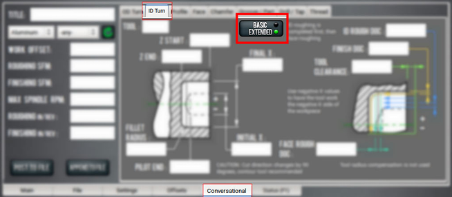

Extended Internal Diameters
To create an extended internal diameter:
  2. Select the button to toggle from Basic to Extended mode.
Figure 19: ID Turn tab in Extended mode.
  1. From the Conversational DROs group, set the parameters for the ID turning operation.
Figure 20: ID Turn tab on the Conversational tab.
    3. In the Final X DRO field, type the desired final diameter of the internal diameter. The value must be greater than twice the tool holder’s X width plus tool clearance.
e. In the Fillet Radius DRO field, type the desired radius between the finished inside diameter and the face.
NOTE: The fillet calculation does not use CRC, so the middle of the fillet may not be on the true radius for a tool with a tip radius. Valid values are 0 or positive. Values larger than the Z range (Z START - Z END) or the X range ((INITIAL X - FINAL X) / 2) are valid, but will have a fillet start or end short of the finish locations, which may not be practical.
f. In the Z End DRO field, type the desired final location for the part's face.
g. In the Tool Clearance DRO field, type the distance required to retract the tool and transition between rapid and cutting feed rate. Because there's only one value used for X and Z moves, use the greater of the two clearances.
h. In the ID Rough DRO field, type the depth of material to cut on the radius of the bore. The depth of cut is adjusted to get the value used in the G-code.
i. In the Face Rough DRO field, type the depth of material to cut on the internal face of the bore. The depth of cut is adjusted to get the value used in the G-code.
NOTE: The reverse or back cutting direction is sensitive to depth of cut. Form tools with a small angle between cutting edges allows for a larger depth of cut.
j. In the Finish DOC DRO field, type the desired amount of material required for one finish pass on the ID, fillet, and face (completed after roughing).
Figure 21: Program-specific DROs on the ID Turn tab.

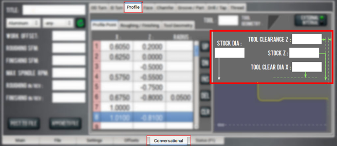

Create a Profile on a Part
Using conversational programming, you can program PathPilot to rough and finish an arbitrary internal or external profile on a part. For information, see "About Profiling".
  • The Tool Clear Dia X DRO field has a value of smaller diameter than first X value on the Profile Point table.
  • An internal tool is indicated in the Tool DRO field.
Describe the Stock
  2. (Optional) To create an internal profile, select the button to toggle from External mode to Internal mode.
  3. From the Conversational DROs group, set the parameters for the profiling operation.
Figure 22: Conversational DROs on the Profile tab.
    1. In the Stock Dia DRO field, type the diameter of the stock.
    2. In the Tool Clearance Z DRO field, type the Z value for the tool clearance on the Z-axis.
      Tool Clearance Z is the Z plane the tool goes from rapid to feed.
    3. In the Stock Z DRO field, type the starting Z value for the profile.
    4. In the Tool Clear Dia X DRO field, type the X value — as a diameter — for the tool clearance on the X-axis.
      1. For External Profiles You must make sure the value typed in the Tool Clear Dia X DRO field is a larger diameter than the value typed in the Stock Dia DRO field.
      2. For Internal Profiles You must make sure the value typed in the Tool Clear Dia X DRO field is a smaller diameter than the first diameter (specified in the Profile Point table).
Figure 23: Program-specific DROs on the Profile tab.

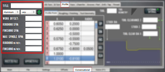

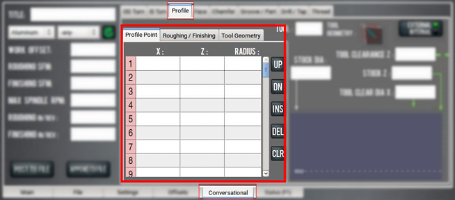

Identify the Profile Points
Use the Profile Point table to describe the point-to-point values of a profile — from a larger Z value to a smaller Z value. As you work through the Profile Point table, PathPilot displays a graphical representation of the profile on your part.
Click on any segment in the graphic to highlight the corresponding row in the Profile Point table. Alternately, you may click on any row in the Profile Point table to highlight the corresponding segment in the graphic.
Point the mouse toward any area in the graphic and use the scroll wheel to zoom in and out to enlarge small features. To quit zooming, either select the Esc key or select another line in the Profile Point table.
To identify the profile points:
  1. Select the Profile Point tab.
  2. In the Profile Point table, type the X and Z values for the profile. X values are in diameters terms. The X field is expressed in terms of X+ cutting (X- G-code will properly be generated if the tool selection calls for it).
NOTE: If the value is unchanged from the previous row in the Profile Point table, PathPilot assumes the value is repeated. If you are using the same value, you can leave the cell empty.
  1. (Optional) In the Radius column, type a value to X and Z end points to create an arc.
    1. For a Center Point Above and/or to the Right of the Start Point Type a positive radius value.
    2. For a Center Point Below and/or to the Left of the Start Point Type a negative radius value.
Figure 24: Profile Points table on the Profile tab.
Identify the Tool
  1. In the Tool DRO field, type the number of the tool to use for creating the profile.
    Tool Geometry displays a graphical representation of the selected tool.
  2. On the graphical representation of the profile on your part, make sure there are no red line segments. If there are red line segments, you must specify a new tool or edit the fields in the Profile Point table.
    A red line segment indicates that the geometry of the selected tool cannot cut the programmed angle without gouging the part profile — typically, when feature entry or exit angles are too steep for the tool geometry to clear.
    The back angle of the tool will not clear the entry to the arc feature.

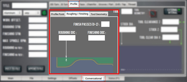

Identify the Roughing and Finishing
Use the Roughing / Finishing tab to describe the required roughing and finishing for the part’s profile.
NOTE: You can use only roughing or only finishing. It is an error if all three of the following DRO fields are empty: Finishing Passes, Roughing DOC, and Finishing DOC.
To identify the roughing and finishing:
  1. Select the Roughing / Finishing tab.
    PathPilot updates the graphical representation of the profile depending on which DRO field you select:
    1. Select inside the Roughing DOC DRO field to display a roughing graphic.
b. Click inside the Finishing DOC DRO field or the Finish Passes DRO field to display a finishing graphic.
  1. In the Roughing DOC DRO field, type the depth of cut for each roughing pass.
NOTE: The default value is 0.02 inches.
  1. In the Finishing DOC DRO field, type the depth of cut for each finishing pass.
NOTE: The default value is 0.003 inches.
4. In the Finishing Passes DRO field, type the number – from 0-2 – of finishing passes.
NOTE: The default value is 2 (passes).
A finishing pass is a continuous pass from the start of the profile (toward the tailstock) to the end of the profile (toward the headstock).
Figure 25: Roughing/Finishing tab on the Profile tab.

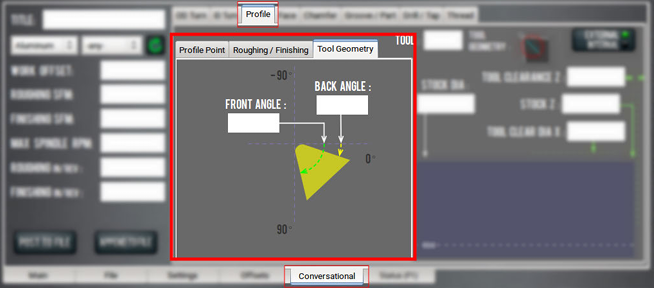

Describe the Tool Geometry
Use the Tool Geometry tab to describe the front and rear profiling angles. Because there are many tool and tool holder geometries, the Tool Geometry tab allows you to properly describe each tool and avoid part gouging.
To describe the tool geometry, you must first determine the cutting direction: either X+ or X-, based on the tool orientation and an external or internal profile.
For example, if you are cutting an external profile on a part and have a tool orientation of 2, PathPilot creates X+ G-code.
Use the following table to determine the cutting direction:
Cutting Direction
Internal or External
Tool Orientation
X+ (typically, while using a turret)
External
1, 2, 6
Internal
3, 4, 8
X- (typically, while using a quick-change tool post)
External
3, 4, 8
Internal
1, 2, 6
To describe the tool geometry:
  • X+ Cutting Tool In the Front Angle DRO field and the Back Angle DRO field, type the value of the tool geometry expressed as a negative angle in the counterclockwise direction from 0˚.
NOTE: The Tool Geometry graphic preview (to the right of the Tool DRO field) updates as angles are changed.
  • X- Cutting Tool In the Front Angle DRO field and the Back Angle DRO field, type the value of the tool geometry expressed as a negative angle in the clockwise direction from 0˚.
Figure 26: Tool Geometry tab on the Profile tab.

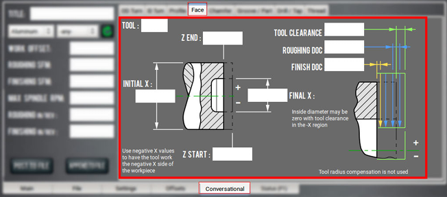

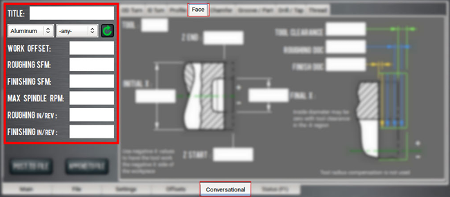

Create a Face on a Part
Using conversational programming, you can program PathPilot to cut a face with tool paths from the stock's outer diameter to the spindle center or an inner diameter (with each pass progressing in Z toward the headstock). For information, see "About Facing".
  • To cut with a rear tool, the values used in the Initial X DRO field and the Final X must be positive. The tool works on the positive X side of the spindle center (the side away from you).
  • To cut with a front tool, the values used in the Initial X DRO field and the Final X must be negative. The tool works on the negative side of the spindle (the side closest to you).
  • The value used in the Roughing DOC DRO field must be positive.
  • The value used in the Finish DOC DRO field must be positive.
  • Spindle speed control: CSS.
  • Feed rate control: FPR.
To create a face on a part:
Figure 27: Conversational DROs on the Face tab.
    1. In the Tool DRO field, type the tool number for use with the program. This sets the tool number for a tool change at the start of the program.
    2. In the Initial X DRO field, type the stock diameter. This value is also used with the value in the Tool Clearance DRO field to locate some of the transitions between rapid and feed rate.
    3. In the Final X DRO field, type the location of the face inside diameter. The tool path goes beyond this diameter by the tool clearance. For tools with a tip radius, the control point and face contact point aren't the same, so the tool clearance value, if greater than the tool tip radius, can be used to extend the path to the contact point.
    4. In the Z Start DRO field, type the location of the stock face. Roughing passes start here. It is also used with Tool Clearance to set the transition between rapid and feed rates on some moves.
    5. In the Z End DRO field, type the finished face location.
    6. In the Tool Clearance DRO field, type the desired space required for tool retracting and transitions between rapid and cutting feed rate. Since there's one value used for X and Z moves, set the value to the greater of the two clearances. Larger values may be safer, but brings the back of the tool holder closer to the inner diameter wall on the end of facing cuts. Smaller values may save time once you're familiar with how well the program works.
    7. In the Roughing DOC DRO field, type the depth of the material being cut. This depth of cut is adjusted to get the value used in the G-code.
    8. In the Finish DOC DRO field, type the desired amount of material required for one finish pass (after roughing).
Figure 28: Program DROs on the Face tab.
About Facing
  1. Rough facing starts at Z Start and incrementally cuts at the depth of cut until the start of the finish face pass (Z End + Finish DOC).
  2. The start of each pass is at the Initial X diameter + Tool Clearance and moves in the minus X direction until the Final X diameter – Tool Clearance is reached.
    If the value in the Final X DRO field is zero, the end of the pass will go beyond the spindle center.
  3. Finishing is done in one pass at the value entered into the Finish DOC DRO field.

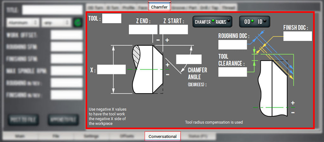

Create a Chamfer or Radius on a Part
Using conversational programming, you can program PathPilot to cut a chamfer, taper, or corner radius. For information, see "About Chamfer and Radius".
  • Uses cutter compensation (G41, G42), so that tools with a nose radius can cut to the correct profile.
  • Radii are limited to 90° arcs that start on the outside diameter (the Initial X DRO field and the Z End DRO field). Be careful when using chamfer angles less than 30° or greater than 60°, due to the extra travel involved in traversing the tool clearance space at an angle. The path may take the tool into the chuck, spindle, or adjacent workpiece features.
  • The value used in the Rouging DOC DRO field must be positive.
  • Tool feed control: FPR.
To create a chamfer or radius on a part:
  1. From the Conversational tab, select the Chamfer tab.
  2. From the Conversational DROs group, set the parameters for the chamfer or radius operation.
Figure 29: Conversational DROs on the Chamfer tab.
    2. In the DRO field, type the stock diameter. This value is also used with the Tool Clearance DRO field to locate some of the transitions between rapid and feed rates.
    3. In the Z Start DRO field, type the stock face or the end of the chamfer or radius. This value is also used with the Tool Clearance DRO field to set the transition between rapid and feed rates on some Z moves.
    4. In the Z End DRO field, type the location of the start of the chamfer or radius. The Z width of a chamfer or the radius of a corner equals (Z End - Z Start).
    5. (Optional) In the Chamfer Angle DRO field, type the angle between the workpiece centerline and the chamfer.
    6. In the Tool Clearance DRO field, type the desired space beyond the stock outside diameter and face that's required for some movements to clear the workpiece. Since there is one value used for X and Z moves, set the value to the greater of the two clearances. Larger values may be safer; smaller values may save time once you're familiar with how well the program works. This field is also sometimes used as a location for retracting the tool while making cutting passes.
    7. In the Rouging DOC DRO field, type the depth of cut during roughing. The depth of cut is adjusted. In this case, the roughing range is the distance from the workpiece corner (the intersection of the face and outer diameter) and the closest point on the chamfer or radius minus the finish depth of cut.
Figure 30: Program DROs on the Chamfer tab.
During a routine to create a chamfer or a radius, PathPilot does the following:
  1. Roughing starts at the corner of X and Z Start in adjusted depth of cut increments perpendicular to the chamfer angle or incremental arcs for radius.
  2. The last roughing pass leaves enough material for the finish pass; finishing is done with a single pass.
  3. Passes start and end on the perimeter of the tool clearance space, which is set by adding the tool clearance DRO value to the stock OD, X, and the face location, Z Start.

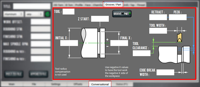

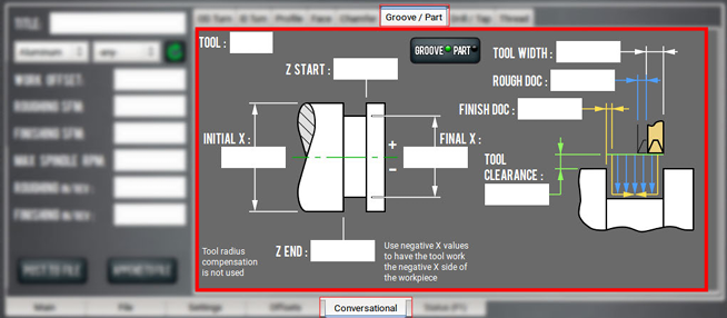

Create a Groove or Part a Workpiece
Using conversational programming, you can program PathPilot to create a groove or to part a workpiece from stock. For information, see "About Grooving and Parting".
  • Grooving paths are based on Z Start and Z End values:
    • If the value in the Z Start DRO field is greater than the value in the Z End DRO field, the tool’s control point is set to the +Z side of the tool.
    • If the value in the Z Start DRO field is less than the value in the Z End DRO field, the control point is set to the -Z side of the tool.
  • Groove roughing is done with plunge cuts in the X direction. Each plunge is incremented in the Z direction from Z Start ± Finish DOC to Z End ± (Tool Width + Finish DOC).
  • Even though a grooving/parting tool may be considered to have two tips, valid tool orientation is limited to:
    • Groove on the negative side of Z Start, Back Tool = Type 1
    • Groove on the positive side of Z Start, Back Tool = Type 2
    • Groove on the positive side of Z Start, Front Tool = Type 3
    • Groove on the negative side of Z Start, Front Tool = Type 4
    • Part on the negative side of Z Start, Back Tool = Type 1
    • Part on the negative side of Z Start, Front Tool = Type 4
  • CSS is used for spindle speed control.
  • FPR is used for feed rate control.
  • CRC is not used.

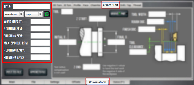

To create a groove on a part, or to part a workpiece:
  1. From the Conversational tab, select the Groove/Part tab.
  2. From the Conversational DROs group, set the parameters for the grooving or parting operation.
Figure 31: Conversational DROs on the Groove/Part tab.
  1. If required, toggle the Groove/Part button. Then, do one of the following:
Create a Groove on a Part
Work through the program-specific DRO fields:
  2. In the Initial X DRO field, type the stock diameter. This value is also used with the Tool Clearance DRO field to locate some of the transitions between rapid and feed rates.
  3. In the Final X DRO field, type the diameter of the new groove bottom or the end of the parting.
  4. In the Z Start DRO field, type the location of the groove start. For parting, this field sets the location of the +Z side of the slot.
  5. In the Z End DRO field, type the location of the groove end.
  6. In the Tool Width DRO field, type the groove or parting tool's width.
  7. In the Rough DOC DRO field, type the depth of the material being cut. In this case, for groove, it is the Z offset for each plunge cut. The depth of cut is adjusted. Valid values are positive and normally should be less than the full depth width of the tool tip (usually the distance between tip radii centers).
  9. In the Tool Clearance DRO field, type the desired space beyond the stock outside diameter for rapid movements to clear the workpiece. Larger values may be safer; smaller values may save time once you're familiar with how well the program works. This field is also sometimes used as a location for retracting the tool between cutting passes.
Figure 32: Program-specific DROs on the Groove/Part tab.
Part a Workpiece from the Stock
  5. In the Tool Width DRO field, type the groove or parting tool's width.
  6. In the Tool Clearance DRO field, type the desired space beyond the stock outside diameter for rapid movements to clear the workpiece. Larger values may be safer; smaller values may save time once you're familiar with how well the program works. This field is also sometimes used as a location for retracting the tool between cutting passes.
Figure 33: Program-specific DROs on the Groove/Part tab.
  1. Groove finishing is done with a plunge cut down the Z End side.
  2. When the tool reaches the bottom, the tool is moved in the Z direction toward the center of the groove, then retracts.
  3. The tool is plunged on the Z Start side of the groove, then again is moved in Z toward the groove center and retracted. This requires a grooving tool, which can side cut. Part does one plunge cut at Z Start. The tool’s control point is on the +Z side of the tool. The plunge cannot be set to go beyond the spindle center (X = 0).

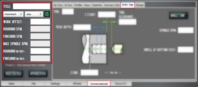

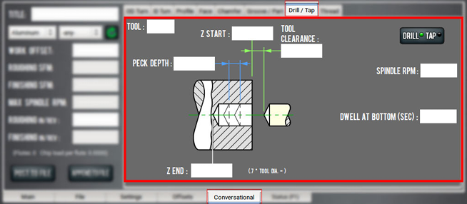

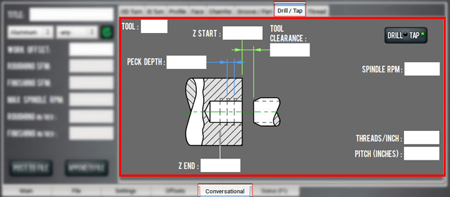

Create Holes on a Part or Tap a Hole
Using conversational programming, you can program PathPilot to drill holes on a part, or use rigid tapping to thread holes on a part. For information, see "About Drilling and Tapping".
  • The value used in the Z Start DRO field must be larger than the value in the Z End DRO field.
  • For tapping, the value used in the Z End DRO should allow for extra threading while the spindle comes to a stop and reverses.
  • The value used in the Peck Depth DRO field needs a direction, so should have a negative value.
  • Drilling is limited to the -Z direction, toward the spindle.
  • Use the RPM DRO field instead of CSS.
To create holes on a part, or to tap a hole:
  1. From the Conversational tab, select the Drill/Tap tab.
  2. From the Conversational DROs group, set the parameters for the drilling or tapping operation.
Figure 34: Conversational DROs on the Drill/Tap tab.
  1. If required, toggle the Drill/Tap button. Then, do one of the following:
Create a Hole on a Part
  2. In the Z Start DRO field, type the stock face location. This field is also used with the Tool Clearance DRO field to set the transition between rapid and the feed for drilling or tapping.
  3. In the Z End DRO field, type the final depth. This is the location where the drill feed stops and optionally dwells.
  4. In the Peck Depth DRO field, type an incremental depth for retracting the drill to clear chips from the hole, if required. If drilling the hole doesn't need a peck, type 0. To make each peck depth equal, the value is adjusted to fit an integer number of pecks within the hole depth.
  5. In the Tool Clearance DRO field, type the desired space required for tool retraction and transitions between rapid and cutting feed rate.
  6. In the Spindle RPM DRO field, type the RPM (G97) desired.
  7. In the Dwell at Bottom (Sec) DRO field, type the length of time that Z motion should pause so that the drill can finish cutting the hole bottom before retracting.
Figure 35: Program-specific DROs on the Drill/Tap tab.
Create Threads in a Hole
  3. In the Z End DRO field, type the final depth. This is the location where the spindle rotation is reversed.
  7. In the Threads/Inch (/mm) DRO field, type the Z motion to spindle ratio that matches the thread pitch required. This field is also used with the Pitch (Inches) DRO field, so entering a value in either field calculates and inserts a value in the other.
  8. In the Pitch (Inches) DRO field, type the Z motion to spindle ratio that matches the required thread pitch. This field is also used with the Threads/Inch (/mm) DRO field, so entering a value in either field calculates and inserts a value in the other.
Figure 36: Program-specific DROs on the Drill/Tap tab.
Drilling
  1. For feed rate control, drill uses a millimeter or inch feed per revolution (G95) to feed from Z Start + Tool Clearance until Z End.
  2. Rapids back to Z Start + Tool Clearance.
Dwell allows a pause for the drill to stay at Z End long enough to cut a full revolution at the bottom of the hole (rather than immediately retracting the drill, which could leave an irregular bottom).
Pecking can help clear chips before they bind in the hole during drilling. The peck motion retracts to Z Start + Tool Clearance on each cycle.
NOTE: Due to motion control limits, the retract to Z Start + Tool Clearance may not retract fully before starting the next drilling feed. You must verify that the pecking retract motion meets requirements for your application.
Tapping
Tap uses electronic gearing (G33.1, Rigid Tapping) to lock the Z-axis and spindle motion together for rigid tapping.
  1. Tapping starts with the tap at Z Start + Tool Clearance.
  2. Z motion waits until the spindle encoder index is tripped. Then, the gears are engaged and Z feeds at the rate set by the pitch or threads per unit (TPU) and spindle encoder count. The Z motion follows the spindle motion no matter what the spindle does.

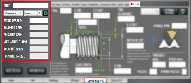

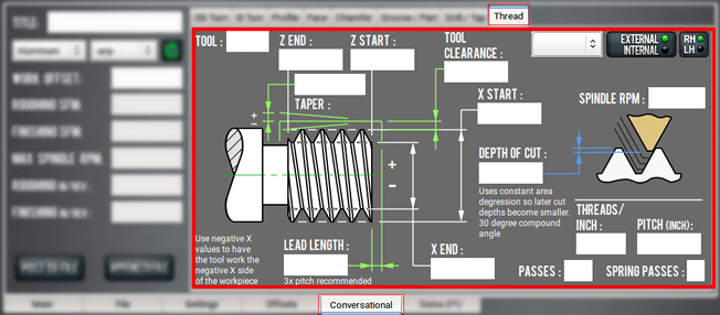

Create Threads on a Part
Using conversational programming, you can program PathPilot to single point an external or an internal thread on an existing outer diameter. For information, see "About Threading".
  • The value used in the Z Start DRO field must be larger than the value used in the Z End DRO field.
  • The value used in the Depth of Cut DRO field must be positive.
To create threads on a part:
  1. From the Conversational tab, select the Thread tab.
  2. From the Conversational DROs group, set the parameters for the threading operation.
Figure 37: Conversational DROs on the Thread tab.
  1. If required, toggle the External/Internal button or the RH/LH button.
  2. Work through the program-specific DRO fields:
    2. In the X Start DRO field, type the existing major diameter for external threads, or minor diameter for internal threads.
    3. In the X End DRO field, type the location of the new outside diameter.
    4. In the Z Start DRO field, type the stock face location. This value is also used with the Tool Clearance DRO field to set the transition between rapid and feed rate on some Z moves.
    5. In the Z End DRO field, type the final thread Z location.
    6. In the Tool Clearance DRO field, type the desired space beyond the stock outside diameter that's required for rapid movements to clear the workpiece. This sets the starting X diameter of the thread cycle return path. Larger values may be safer; smaller values may save time once you're familiar with how well the program works.
    7. In the Lead Length DRO field, type the required length during the start of the cutting path that allows the motion to stabilize before cutting material. The start of a cutting pass waits for the spindle encoder index to trip; when it does, the Z motion tries to instantly match the spindle speed, but actually needs time to accelerate and match the spindle encoder count. This value must be a compromise between spindle speed, thread pitch, and workpiece clearance.
    8. From the Thread Table drop-down menu, select the value for the thread. The threads listed in this menu follow the current unit setting (inch or millimeter). Once you make a selection, the data for that thread is entered into the appropriate DRO fields.
NOTE: The values entered in these tables assume a full form thread tool. If you're using a fine point threading tool to cut coarse threads, you must modify the root diameter to account for the smaller tool nose radius of the fine point threading tool.
i. In the Spindle RPM DRO field, type the spindle rpm.
j. In the Depth of Cut DRO field, type the depth of material being cut. Each pass is incremented based on a calculation of the area of the material being removed. This allows for a constant tool load for each pass.
k. In the Threads/Inch (/mm) DRO field, type the number of threads per inch (or millimeter).
l. In the Pitch (Inch) DRO field, type the distance per thread.
m. In the Passes DRO field, type the number of successive passes to cut the thread.
n. In the Spring Passes DRO field, type the number of extra passes at full thread depth. We suggest using this to clean up the thread and compensate for any material deflection during thread cutting.
Figure 38: Program-specific DROs on the Thread tab.

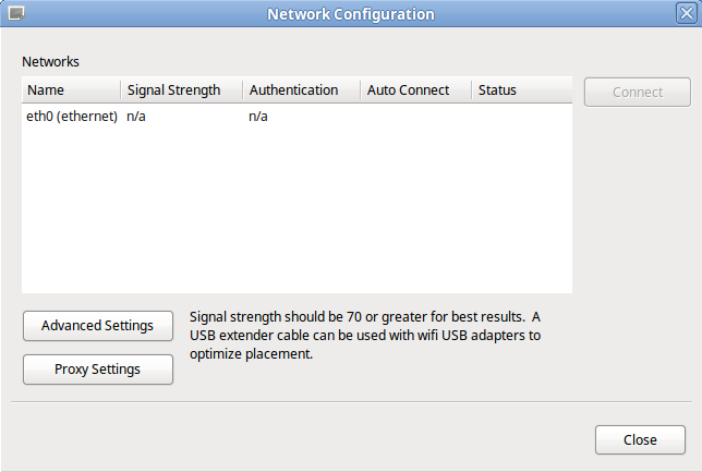

Enable an Internet Connection
If desired, you can enable an internet connection on your PathPilot controller. An internet connection allows you to receive automatic PathPilot updates and transfer files with PathPilot HUB instead of a USB drive.
Figure 39: Internet button on the Settings tab.
Figure 40: Network Configuration dialog box.
  1. Once connected, you can use PathPilot HUB and automatic updates features. Depending on what you want, see the following procedures:

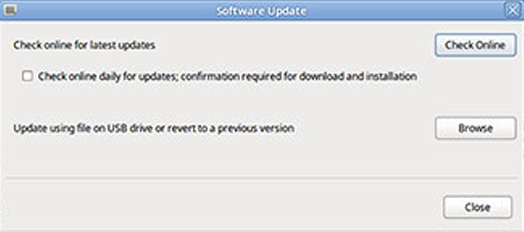

Enable Automatic Updates
To enable automatic updates:
Figure 41: Software Update dialog box.
  2. Select Close.

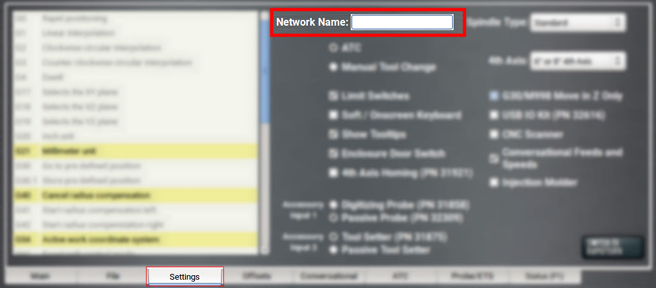

Change the Network Name
To change the network name:
Figure 42: Network Name field on the Settings tab.

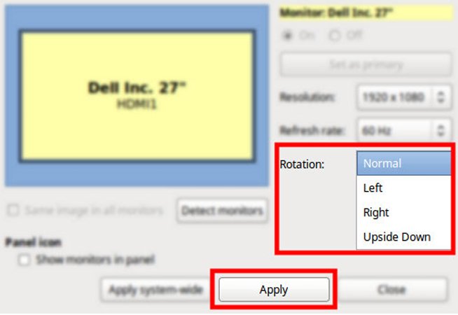

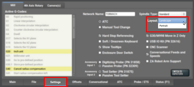

Change the Screen Orientation
Figure 43: Layout drop-down menu on the Settings tab.
Figure 44: Monitor configuration dialog box.

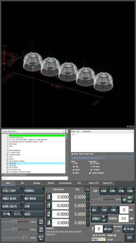

About Portrait Screen Layout
Figure 45: Tool Path window in portrait screen layout.
Figure 46: File tab G-code preview in portrait screen layout.

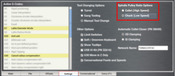

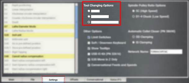

Specify the Spindle Pulley Option
  • From the Settings tab, select one of the following:
    • Collet (High Speed)
    • Chuck (Low Speed)
Figure 47: Spindle pulley options on the Settings tab.
Figure 48: Tool change method options on the Settings tab.

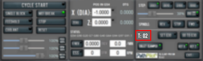

About Turret Tool Changes
T commands T01 through T08 cause the turret to index (regardless of current machine position) and the offsets for the requested tool are applied. With the turret setup, tool numbers higher than eight are still available, and a T command of, for example, T09 does not cause turret rotation but does apply the offsets for tool 9. It is possible to mount a parting tool or gang of drills to the lower portion of the carriage and assign tool numbers higher than eight to these tools.
The machine does not automatically retract to G28 or G30 position before a tool change. You must program the machine to a safe position before executing a T command. If generating code using the conversational features of the control, a G30 is inserted before each tool change command.
About Gang Tool Changes
If the gang option is selected, the T command simply applies the offsets for the selected tool. Unlike the manual tool change option, T commands with the gang option selected doesn't pause the program during the tool change. Offsets are applied nearly instantaneously, and machining resumes automatically during part program execution.
About Manual Tool Changes
The manual tool change option causes the machine to pause at the T command during G-code program execution. This allows you to manually change tools on a quick-change tool post. After changing tools, selecting Cycle Start resumes program execution with the new tool offsets applied. When the machine is paused waiting for a manual tool change in the middle of a G-code program, the light on the Cycle Start button flashes, and the tool label flashes with the requested tool number.
About Mixed Tooling Changes
When mixing turret or gang tools with quick-change tool post mounted tools, there are two choices:
  1. If you select the turret or gang setting, the machine won't automatically pause for manual changes of quick-change tool post tools. You must program these manual M01 stops.
NOTE: We recommend this option.
  1. If you select the quick-change tool post option, you must select Cycle Start to confirm both manual and turret/gang changes.

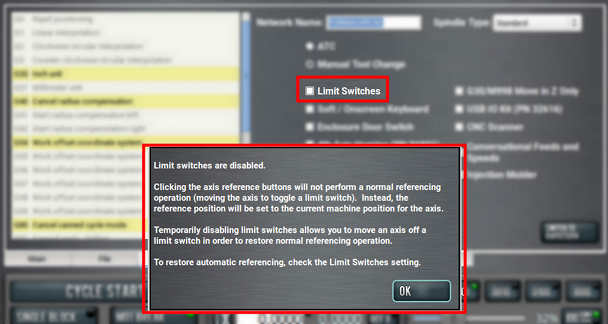

Disable Limit Switches
To provide a temporary workaround for a malfunctioning limit switch circuit, you can disable the limit switches. For information, see About Limit Switches.
NOTE: By default, the Limit Switches checkbox is selected.
To disable limit switches:
  1. From the Settings tab, clear the Limit Switches checkbox.
Figure 49: Limit Switches checkbox on the Status tab.
  1. Select OK.

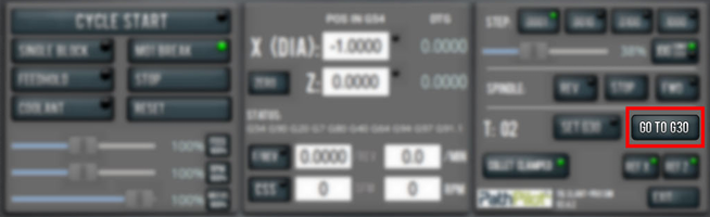

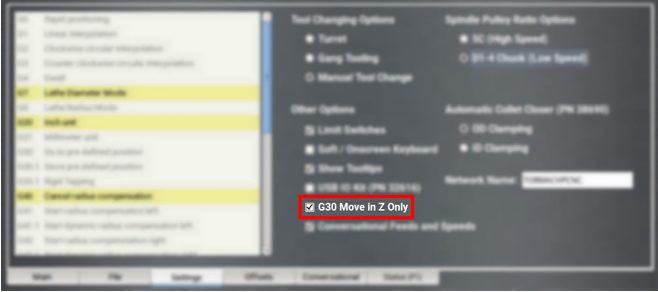

Limit G30 Moves
To limit G30 moves:
  • From the Settings tab, select G30 Move in Z Only.
Figure 50: Settings tab.
About G30

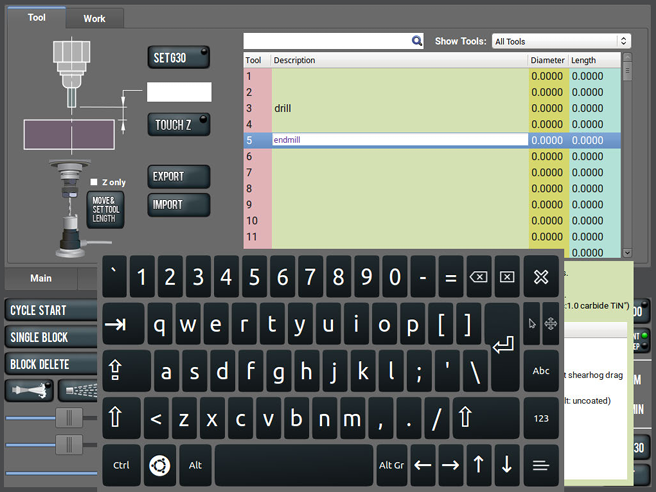

Enable the On-Screen Keyboard
Figure 51: Settings tab.
Figure 52: Soft Keyboard
Figure 53: Soft Keyboard
About Soft Keyboards
Figure 54: Soft (on-screen) keyboard.
Figure 55: Settings tab.

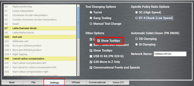

Enable Tooltips
Figure 56: Show Tooltips checkbox.
Figure 57: Settings tab.

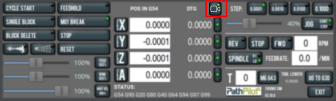

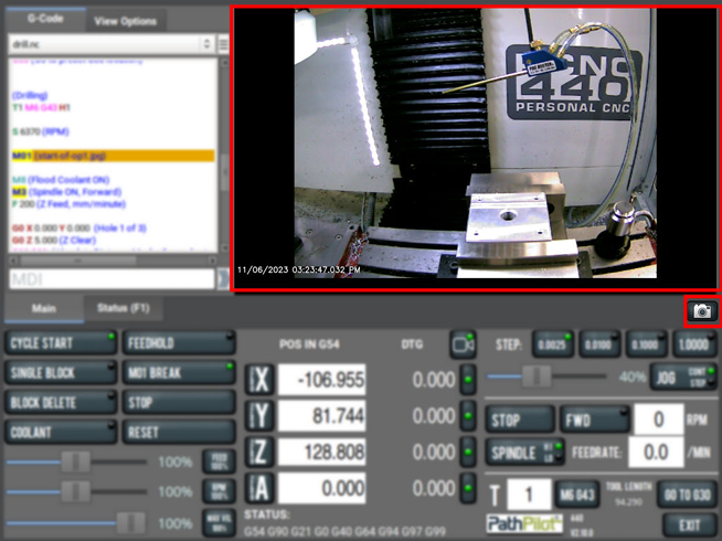

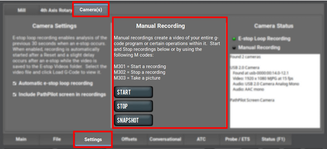

Use a USB Camera
Figure 58: USB camera status.
About USB Cameras
Manual Recording
Figure 59: Manual recording controls.
Figure 60: Video Camera Recording button.
Figure 61: Camera settings.
    The Main tab displays.
Figure 62: Example of taking a photo.

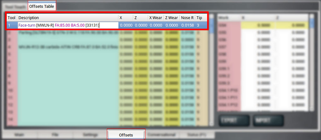

Set Tool Geometry Offsets

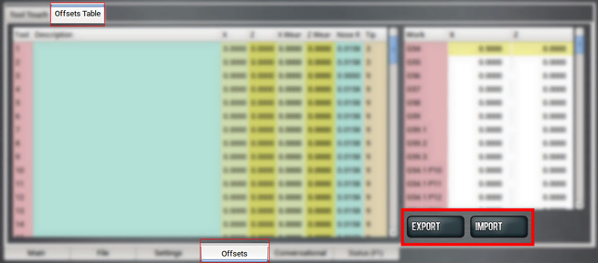

Before running a G-code program, PathPilot must know the geometry of the tools that are required for the program. For more information on using tool length offsets, see "About Tool Offsets".
NOTE: You can import a .csv file with tool geometry offset data. For information, see "Import and Export the Tool Table".
To set tool geometry offsets:
  1. Verify that the machine is powered on, out of reset, and the axes have been referenced.

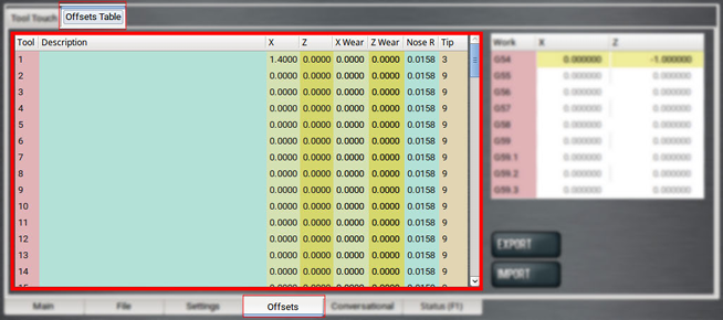

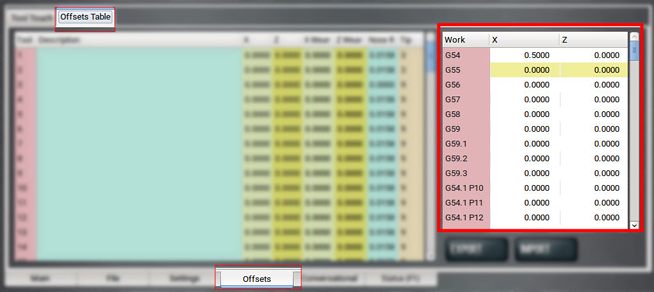

  2. From the PathPilot controller, on the Offsets tab, select the Offsets Table tab.
  3. Find the Tool Table window.
Figure 63: Tool Table window on the Offsets tab.
  1. Touch off the tool geometry offsets. For information, see "Touch Off the Tool Geometry Offsets".
  2. (Optional) Select a field to edit. When finished, select the Enter key.

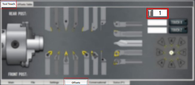

On the Offsets tab, you can use the Tool Touch tab to graphically select a tool, and then touch off the tool to set the geometry offsets.
Tip! When using this method to measure your tool geometry, remember that the X zero location never changes (the spindle centerline is always X = 0), but the Z zero location may change depending on the length of the workpiece that is chucked into the spindle. As long as each tool is measured to a face that has been zeroed, only measure these tools one time or until you replace an insert.
To touch off the tool geometry offsets:
  • From the Offsets tab, on the Tool Touch tab, select a tool.
    The tools along the bottom of the screen are front tool post tools (used by machines with a quick-change tool post setup).
NOTE: Gang tooling setups typically use both front and rear tool post tools.
After you select the tool, PathPilot:
  • Sets the tip orientation for the tool, used (along with tip radius) in cutter compensation.
  • Sets the tool type (front tool post or rear tool post), used by the conversational routines to double check the user entry fields in an attempt to try to detect and prevent crashes.
  • Displays the tool touch off dialog.
Touch X
  1. Take a skim cut off of the diameter of the workpiece — just long enough to measure the cut surface with a micrometer.
  2. Jog the tool away from workpiece in Z, but don't jog the machine in X.
  3. Measure the diameter of the skim-cut workpiece with a micrometer.
  4. In the Touch X DRO field, type the value that you measured in Step 3.
NOTE: If you're touching off a front tool post tool, verify that the value you enter is positive.
  1. Select Touch X.
    The LED comes on.
Touch Z
  1. Jog the machine toward the part zero (usually the face of the workpiece) in the Z direction.
  2. Move the tool so that its cutting edge is just touching the surface of the material and define this as Z = 0. Use a sheet of paper to indicate when the tool is touching the material.
  3. Slowly jog the Z-axis until it's approximately 1/4 in. away from part zero on the workpiece.
  4. With the paper between the tool and the workpiece, slowly jog the machine until you feel a light pull on the paper.
  5. In the Touch Z DRO field, type the thickness of the piece of paper. Then select Touch Z.

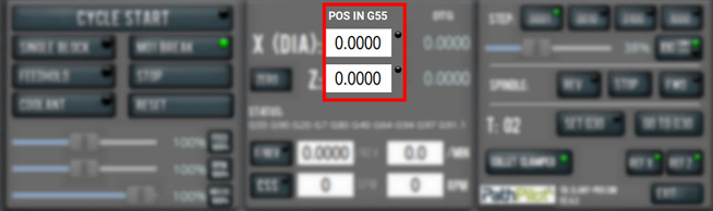

Set Work Offsets
In the the X (Dia) DRO field, all values are expressed in terms of the diameter of the workpiece, not the radius.
Example
If the active tool is 2 in. away from the spindle centerline, 4.000 displays in the X DRO field.
  • Select Zero.
Figure 64: Work Offset DRO fields.

View Work Offsets
  • From the Offsets tab, on the Offsets Table tab, identify the Work Offsets Table window.
Figure 66: Work Offsets Table window.

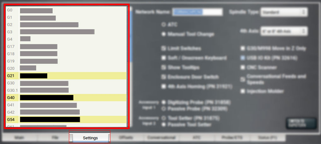

View Available G-Code Modes
Figure 67: G-code Description window on the Settings tab.

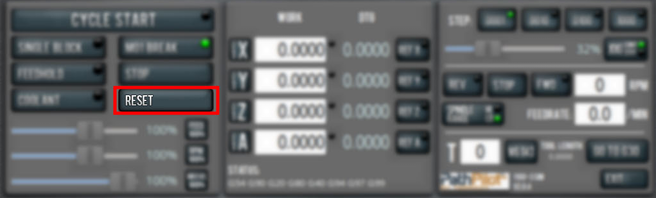

Run G-Code Programs
  • Select Reset.
Figure 68: Reset button.
About Reset Mode
  • Clears alarms

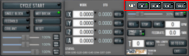

Jog in Step Mode
To select the step size:
Figure 75: Step buttons (in G20 mode).
About Step Jogging

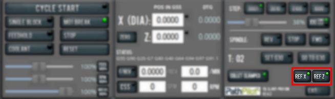

Reference the Machine
Figure 77: Reference buttons.
About Referencing

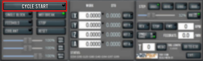

Start a Program
Figure 78: Cycle Start button.
About Cycle Start
While a program is running, the Cycle Start button's light is on. Selecting Cycle Start causes an alarm unless the chuck guard or enclosure door is closed and a valid G-code program is loaded.
  • Single block
  • Feed hold
  • M01 break
Cycle Start Reference

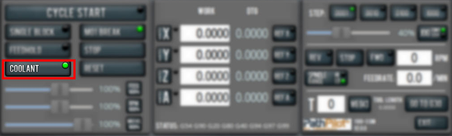

Operate the Coolant Pump
To turn coolant on or off:
  • Select Coolant.
Figure 80: Coolant button.
About Coolant

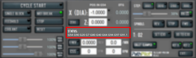

View the Active G-Code Modes
Figure 81: Status read-only DRO field.

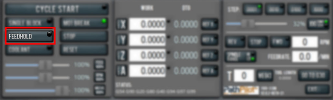

Use the Feed Hold Function
  • Select Feed Hold.
Figure 83: Feed Hold button.
About Feed Hold

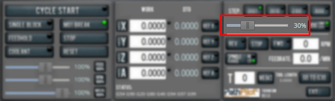

Figure 84: Feed Rate Override slider.
  • Select Feed 100%.
About Feed Rate Override

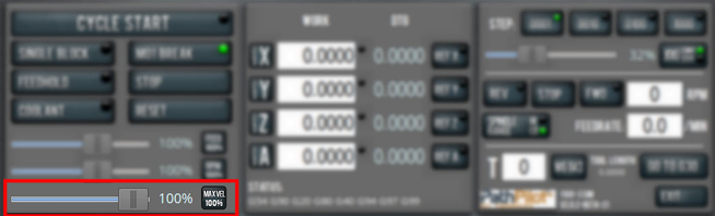

Figure 86: Maxvel Override slider.
  • Select Maxvel 100%.
About Maxvel Override

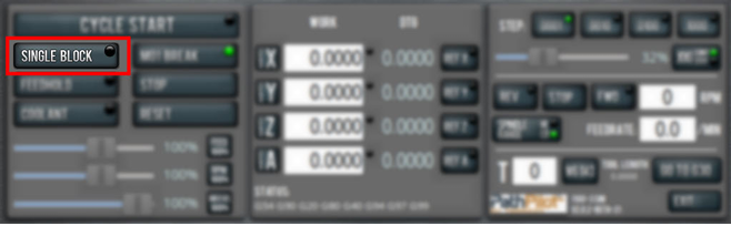

Use Single Block Mode
  • Select Single Block.
Figure 87: Single Block button.
About Single Block
You can turn single block mode on or off either before starting a program or while a program is running. For information, see "Use Single Block Mode".

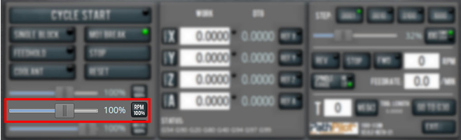

Figure 88: Spindle Override slider.
  • Select RPM 100%.
About Spindle Override
  • Running a program

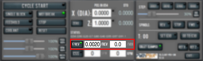

Change the Feed Rate

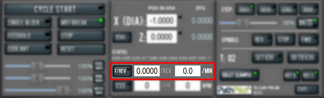

Figure 89: Feed Rate DRO field.
About Feed Rates
There are two feed rate modes:

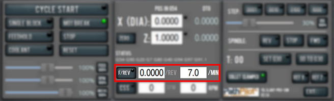

  • Units per Minute (G94) A G-code F word is interpreted to mean the controlled point should move at a certain number of inches or millimeters per minute, depending upon what length units are being used and which axis or axes are moving.
  • Units per Revolution of Spindle (G95) A G-code F word is interpreted to mean the controlled point should move at a certain number of inches or millimeters per spindle revolution depending upon what length units are being used and which axis or axes are moving.
NOTE: We recommend programming in units per revolution for almost all machining done on a lathe.
These settings are mutually exclusive: you cannot simultaneously be in both units per revolution and units per minute modes. The F/Min and F/Rev DRO fields display the current F word in both units/revolution and units/minute. The active mode is indicated in the PathPilot interface: when units per revolution mode is active, the light on the F/Rev button illuminates, the /Rev label (next to the DRO field) is white, and the Min label is gray.
You can turn on units per revolution mode by:
  • Clicking in the F/Rev DRO field, entering a value, and pressing the Enter key on the keyboard.
  • Clicking the F/Rev button.
  • Typing G95 into the MDI Line DRO field, and pressing the Enter key on the keyboard.
  • Running a G-code program with a G95 command.
Change the Spindle Speed

Change the Feed Rate Mode
To turn on F/Rev mode, do any of the following:
  • Select the F/Rev DRO field and enter a value. Then select the Enter key.
Figure 91: A value in the F/Rev DRO field, which turns on F/Rev mode.
The button's light turns on, and the F/Min DRO field's label turns gray.
  • Select F/Rev when its light is off.
  • Select the MDI Line DRO field and type G95. Then select the Enter key.
  • Run a G-code program that has a G95 command.
You can turn off F/Rev mode by doing any of the following:
  • Select the F/Min DRO field and enter a value. Then select the Enter key.
Figure 92: A value in the F/Min DRO field, which turns off F/Rev mode.
The F/Rev button's light turns off, and the F/Rev DRO field's label turns gray.
  • Select the MDI Line DRO field and type G94. Then select the Enter key.
  • Run a G-code program that has a G94 command.
For more information on feed rate modes, see "About Feed Rate Modes".
The machine recognizes two feed rate modes: units per minute (F/Min) or units per revolution (F/Rev). These settings are mutually exclusive — you can't simultaneously be in both F/Rev and F/Min modes. The F/Min and F/Rev DRO fields display the current F word in both units per revolution and units per minute, with the active mode indicated by both the F/Rev button's light and the DRO fields' labels. For example, when F/Rev is active, the F/Rev button light is on, the F/Rev label is white, and the F/Min label is gray.
Units per Minute Mode (G94)
In units per minute feed rate mode, a G-code F word is interpreted to mean the controlled point should move at a certain number of inches or millimeters per minute, depending upon what length units are being used and which axis or axes are moving.
Units per Revolution Mode (G95)
In units per revolution feed rate mode, an F word is interpreted to mean the controlled point should move at a certain number of inches or millimeters per spindle revolution depending upon what length units are being used and which axis or axes are moving.
NOTE: For almost all machining on a lathe, programming in units per revolution is more desirable.

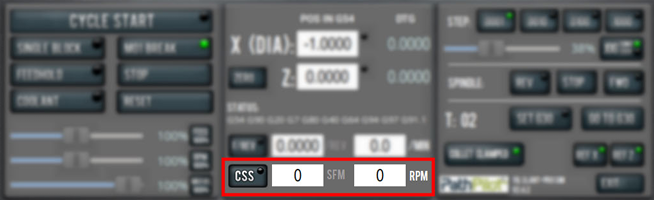

Change the Spindle Speed Command Mode
To turn on constant surface speed mode (G96):
  • Select the SFM DRO field and enter a value. Then select the Enter key.
Figure 93: SFM DRO field.
To turn on constant RPM mode (G97):
  • Select the RPM DRO field and enter a value. Then select the Enter key.
Figure 94: RPM DRO field.
For more information on spindle speed command modes, see "About Spindle Speed Command Modes".

Change the Tool Number
Figure 95: Tool DRO field.
  1. From the PathPilot interface, on the Offsets tab, select the Tool Touch tab.
Figure 96: Tool DRO field.
  1. In the Tool DRO field, type a number (the valid range is from 0-99). Then select the Enter key.

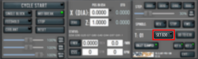

Use a G30 Position
To set a G30 position:
  2. From the Main tab, select Set G30.
Figure 97: Set G30 button.
To go to a set G30 position:
  • Do one of the following:
    • Select Go To G30.
Figure 98: Go to G30 button.
About G30
Manually Enter Commands
To manually enter commands:
Figure 99: MDI Line DRO field.
The DRO field highlights.
2. Type the command.
About the MDI Line DRO Field

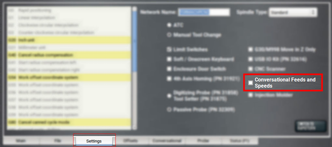

Figure 100: Settings tab.

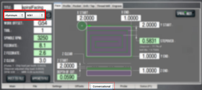

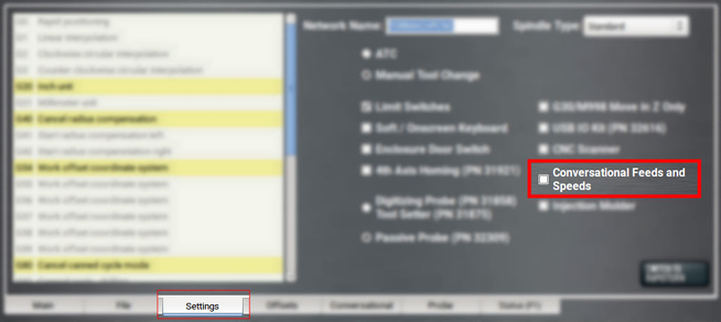

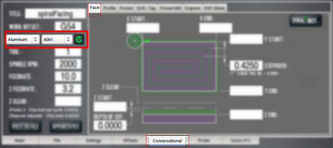

Figure 101: Feeds and speeds suggestions on the Conversational tab.
  • Roughing SFM
  • Finishing SFM
  • Max Spindle RPM
  • Roughing (in/rev)
  • Finishing (in/rev)
  • Finishing DOC
  • Roughing DOC
  • Peck (if drilling)
Refresh DRO Field Values
Figure 102: Refresh button on the Conversational tab.
Figure 103: Settings tab.

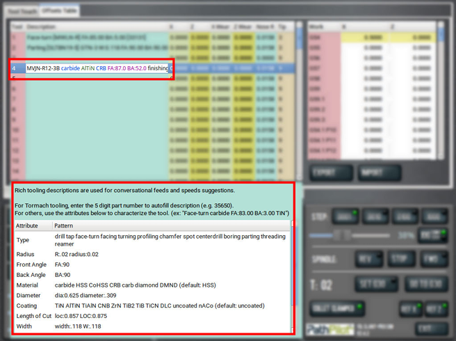

Create Tool Descriptions
  1. From the PathPilot interface, on the Offsets tab, select the Offsets Table tab, and identify the Tool Table window.
  2. Select a blank line.
Figure 104: A manually-entered tool description.
Examples
Example
MVJN-R12-3B carbide AlTiN CRB FA:87.0 BA:52.0 finishing
  • MVJN holder geometry
  • Aluminum-titanium nitride coated carbide (AlTiN)
  • Carbide
  • 87° front angle
  • 52° back angle
Example
Gold colored tool bit from middle drawer
This description provides very little information, and PathPilot defaults to tool bit features from the setup on the Tool Touch tab.
NOTE: If you don't know the part number, you can search for the tool at tormach.com.
  2. Type the part number for the tool, like 33133.
    A full description for a right-handed profiling tool (PN 33133) displays.
Figure 105: An automatically-generated tool description for a Tormach tool.
  1. You must use the Tool Touch tab to zero the tool for the correct X offset and Y offset.
Tool Keywords Reference
Item
Pattern
Example
Notes
type
drill, tap, face-turn, facing, turning, profiling, chamfer, spot, centerdrill, boring, parting, threading, reamer
Drill, Chamfer, Boring
tool radius
“R” or “radius”, followed by a colon, followed by a decimal number
R:.0158, radius:0.32
No radius specified is the same as a zero radius.
front angle
“FA”, followed by a colon, followed by a decimal number
FA:90
back angle
“BA”, followed by a colon, followed by a decimal number
BA:90
tool material
HSS, CoHSS, crb
HSS: High-speed steel; CoHSS: Cobalt high-speed steel; CRB: Carbide; No tool material specified is the same as HSS.
tool diameter
“dia” or “diameter”, followed by a colon, followed by a decimal number
Dia:.0341, diameter:.750
For axial tools (drills taps, reamers, etc.).
tool coating
TiN, ZrN, TiB2
No coating specified is the same as uncoated.
length of cut
“loc”, followed by a colon, followed by a decimal number
loc:0.875
For axial tools (drills, reamers, etc.). If no length of cut is specified, a length will be assumed based on cutter diameter.
tool width
“width” or “w”, followed by a colon, followed by a decimal number
W:.118, width:.118
For grooving and parting tools.
min bore
“min-bore”, followed by a colon, followed by a decimal number
min-bore:.522
flutes
A number, followed by “FL” or “FLUTE”
4FL, 12FL, 2flute
No flutes specified is the same as 2 flutes.

System File Management
Manage System Files
Use the File tab to manage system files on the PathPilot controller. For information, see "Transfer Files to and From the Controller".
To manage system files:
    • Select a file, and go to the Options menu. Then, select Copy, Cut, or Paste.
  • Select Back or Home.

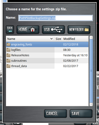

Create Backup Files
NOTE: To prevent errors when backing up and restoring files, only use a blank, formatted USB drive. Do not use the PathPilot v2.0 Upgrade.
Figure 106: Admin Settings Backup dialog box.
  2. Select Save.
Figure 107: Controller Files window on the File tab.
  • logfiles
  • media
  • ReleaseNotes
  • subroutines
  • USB
  1. Select Copy to USB.
  6. Go to Install PathPilot v2.x.
About Backup Files
Restore Backup Files

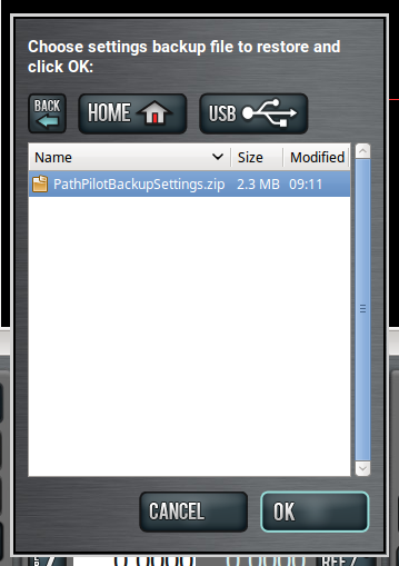

Figure 108: Admin Settings Restore dialog box.
Figure 109: USB Files window on the File tab.
  2. Select Copy From USB.
  1. If desired, you can enable an Internet connection in the PathPilot controller, which allows you to use PathPilot HUB, and receive automatic PathPilot updates. Go to the next section, "Enable an Internet Connection".
    If you don't want to use these features, you have completed installing and configuring PathPilot v2.x.

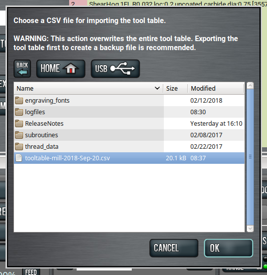

Figure 110: Export and Import buttons on the Offsets tab.

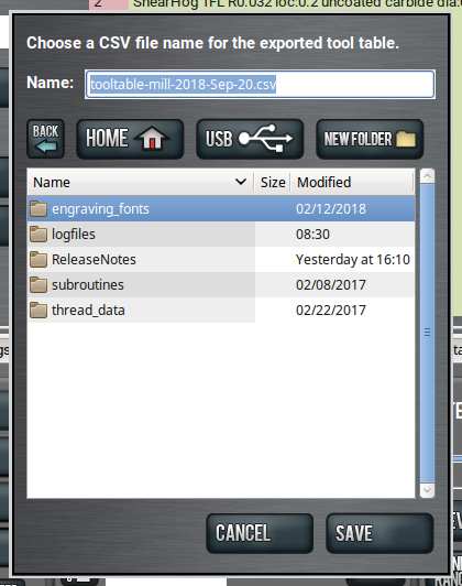

Import a .csv File
  4. From the Offsets tab, on the Offsets Table tab, select Import.
Figure 111: Import dialog box.
  1. From the Offsets tab, on the Offsets Table tab, select Export.
Figure 112: Export dialog box.
  2. Select Save.
  4. Select Eject.
