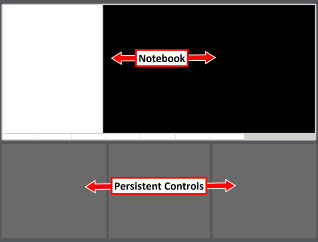

About PathPilot
Notebook Section

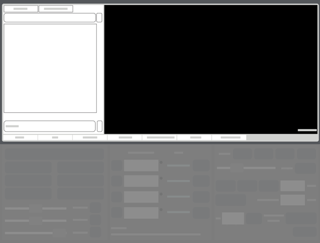

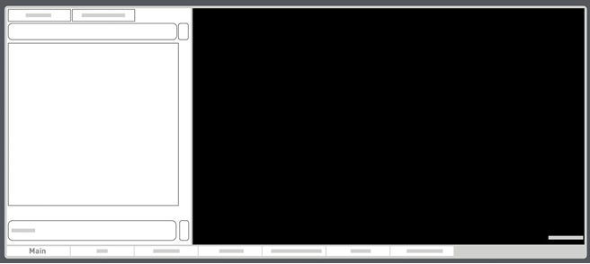

Main Tab
Access G-code files that are already loaded into PathPilot, and open or close them.
For information, see Load G-Code. -
Send G-code commands directly to the machine using the Manual Data Input (MDI) Line DRO field.
For information, see Manually Enter Commands. -
In a G-code program, do tasks like finding specific terms in the code, reading the code, or viewing the generated tool path.
For information, see Read G-Code.

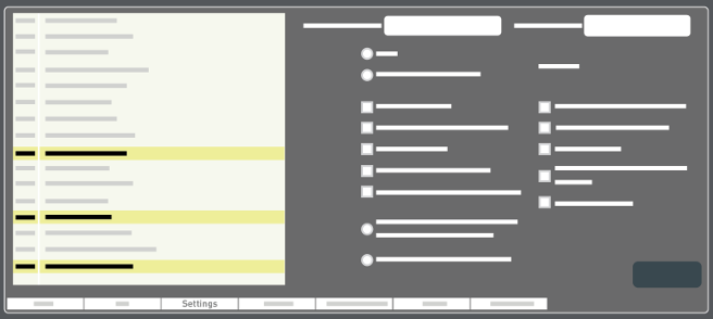

Settings Tab
Change the network name with which you're using PathPilot.
For information, see Change the Network Name. -
Change the screen's layout orientation (landscape or portrait).
For information, see Change the Screen Orientation. -
Configure PathPilot for the accessories you're using.
For information, see Enable the On-Screen Keyboard; Enable the M-Code I/O Interface Kit; Use a USB Camera. -
Turn on feeds and speeds suggestions when using conversational programming.
For information, see Use Feeds and Speeds Suggestions. -
Specify the way in which you want to use a G30 move.
For information, see Limit a G30 Move. -
Identify the available G-code modes that you can use.
For information, see View Available G-Code Modes.

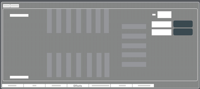

Offsets Tab
Make and restore backup files of your settings.
For information, see Create Backup Files; Restore Backup Files. -
Import and export .csv files of your tool table.
For information, see Import and Export the Tool Table. -
Work with a table of tool descriptions and tool offsets.
For information, see Set Tool Geometry Offsets. -
Read the currently programmed work offsets.
For information, see View Work Offsets. -
Change the tool number.
For information, see Change the Tool Number.

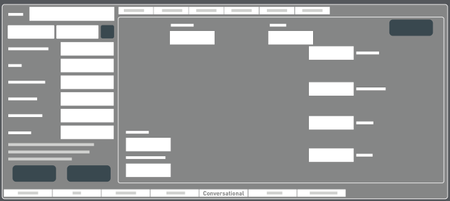

Conversational Tab
Use different functions to create simple G-code programs in PathPilot.
For information, see About Conversational Programming.

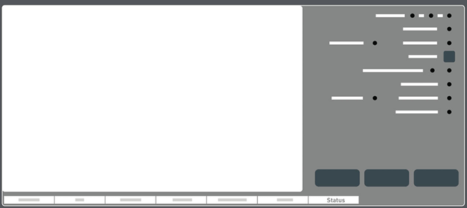

Status Tab
View diagnostic machine information.
Read error messages.
Configure your internet connection.
For information, see Enable an Internet Connection (Optional). -
Update or install a previous version of PathPilot.
For information, see "Manage PathPilot Versions".

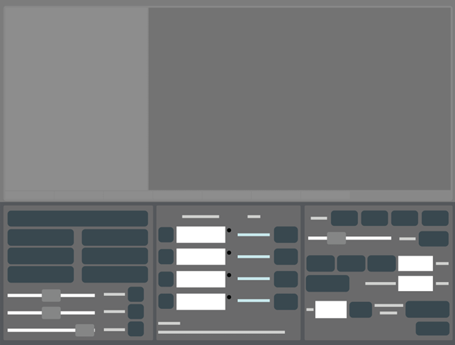

Persistent Controls

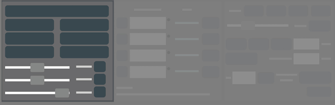

Program Control Area
Reset the machine.
For information, see Bring the Machine Out of Reset. -
Start, stop, or pause a G-code program.
For information, see Start a Program; Stop Machine Motion; Use the Feed Hold Function. -
Use overrides to change the feed rate, spindle speed, and maximum velocity.
For information, see Use the Feed Rate Override Function; Use the Maxvel Override Function; Use the Spindle Override Function. -
Manually control a G-code program.
For information, see Use M01 Break Mode; Use Single Block Mode.
Position Status Area
Create work offsets.
For information, see Set Work Offsets. -
Understand how you're jogging the machine.
For information, see View the Active Axis to Jog; View the Current Machine Position; View the Distance to Go. -
Quickly determine which G-code modes are active.
For information, see View the Active G-Code Modes. -
Change the spindle speed or feed rate.
For information, see Change the Feed Rate; Change the Spindle Speed Command Mode.

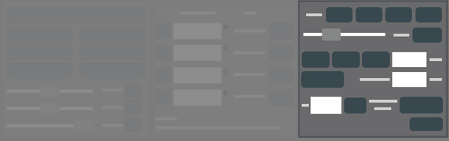

Manual Control Area
Move the machine axes.
For information, see Jog the Machine. -
Preset a G30 position.
For information, see Use a G30 Position. -
Reference the machine axes.
For information, see Reference the Machine.

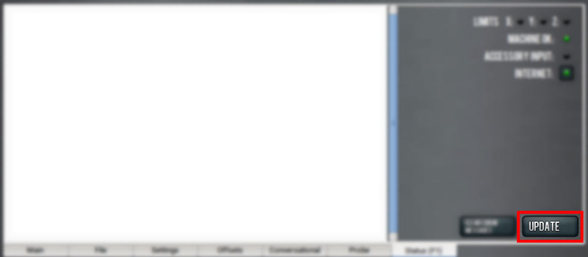

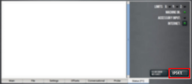

Confirm that the PathPilot controller is powered on and out of Reset mode.

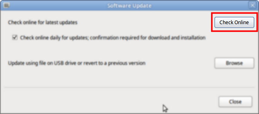

Downloading and installing an update file requires an Internet connection. From the Status tab, confirm that the Internet button LED light is on. (To configure the network, select the LED light.) Then, select Update.
From the Software Update dialog box, select Check Online.

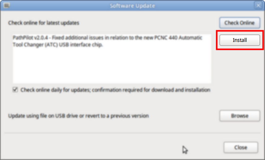

Select Install.
From the dialog box, select OK.
The update file is installed on the PathPilot controller. -
Follow the on-screen instructions to restart the PathPilot controller.
From the PathPilot support center, download the most recent PathPilot update file.
Transfer the PathPilot update file to a USB drive.
Put the USB drive into the PathPilot controller.
From the Status tab, select Update.

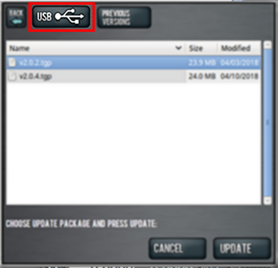

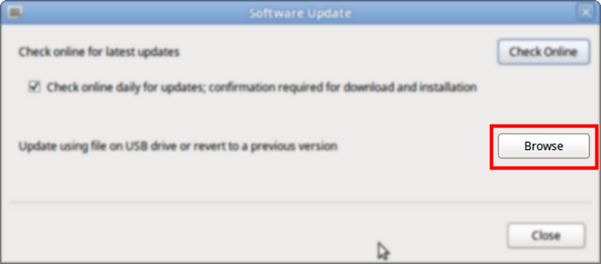

From the Software Update dialog box, select Browse.
From the Browse dialog box, select USB.
Select the desired update file, and then select Update.

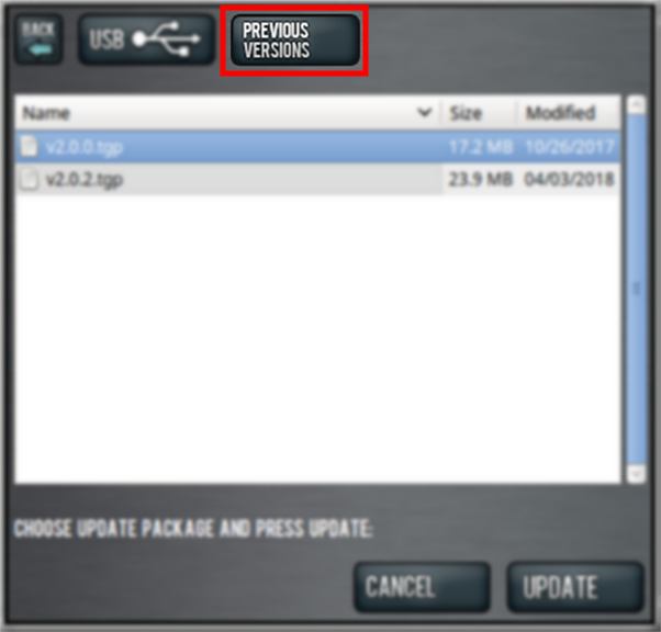

From the Browse dialog box, select Previous Versions.
