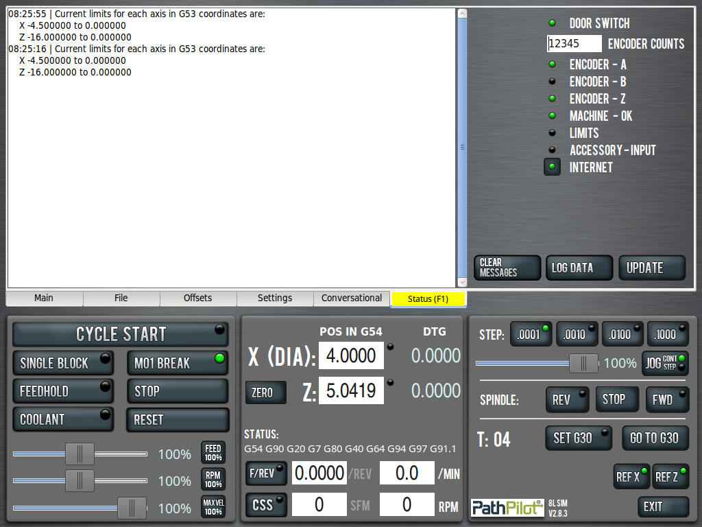

Adjust Soft Limits

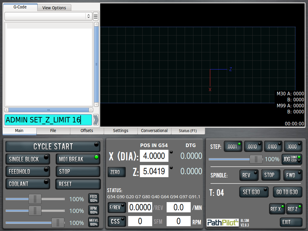

  1. From the PathPilot interface, in the MDI Line DRO field on the Main tab, type ADMIN_SET_Z_LIMIT [NUMBER] or ADMIN_SET_X_LIMIT [NUMBER].
    For example, to adjust the soft limit of the Z-axis to 16 in., type ADMIN SET_Z_LIMIT 16.
  2. Select the Enter key on the keyboard. The current limits display on the Status tab.

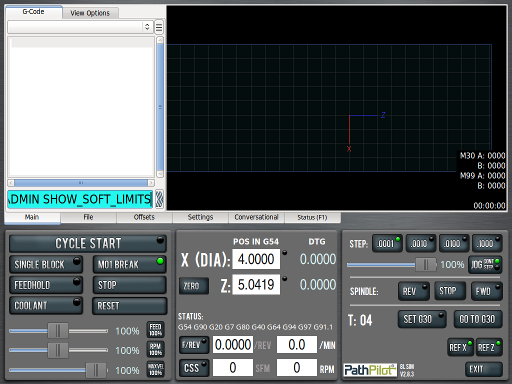

View Current Soft Limits
  1. In the MDI Line DRO field, type ADMIN SHOW_SOFT_LIMITS.

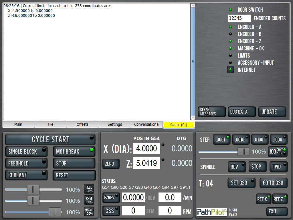

  2. The current limits display on the Status tab.
