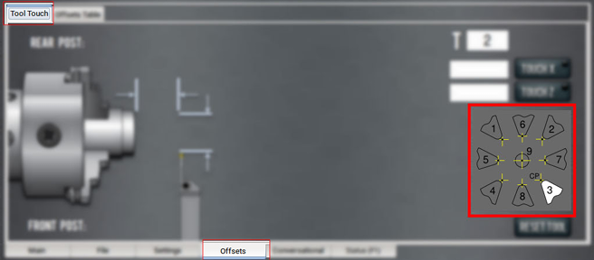

Many standard shapes of tools are available; PathPilot doesn't need to know the exact shape of the tool, but does need to know where it is used to cut and how to interpret the controlled point.
There are nine possible orientations for the cutting point, identified by numbers shown in the following image (with orientation code 3 illustrated). If this tool is put in the turret, or a rear position on the gang plate, it's orientation 2.
Figure 1: Cutting point orientation graphic.
  • Tools with orientations 1, 2, 3, and 4 all turn to size and face. Their controlled points are the intersection of tangents to the cutting tip radius so the radius has no effect on the diameter or length of the part made.
    If, however, the cut is angled, then the radius means it does not cut the expected part but one a little larger than required.
    To machine a part corresponding to the angled tool path defined in the G-code, it is necessary to use tool-tip radius compensation (i.e., G41 or G42).
  • Tools with orientations 6 and 8 turn diameters to size and are often used for making profiles. It is difficult to accurately estimate their controlled point in the Z-direction.
  • Tools with orientations 5 and 7 turn on the face of stock and are unusual. It is difficult to accurately estimate their controlled point in the X-direction without a test cut.
  • Tools with orientation 9 are used when tool-tip compensation is applied in all moves.
Some orientations seem unusual at first glance, like a parting or grooving tool in the front tool post has orientation 4. This is because the program defines the part to the right of the tool. The size of the waste left in the chuck is unimportant.

Set Offsets (G10)
Use the controls on the Offsets tab to set offsets. You can program offsets with the G10 G-code command.

Set Tool Table (G10 L1)
To define an entry in the tool table, program: G10 L1 P~ X~ Y~ R~ I~ J~ Q~
  • P~ is the tool number
  • R~ is the radius of tool
  • I~ is the front angle
  • J~ is the back angle
  • Q~ is the orientation
G10 L1 sets the tool table for the P tool number to the values of the words. A valid G10 L1 rewrites and reloads the tool table.
Example
G10 L1 P2 R0.015 Q3 (setting tool 2 radius to 0.015 and orientation to 3).
