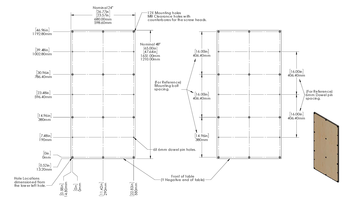

RA10001 - RA10024

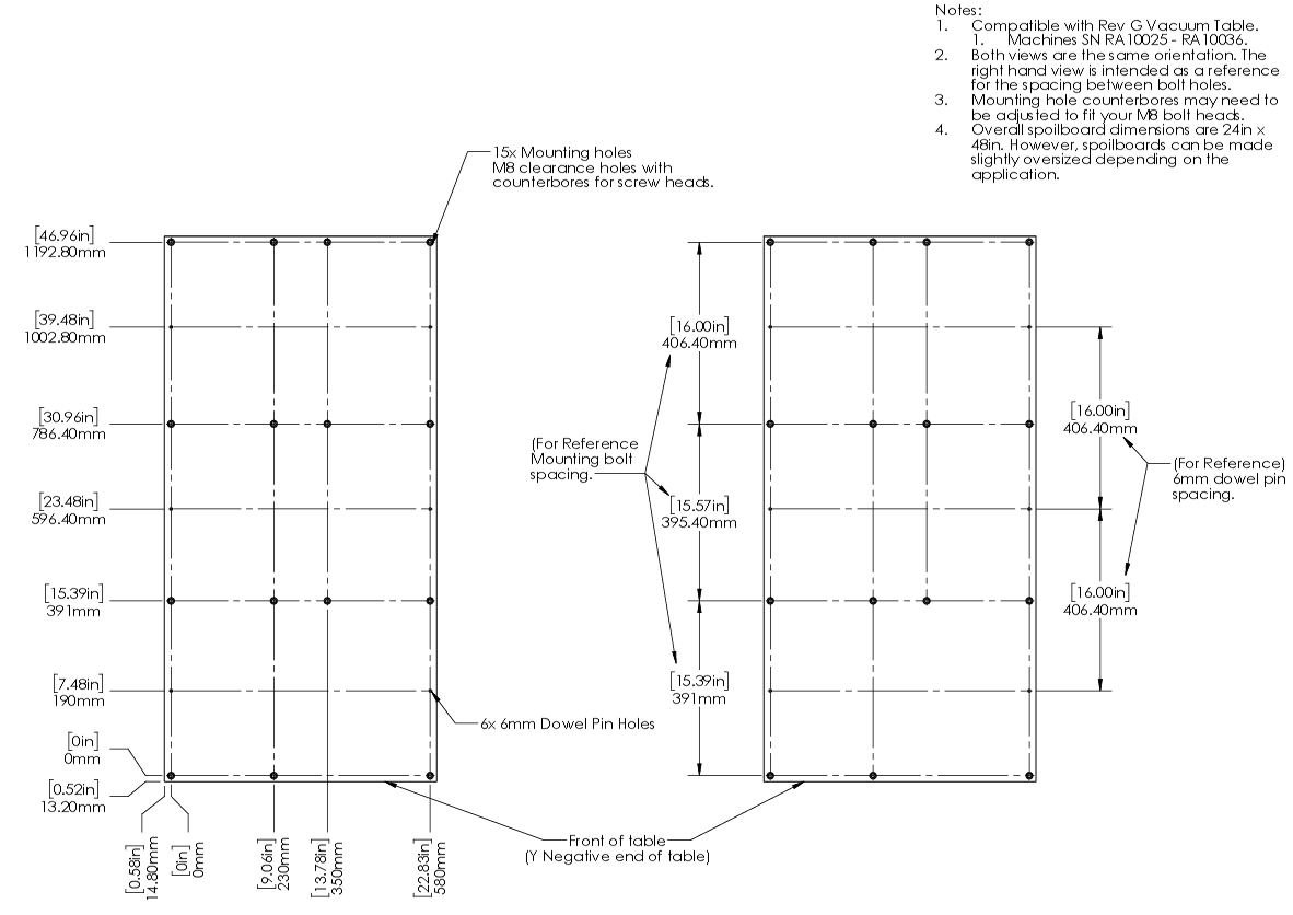

RA10025 - RA10036

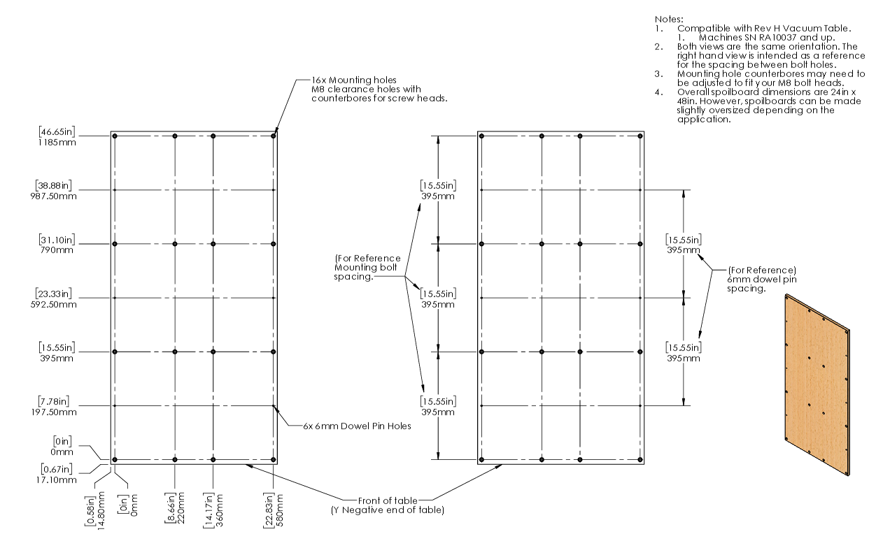

RA10037 and Up
