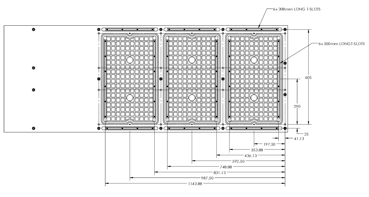

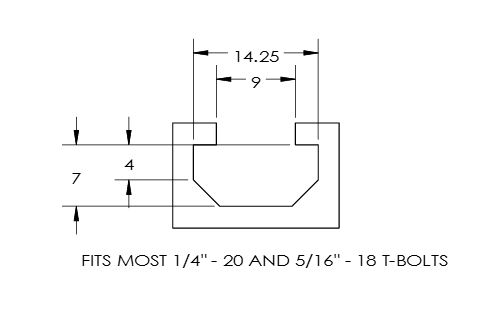

T-Slot Layout and Dimensions
RA10037 and Up
