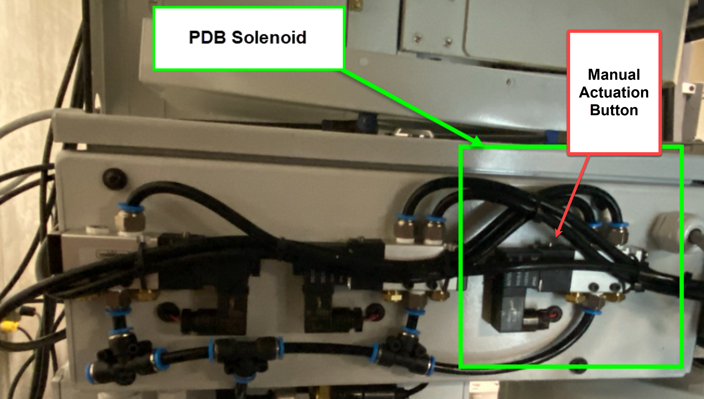

M-Series/PCNC 770/1100 with M ATC’s
  1. Remove the solenoid cover on the left side of the ATC.
  2. On the solenoid closest to the front of the machine, press the silver manual actuation button on the solenoid. This should fire your power drawbar.
