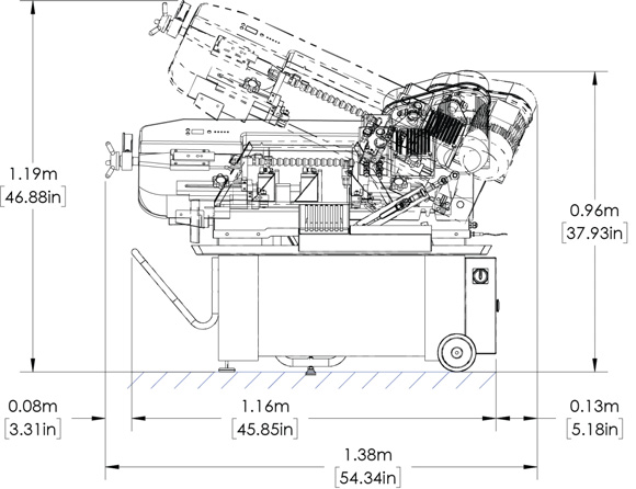

Space Requirements
The area must meet the following space requirements. Allow more space to access the rear of the machine for maintenance and repairs.
  • Machine Size 54" × 37" (1.4 m × 0.9 m)
  • Machine Height 47" (1.2 m)
