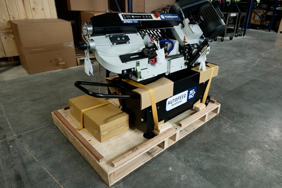

  5. Remove the plastic machine wrap and discard. When finished, the contents will look similar to the following image.
Figure 1: Bandsaw after opening the shipping crate.
  1. Inspect the item(s):
  • Photograph any damage that may have occurred during shipping.
  • Verify the received goods against the packing list.

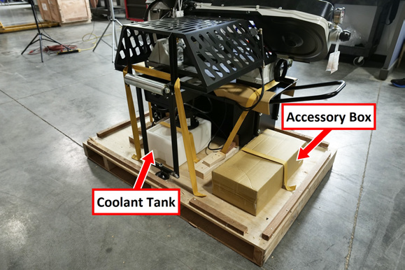

  1. Cut all shipping straps securing the machine, the accessory box, and the coolant tank to the pallet with snips. Remove the accessory box from the pallet and set it aside for later use.
Figure 2: Accessory box and coolant tank on the pallet.

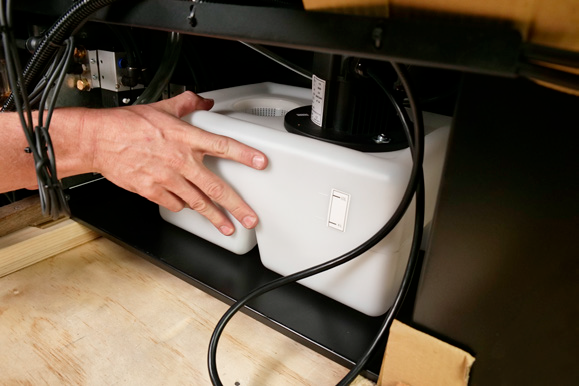

  1. Slide the coolant tank into the stand. You may have to turn the coolant tank so that the fin in the stand aligns with the slot in the coolant tank.
Figure 3: Coolant tank installed in the stand.
NOTE: Take care to keep the lines behind the coolant tank neat and tidy to prevent kinks.

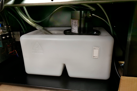

  1. Find the coolant hose that's pre-installed on the bandsaw, and put its loose end into the coolant tank.
Figure 4: Coolant hose installed into the coolant tank.

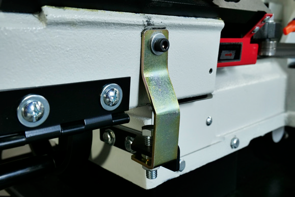

  2. Remove the shipping bracket securing the base casting to the head casting. Use a 5 mm hex wrench to remove the socket head cap screw from the top of the bracket, and a 14 mm wrench to remove the nut from the bottom of the bracket.
Figure 5: Shipping bracket securing the base casting to the head casting.
  1. We recommend replacing the bolt on the head casting, and keeping the shipping bracket in the event of a future move.
