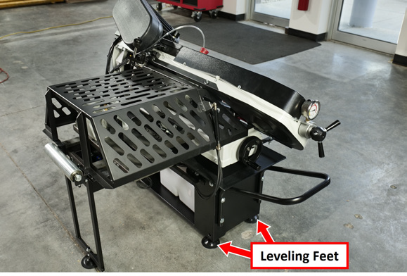

Level the Machine
Before operating the machine, you must verify that it's approximately level. While this helps with things like coolant flow, it doesn't impact machine performance.
To level the machine:
  • Make note of any high or low spots, and, if required, adjust the leveling feet.
Figure 1: Leveling feet on the machine.

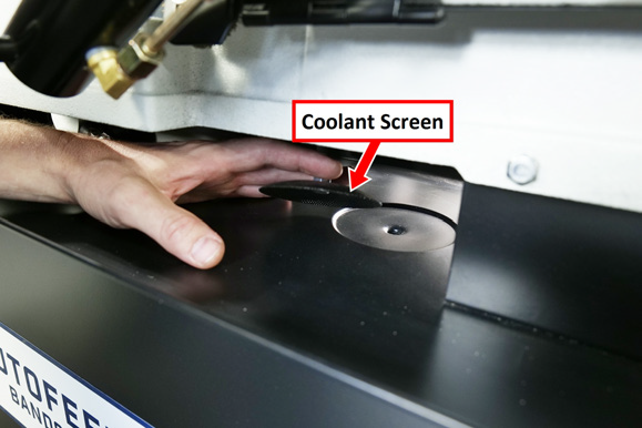

Install the Coolant Screen
  1. Find the accessory box that you set aside earlier. Remove the coolant screen from the box, and set the rest aside.
Figure 2: Coolant screen inside the accessory box.
  1. Put the coolant screen on the machine's base below the saw, as shown in the following image. Make sure that the nut on the coolant screen is facing up.
Figure 3: Coolant screen put on the machine's base.
NOTE: The bolt on the coolant screen is intended to use as a handle.

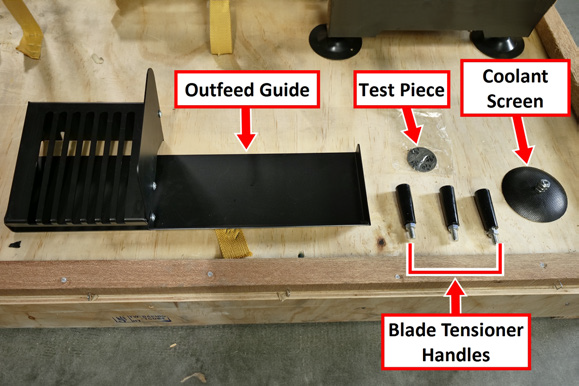

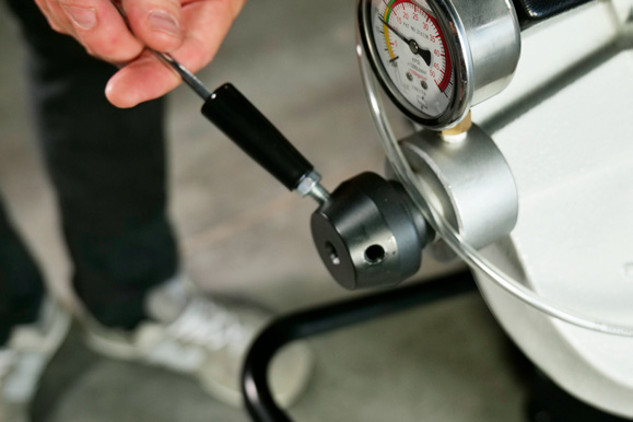

Install the Blade Tensioner Handles
  1. Find the accessory box that you set aside earlier. Remove the three blade tensioner handles from the box, and set the outfeed guide aside.
Figure 4: Contents of the accessory box.
  1. Install the three blade tensioner handles with a flat-blade screwdriver.
Figure 5: Installing the blade tensioner handles.

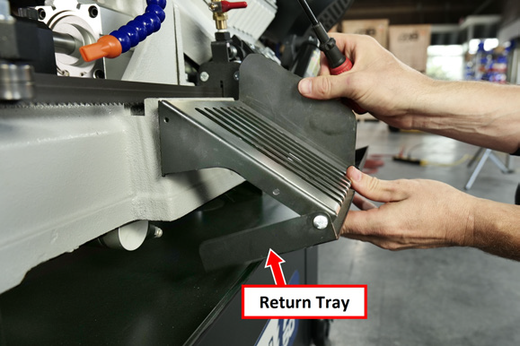

Install the Outfeed Guide
  1. Find the outfeed guide (from the accessory box) that you set aside earlier.
Figure 6: Contents of the accessory box.

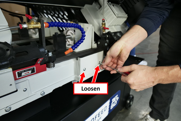

  1. Identify the two Phillips head screws that are pre-installed on the machine. Loosen the screws with a Phillips head screwdriver.
Figure 7: Loosening the two screws for the outfeed guide.
  1. Slide the outfeed guide over the two screws. Adjust the return tray so that it's in the pan, as shown in the following image.
Figure 8: Outfeed guide correctly aligned.
  1. Tighten the two Phillips head screws with a Phillips head screwdriver.

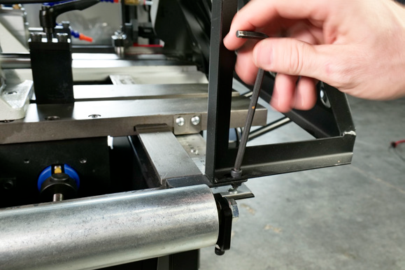

Remove the Shipping Bolts on the Rear Cage
  • The rear cage is secured to the frame for shipment. Remove the two bolts with a 5 mm hex wrench.
Figure 9: Removing the shipping bolts from the rear cage and the frame.

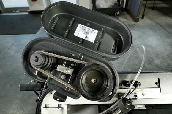

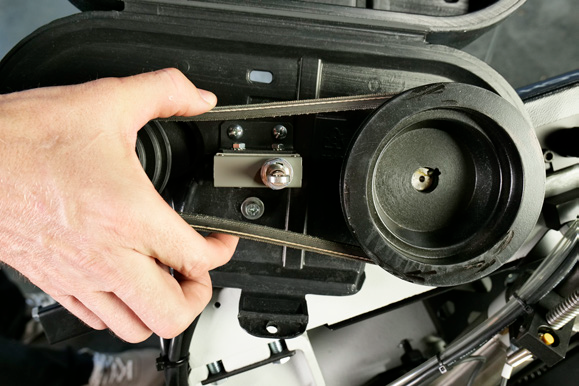

Verify Motor Belt Tension
To properly validate the installation of your machine, you must verify that the motor belt is properly tensioned.
To verify the motor belt tension:
  1. Verify that the air supply and the machine's main power cable aren't yet connected to the machine.
  2. Open the pulley cover.
Figure 10: Pulley cover opened.
  1. Firmly push the belt between the pulleys. If it's properly tensioned, the belt should move approximately 1/2 in. If it's not properly tensioned, complete the steps in “Change the Speed”.
Figure 11: Testing the tension of the motor belt.
  1. Close the pulley cover.

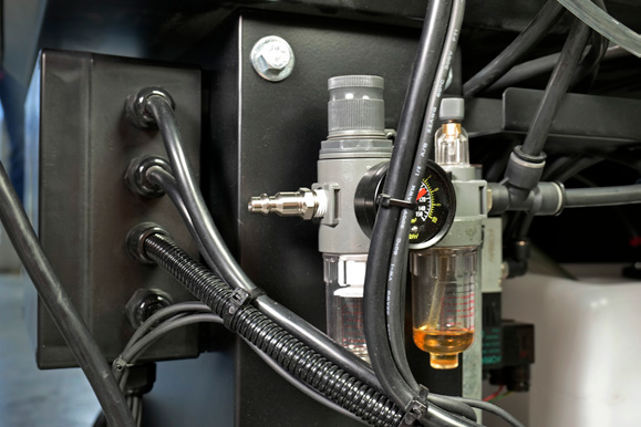

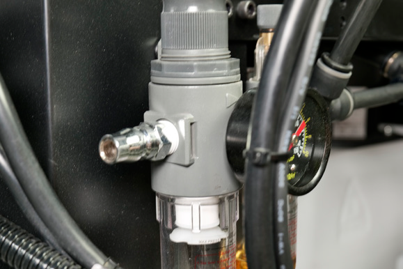

Make Air Connections
  1. Remove the fitting from the input port on the FRL Filter-Regulator-Lubricator (on the back of the machine) with an adjustable wrench.
Figure 12: Original air fitting installed on the FRL.
  1. Install the provided fitting to the input port on the FRL with an adjustable wrench.
Figure 13: Provided air fitting installed on the FRL.
Connect the air line from your site to the input port on the FRL Filter-Regulator-Lubricator.
