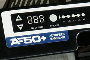

Control Panel Displays CS
Problem
The control panel displays CS.
NOTE: This message display isn’t an error. It indicated that the machine is ready for the cycle start command.

While troubleshooting error codes, examine the Stroke LEDs on the control panel, which correspond to the proximity sensors on the bandsaw. If the LED light is illuminated, the proximity sensor is active.
  • x1 LED: Infeed (advance) proximity sensor
  • x2 LED: Outfeed (retract) proximity sensor
  • x4 LED: Saw down proximity sensor
  • x5 LED: Saw up proximity sensor
