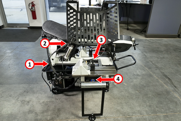

  1. Find the four proximity sensors on the machine as shown in the following image.
Figure 1: Proximity sensors on the bandsaw.

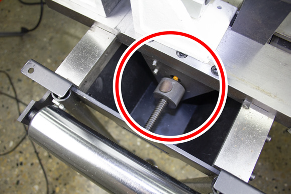

  1. Inspect each proximity sensor to verify that there's a 0.55 mm to 0.75 mm gap.
Figure 2: Proximity sensor.
