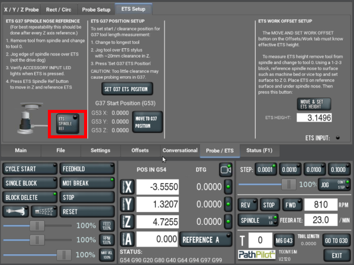

Reference the Spindle Nose
  2. Remove the tool holder from the spindle.
  3. From the PathPilot interface, in the Tool DRO field, type 0. Then select the Enter key.
  4. Jog the spindle until it's over the ETS. Then, slowly jog the Z-axis down (-Z) toward the contact pad on the ETS.
  5. From the PathPilot interface, on the ETS Setup tab, find the ETS G37 Spindle Nose Reference section, and select ETS Spindle Ref.

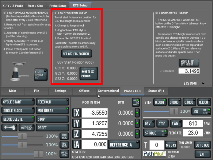

Set the G37 Position
  1. Remove the tool holder from the spindle.
The G37 position is now set.

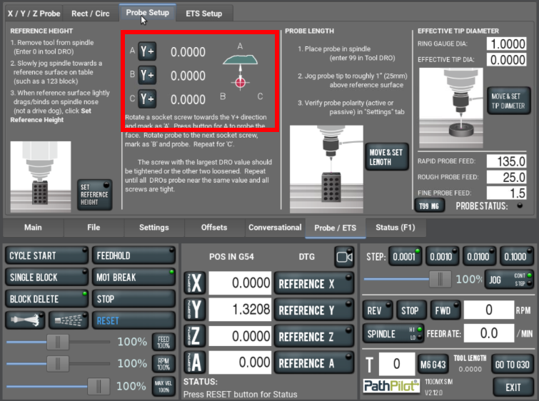

Probe Tip Concentricity
  1. Load your Probe into the spindle and plug it into ACC Port 1.
  2. Verify that tool number 99 is active in the Tool DRO.
  3. Verify probe polarity (active or passive) in the Settings tab, then come back to the Probe Setup tab.
  4. Press the probe tip and make sure that, from the PathPilot interface, on the Probe tab, the Probe Status light comes on.
  5. Rotate using the socket head screws as reference towards the Y+ Direction and mark as 'A'. Press the button for A to Probe the face.
  6. Rotate the probe to the next screw, mark as 'B'. Press the button for B to Probe the face.
  7. Repeat for 'C'
  8. The screw with the largest DRO Value should be tightened or the other two loosened.
  9. Repeat steps 5 trough 8 until all DRO’s probe near the same value and all screws are tight.

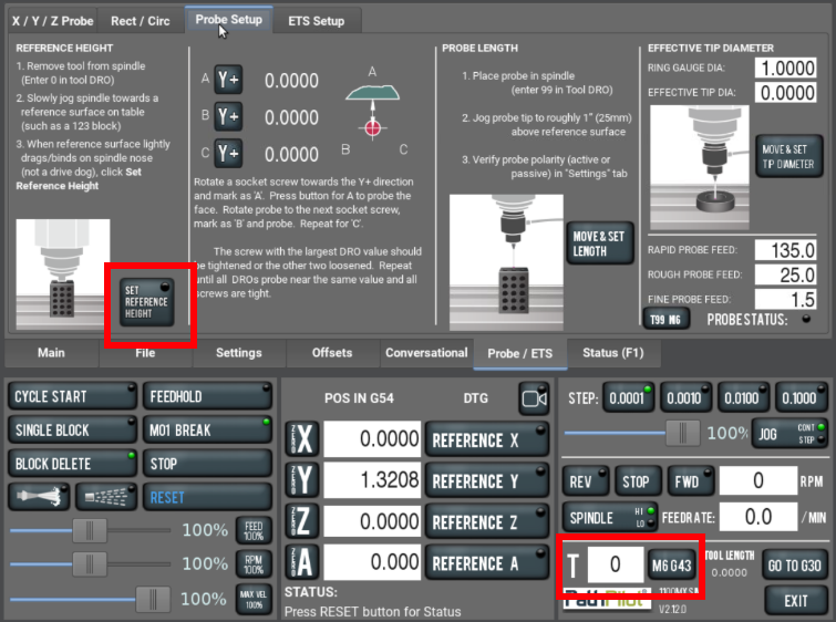

Set the Spindle Nose Reference Height
  1. Remove any tool from Spindle, and make Tool 0 active.
  2. Slowly jog the spindle towards a reference surface on table such as a 1-2-3 Block.
  3. When reference surface lightly drags/binds on spindle nose(not a drive dog on MX machines), click SET REFERENCE HEIGHT.

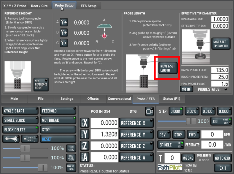

Set the Probe Length
  5. Jog the probe tip to roughly ~25mm from the reference surface used when setting the Reference Height .
  6. Click the Move and Set Length button and wait for the routine to finish.

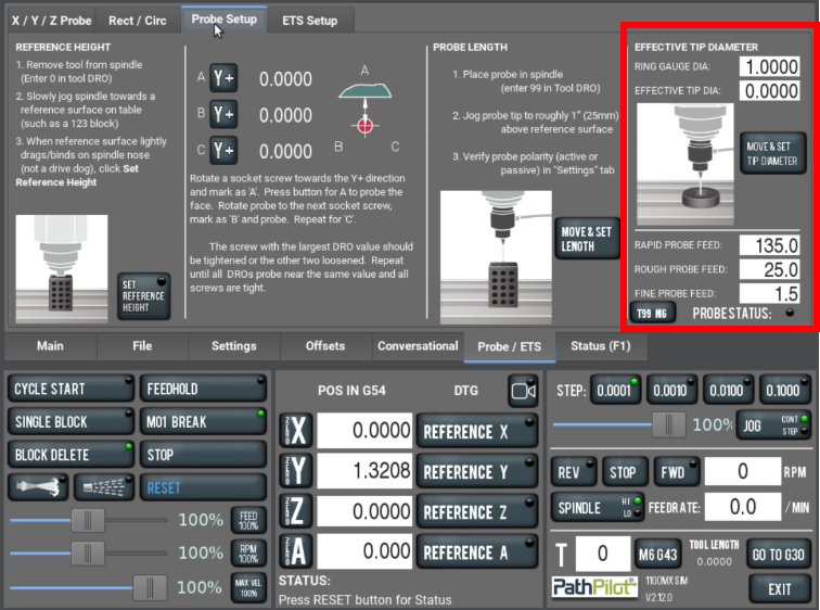

Set Effective Tip Diameter
  5. Enter your ring gauge diameter value into the Ring Gauge DIA DRO.
  6. Using a micrometer or calipers, measure your probe tip diameter, and enter the measured value into the Effective Tip DIA DRO.
  7. Jog the probe until the tip is roughly centered in the ring gauge (make sure that the height will allow it to make proper contact with the ID of the ring gauge).
  8. Press the Move & Set Tip Diameter Button, and wait for the routine to finish
  9. The Effective Tip DIA will update after the routine completes.
