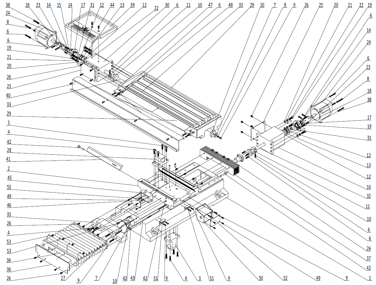

Lower Mill Assembly - PCNC 770
Alternative Part Number
Base*
Saddle*
Y Ballnut Carrier*
Screw, Socket M6 x 25
McMaster-Carr: 91290A330
Pin M6 x 25*
Screw, Socket M5 x 20
McMaster-Carr: 91290A242
Washer*
Spring Washer 5*
Screw, Socket M5 x 14
McMaster-Carr: 91290A230
Bumper (PN 31613)
11
Spacer*
12
X and Y Ball Screw Bearings (PN 31432)
ABEC Identification: 7201B
13
Adjustment Washer*
14
X and Y Ball Screw Pre-load Nut (PN 31616)
15
Tab Washers for Pre-load Nut 12 (PN 31542)
16
Y Motor Base (PN 31617)
17
Bearing Cap (PN 31530)
18
Screw, Socket M5 x 16
McMaster-Carr: 91290A232
19
Screw, Socket M8 x 25
McMaster-Carr: 91290A432
20
Flat Washer M8
McMaster-Carr: 91166A270
21
Spring Washer M8
McMaster-Carr: 91202A246
22
Pin M8 x 30*
23
Motor Coupling (PN 31421)
24
X- and Y-axis Stepper Motor (PN 32003)
25
X- and Y-axis Motor Mount Cover Plate*
26
Screw, Phillips M5 × 10
McMaster-Carr: 92000A320
27
Front Flange*
28
X Ballnut Carrier*
29
Bed*
30
X Motor Base*
31
Sleeve*
32
Y Ball Screw (PN 31425)
33
X Ball Screw (PN 31423)
34
Front Way Cover (PN 31419)
35
Holder*
36
Cover Mounting Plate (PN 31628)
37
Rear Way Cover (PN 31437)
38
Flat Washer M5
McMaster-Carr: 93475A240
39
Logo Panel (PN 31630)
40
Front Bed Pan (PN 31420)
41
X Gib*
42
Adjustment Screw (PN 31525)
43
Y Gib*
44
Screw, Socket Flat Head M6 x 16
McMaster-Carr: 91294A238
45
X Limit Switch Box*
46
X Limit Switch Box Cap*
47
X Limit Switch Block (PN 31636)
48
Washer*
49
Screw, Phillips M4 x 14
McMaster-Carr: 92005A222
50
Y Limit Switch Box*
51
Y Limit Switch Block (PN 31639)
52
Y Limit Switch Box Cap*
53
Screw, Phillips M5 x 8
McMaster-Carr: 92010A318
54
Screw, Socket M5 x 10
McMaster-Carr: 91290A224
