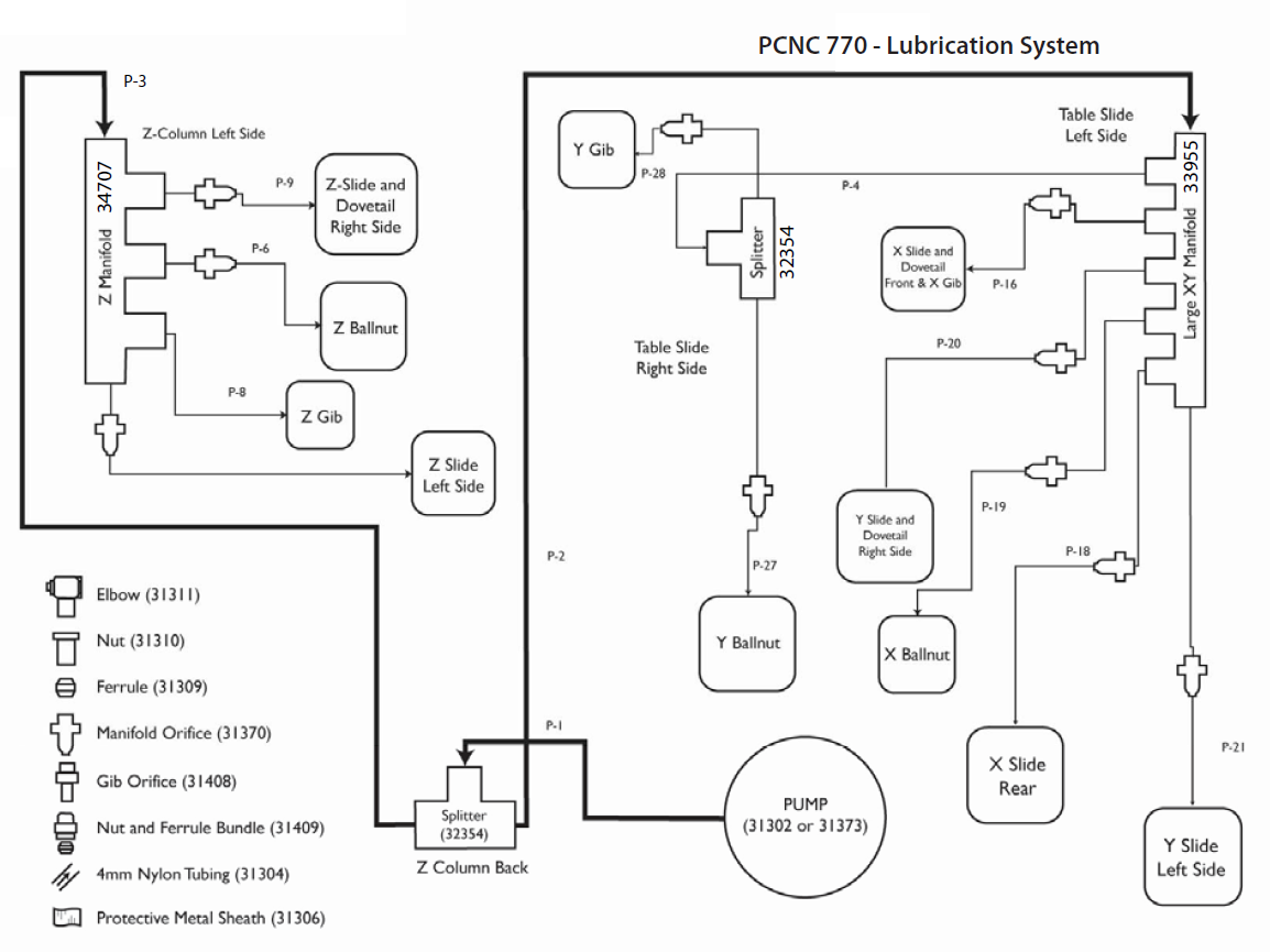

PCNC 770 Knowledge Base
Lubrication System - PCNC 770
