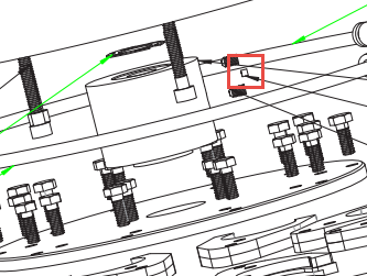

The Tray Reference sensor is a normally open reed switch housed in a black plastic enclosure on the underside of the carousel umbrella. It is used to provide a carousel home reference position. It reads a small neodymium magnet ( 0.125 in. DIA stick out 0.070 in.) embedded in the hub (PN 32152).

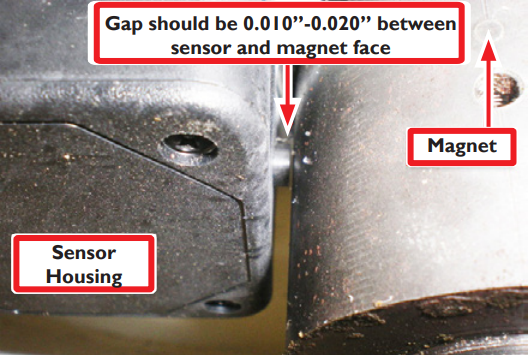

Sensor Alignment
Reason: The hub and magnet are out of alignment with the sensor.
  1. Inspect the sensor and magnet alignment to ensure they are spaced appropriately.
    1. If not, adjust the position and reinspect.

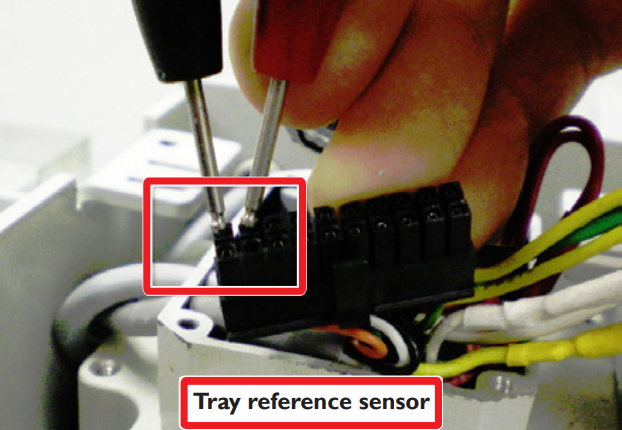

Replace Sensor
Reason: The sensor is malfunctioning or disconnected.
  1. Using a high-powered magnet, place it in front of the sensor while measuring the resistance on the red and green wires of the 20-pin Molex connector. With the magnet in place, the resistance should read 0 Ohms, and without the magnet it should read OL (Open Line).
    1. If not, contact Technical Support about replacing the tray sensor (PN 32164).
