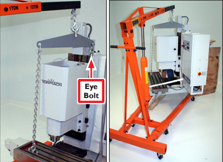

Lifting Bar Kit
The preferred method for lifting the mill is from above, using the Lifting Bar Kit (PN 31446); as shown in Figure 3.5; use this method with either a forklift or engine hoist. The single Eye Bolt on the top of the column is suitable for lifting the entire weight of the mill. However, it is recommend that the Lifting Bar Kit be used. (see Figure 3.5 and Figure 3.6)
Refer to documentation that ships with Lifting Bar Kit for more information on use. Do not attempt to lift mill from above using any other method. If using an engine hoist, refer to the following table to determine the minimum distance necessary to straddle stand between hoist legs.
Machine
Measurement
PCNC 770
29”
Figure 3.5 Figure 3.6

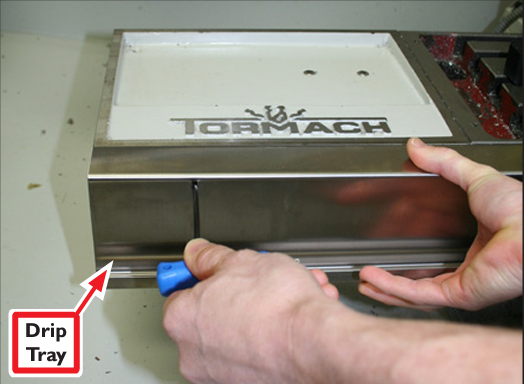

Install Drip Tray
Unstrap stainless steel Drip Tray from pallet; use provided screws to install. (see Figure 3.8)
Figure 3.8
