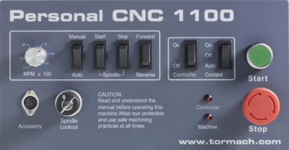

Verify Spindle Function
Use the Operator Panel controls to verify spindle function as follows (see Figure 3.14):
  1. Turn Spindle Lockout key to I (unlocked position).
  2. Select Manual for spindle mode.
  3. Press Start; spindle begins to rotate.
  4. Turn Spindle Speed Dial (RPM x 100) up and down to vary spindle speed.
  5. Toggle between Forward and Reverse to switch spindle direction.
  6. Press Stop; spindle stops.

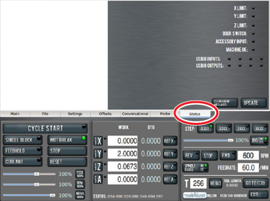

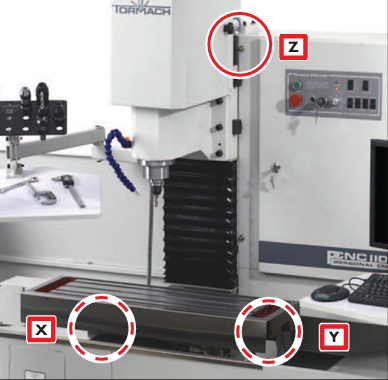

Verify Limit Switch Function
Limit switches prevent the mill from exceeding its travel limits and provide a reference location during the mill homing procedure.
There are three limit switches, one for each axis of motion (X, Y, and Z), as shown in Figure 3.18.
Figure 3.18

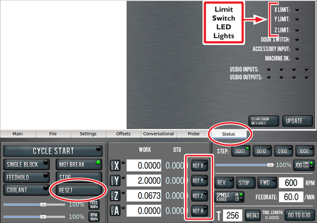

If a limit switch is triggered, the mill is placed in a reset state.
To verify proper limit switch function:
  1. On the PathPilot interface, click the Status tab. (see Figure 3.19)
Figure 3.19
  1. Manually depress X, Y, and Z limit switches by hand. (see Figure 3.18)
  2. Verify that the corresponding limit switch LED light illuminates on the Status screen. (see Figure 3.20)
Figure 3.20
  1. After verifying limit switch function, click the flashing Reset button. (see Figure 3.20)
Verify Axis Function
  1. Reference the mill by clicking the Ref Z, Ref X, and Ref Y buttons; (see Figure 3.20) the mill moves.
