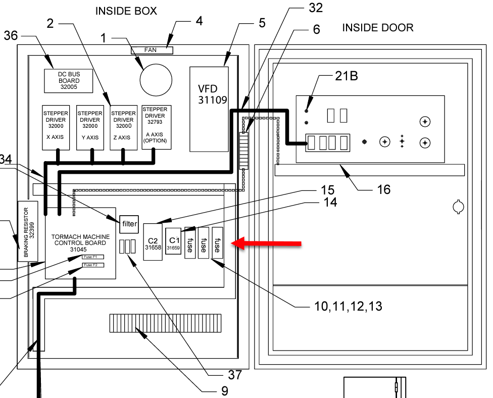

Check the FU1, FU3 and FU6 Fuses
Reason: Fuse is blown.
  1. Identify your machines main fuses.
  1. Power down the machine, and remove both fuses.
  2. Check both fuses using the following process: Checking a Fuse on a Tormach Machine
  3. If any fuse is blown, replace it.
