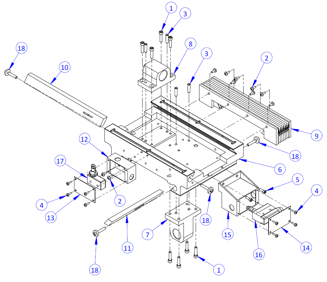

Y-Axis Saddle - 770M
Alternative Part Number
McMaster-Carr: 91290A330
Screw, Pan Head Machine, M5 × 0.8 - 10
McMaster-Carr: 92095A182
6 - 25 Taper Pin (PN 30439)
Screw, Pan Head Machine, M4 × 0.7 - 12
McMaster-Carr: 92005A222
Screw, Socket Head Cap, M5 × 0.8 - 14
McMaster-Carr: 91290A230
770 Y-Axis Saddle*
Y Ball Nut Carrier*
X Ball Nut Carrier*
Y-axis Rear Way Cover, 770 (PN 31437)
770 X-Axis Gib*
11
770 Y-Axis Gib*
12
X-Axis Limit Switch Box*
13
X-Axis Limit Switch Box Cap*
14
Y-Axis Limit Switch Box Cap*
15
Y-Axis Limit Switch Box*
16
Y-Axis Limit Switch (PN 30461)
17
X-/Z-Axis Limit Switch (PN 31860)
18
Adjustment Screw (PN 31525)
