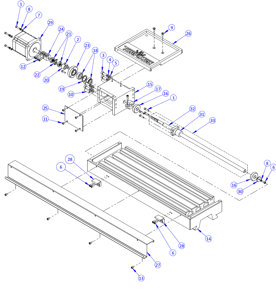

X-Axis Assembly - 770M
Alternative Part Number
McMaster-Carr: 91290A242
Screw, Socket Head Cap, M5 × 0.8 - 16
McMaster-Carr: 91290A232
Screw, Socket Head Cap, M8 × 1.25 - 25
McMaster-Carr: 91290A432
Washer, Split Lock, M8
McMaster-Carr: 91202A238
Washer, Flat, M8
McMaster-Carr: 91166A270
Screw, Socket Head Cap, M5 × 0.8 - 14
McMaster-Carr: 91290A230
Washer, Flat, M5
McMaster-Carr: 93475A240
Washer, Split Lock, M5
McMaster-Carr: 91111A124
Screw, Flat Head Cap, M6 × 1 - 16
McMaster-Carr: 91294A238
Pin, Taper, 8 × 30, M5 Thread (PN 31620)
11
Screw, Pan Head Machine, M5 × 0.8 - 10
McMaster-Carr: 92000A320
12
Screw, Socket Head Cap, M4 × 0.7 - 12
McMaster-Carr: 91290A154
13
Screw, Socket Head Cap, M5 × 0.8 - 8
McMaster-Carr: 91290A224
14
770 Machine Table*
15
770 X-Axis Motor Mount*
16
X/Y-Axis Ball Screw End Bumper, 770 (PN 31613)
17
770 Ball Screw End Stop Clamp*
18
X-/Y-Axis Ball Screw Angular Contact Bearing (PN 31432)
19
770 X-Y Ball Screw Bearing Spacer*
20
Sleeve*
21
770 X and Y Ball Screw Preload Nut (PN 31616)
22
770 Tab Washer for Preload Nut (PN 31542)
23
Bearing Cap (PN 31530)
24
Ball Screw Coupler (PN 31421)
25
770 X-Y Motor Mount Cover Plate*
26
Tool Tray, 770 (PN 38868)
27
Table Drip Guard, 770 (PN 31420)
28
X-Axis Limit Switch Flag (PN 31208)
29
X-Axis Motor, 770M (PN 39413)
30
Washer, Flat, 5 × 25, 3 mm Thick*
31
770 X-Y Ball Nut1
32
770 X-Axis Ball Screw1
33
770 X-Axis Ball Screw Assembly (PN 31423)1
1Items #31 and #32 sold as assembly #33 PN 31423.
