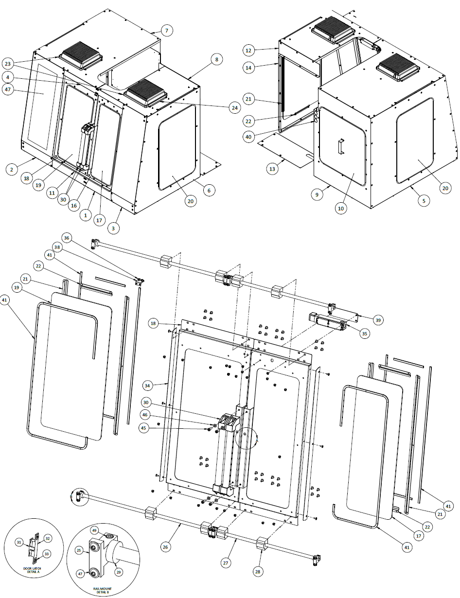

770M Knowledge Base
Enclosure - 770M
Alternative Part Number
Enclosure Panel, 770, Lower Front (PN 37600)
Enclosure Panel, 770M, Left Front (PN 37603)
Enclosure Panel, 770M, Right Front (PN 37601)
Enclosure Panel, 770, Upper Front (PN 37605)
Enclosure Panel, 770M, Left Side (PN 37604)
Enclosure Panel, 770M, Right Side (PN 37602)
Enclosure Panel, 770, Left Top (PN 37614)
Enclosure Panel, 770, Right Top (PN 37615)
Enclosure Panel, 770, Left Rear (PN 37616)
Enclosure Panel, 770, ATC (PN 37617)
11
Chip Tray Rail, 770 (PN 37662)
12
Enclosure Panel, 770, Right Rear (PN 37619)
13
Enclosure Panel, 770M, Splash Shield (PN 38479)
14
Enclosure Panel, 770, Splice Plate (PN 38480)
15
Enclosure Panel, 770, Column Splice (PN 37618)
16
Enclosure Door, 770, Right (PN 37609)
17
Window, 770M, Right Door (PN 37624)
18
Enclosure Door, 770, Left (PN 37608)
19
Window, 770M, Left Door (PN 37623)
20
Window, 770, Side (PN 37625)
21
Enclosure Window Retainer, 770, Vertical (PN 37620)
22
Enclosure Window Retainer, 770, Horizontal (PN 37621)
23
LED Floodlight, 50 W (PN 37341)
24
Flood Light Retainer (PN 38222)
25
Linear Rail Mount (PN 37622)
26
Left Door Rail, 770 (PN 37606)
27
Right Door Rail, 770 (PN 37607)
28
Linear Bearing (PN 37610)
29
Door Bumper (PN 38357)
30
Handle, 400 mm (PN 37611)
31
Enclosure Ball Latch, Male (PN 38483)
32
Enclosure Ball Latch, Female (PN 38482)
33
Washer, Flat, M5, Stainless Steel (PN 37939)
McMaster-Carr: 93475A240
34
Door Seal (PN 37613)
35
Locking Door Switch (PN 37352)
36
Nut Bar (PN 37585)
37
Locking Switch Key (PN 37529)
38
Switch Key Bracket (PN 37586)
39
Locking Door Switch Installation/Cover Plate (PN 38272)
40
Round Plug, 32 mm (PN 37598)
41
Sealing Strip, Rubber (PN 38356)
21
42
Screw, Button Head Cap (Flanged), M6 × 1 - 12, Stainless Steel (PN 38206)
McMaster-Carr: 97654A380
77
43
McMaster-Carr: 97654A376
153
44
Screw, Socket Head Cap, M5 × 0.8 - 20 (PN 30357)
McMaster-Carr: 91290A242
45
Screw, Socket Head Cap, M8 × 1.25 - 22 (PN 37190)
McMaster-Carr: 91290A428
46
Washer, Flat, M8 (PN 30531)
McMaster-Carr: 91166A270
47
Decal, Enclosure, 770M, Front Left Panel (PN 38745)
