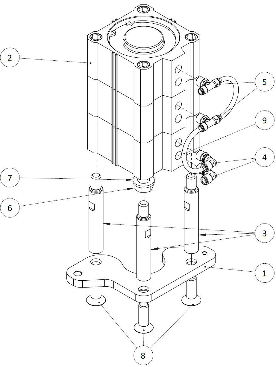

TTS Power Drawbar Cylinder - 770M
Alternative Part Number
Power Drawbar Mount Plate (PN 37747)
Pneumatic Cylinder, Double Acting, 100 mm Bore, 12 mm Stroke, 3-Stack (PN 31313)
Power Drawbar Standoff, M14 × 2 (PN 38282)
Fitting, Branch Tee, 1/4 NPT to 1/4 OD Tube (PN 31325)
Screw, Hex Head Cap, M16 × 1.5 - 25
McMaster-Carr: 91180A913
Washer, Flat, M16
McMaster-Carr: 91166A310
Screw, Flat-Head Cap, M14 × 2 - 40
McMaster-Carr: 91294A414
Tube, 1/4 in. OD, Plastic (Red) - 125 mm (PN 38408)
