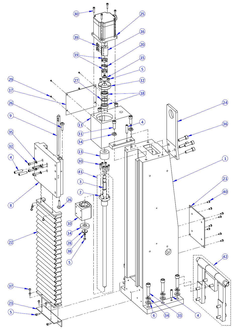

Z-Axis Assembly - 770M
Alternative Part Number
770 Column*
770 Z-Axis Ball Nut1
770 Z-Axis Ball Screw1
Tapered Dowel Pin, 8 × 40 mm (PN 31544)
Screw, Socket Head Cap, M5 × 0.8 - 14
McMaster-Carr: 91290A230
Washer, Flat, M12
McMaster-Carr: 91166A290
Washer, Flat, M10
McMaster-Carr: 93475A280
Z-Axis Slide*
Z-Axis Gib (PN 31524)
770 Z Ball Nut Carrier (PN 38864)
11
Z-Axis Motor Base*
12
Bearing Cap (PN 31530)
13
Z-Axis Ball Screw Upper Bumper, 770 (PN 31531)
14
Z-Axis Ball Screw Lower Bumper, 770 (PN 31533)
15
Sleeve*
16
Ball Screw Coupler (PN 31421)
17
Side Mounting Plate*
18
X-/Y-Axis Ball Screw Angular Contact Bearing (PN 31432)
19
Z-Axis Ball Screw Preload Nut for 770 (PN 31541)
20
770 Tab Washer for Preload Nut (PN 31542)
21
Column Cover Plate*
22
Z-axis Way Cover (PN 31433)
23
Lower Bellows Mounting Plate (PN 31584)
24
770 Lifting Bracket*
25
Z-Axis Motor, 770M (PN 38403)
26
Adjustment Screw (PN 31525)
27
Bearing Spacer*
28
Washer, Flat, 5 × 25, 3 mm Thick*
29
Screw, Button Head Cap, M3 × 0.5 - 5
McMaster-Carr: 92095A177
30
McMaster-Carr: 91290A242
31
Screw, Socket Head Cap, M10 × 1.5 - 30
McMaster-Carr: 91290A522
32
McMaster-Carr: 91290A330
33
Screw, Socket Head Cap, M12 × 1.75 - 50
McMaster-Carr: 91290A626
34
Washer, Split Lock, M12
McMaster-Carr: 91202A246
35
Washer, Split Lock, M6
McMaster-Carr: 91169A180
36
Screw, Socket Head Cap, M10 × 1.5 - 35
McMaster-Carr: 91290A526
37
Screw, Button Head Cap, M5 × 0.8 - 8
McMaster-Carr: 92095A207
38
Washer, Split Lock, M5
McMaster-Carr: 91111A124
39
Screw, Socket Head Cap, M4 × 0.7 - 12
McMaster-Carr: 91290A148
40
Screw, Button Head Cap, M5 × 0.8 - 10
McMaster-Carr: 91239A224
41
Z-Axis Ball Screw Assembly, 770 (PN 31434)
42
770M Moving Kit (PN 31333)
1Items #2 and #3 sold as assembly #41 PN 31434.
