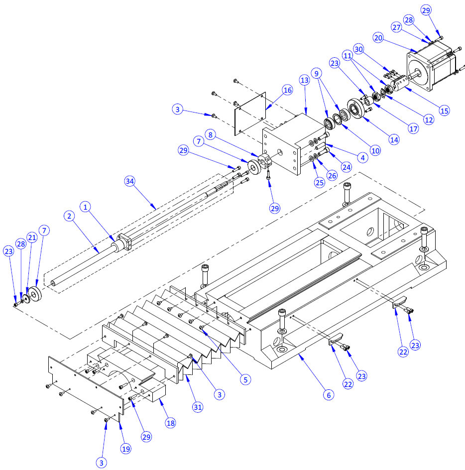

Y-Axis Assembly - 770M
Alternative Part Number
770 X-Y Ball Nut1
770 Y-Axis Ball Screw1
Screw, Pan Head Machine, M5 × 0.8 - 10
McMaster-Carr: 92095A208
12
Pin, Taper, 8 × 30, M5 Thread*
Screw, Pan Head Machine, M5 × 0.8 - 8
McMaster-Carr: 92095A207
770 Machine Base*
X/Y-Axis Ball Screw End Bumper, 770 (PN 31613)
770 Ball Screw End Stop Clamp*
X-/Y-Axis Ball Screw Angular Contact Bearing (PN 31432)
770 X-Y Ball Screw Bearing Spacer*
11
770 X and Y Ball Screw Preload Nut (PN 31616)
12
770 Tab Washer for Preload Nut (PN 31542)
13
770 Y-Axis Motor Mount (PN 31617)
14
Bearing Cap (PN 31530)
15
Ball Screw Coupler (PN 31421)
16
770 X-Y Motor Mount Cover Plate*
17
Sleeve*
18
770 Y-Axis Bellows Holder*
19
Y Cover Mounting Plate (PN 31628)
20
Y-Axis Motor, 770M (PN 39414)
21
Washer, Flat, 5 × 25, 3 mm Thick*
22
Y-Axis Limit Switch Flag (PN 30450)
23
Screw, Socket Head Cap, M5 × 0.8 - 14
McMaster-Carr: 91290A230
24
Screw, Socket Head Cap, M8 × 1.25 - 25
McMaster-Carr: 91290A432
25
Washer, Flat, M8
McMaster-Carr: 91166A270
26
Washer, Split Lock, M8
McMaster-Carr: 91202A238
27
Washer, Flat, M5
McMaster-Carr: 93475A240
28
Washer, Split Lock, M5
McMaster-Carr: 91111A124
29
McMaster-Carr: 91290A242
13
30
Screw, Socket Head Cap, M4 × 0.7 - 12
McMaster-Carr: 91290A148
31
Y-axis Front Way Cover, 770 (PN 31419)
32
Screw, Socket Head Cap, M12 × 1.75 - 45
McMaster-Carr: 91290A624
33
Washer, Flat, M12
McMaster-Carr: 91166A290
34
Y-Axis Ball Screw Assembly, 770 (PN 31425)
Items #1 and #2 sold as assembly #34 PN 31425.
