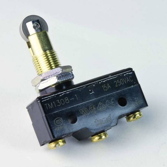

  3. Locate the physical switches on the machine and manually activate them while watching the LEDs in PathPilot.
    1. If the switches illuminate their respective status light, they are working; inspect the limit switch flags. (X and Y share a limit switch LED)
    2. If a status light stays on even when the switch isn’t depressed, continue to the next step.
  4. If no switch is depressed, and the Z limit switch LED is still on, continue onto the next step. If the X and Y LED is illuminated, then power down the machine. Start with either the X or Y switch. Take a picture for future reference, and then remove the wires with a screwdriver. Jumper both wires of the switch together. Look for a status change once the machine is booted back up.
  5. Locate the malfunctioning limit switch, take a picture for future reference, and then remove the wires with a screwdriver.
  6. With the switch in its normal state (not depressed), measure the resistance across the switches NC (normally closed) and C (common) terminals with digital multimeter set to resistance.
    1. If the digital multimeter reads OL, shows a resistance in the MΩ, and/or doesn’t produce continuity tone, replace the switch.
    2. If the switch measure 0-5 Ω, continue to the next step.
  7. With the switch depressed, measure the resistance across the switches NC (normally closed) and C (common) terminals with digital multimeter set to resistance.
    1. If the switch measure 0-5 Ω, replace the switch.
    2. If the digital multimeter reads OL, shows a resistance in the MΩ, and/or doesn’t produce continuity tone, reinstall the switch.
  8. Inspect the wiring on the malfunctioning switch for loose ferrules, terminal connections, fraying, or broken line.
