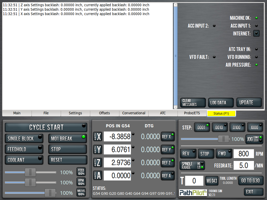

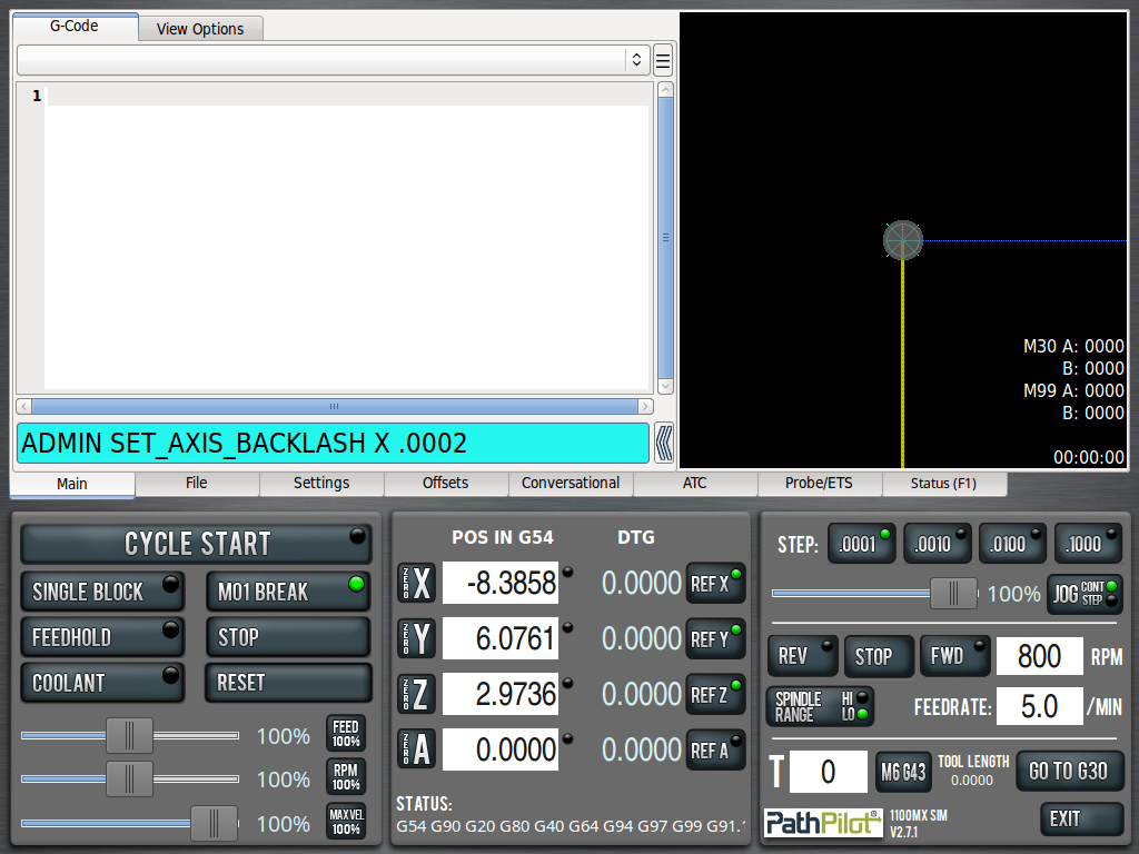

Backlash Compensation
https://tormach.atlassian.net/wiki/s/-813001308/6452/17b5d0ae2ede2362fa8d1e732dc89744e3e532f6/_/images/icons/emoticons/warning.png Note: There is no backlash compensation for the A axis.
