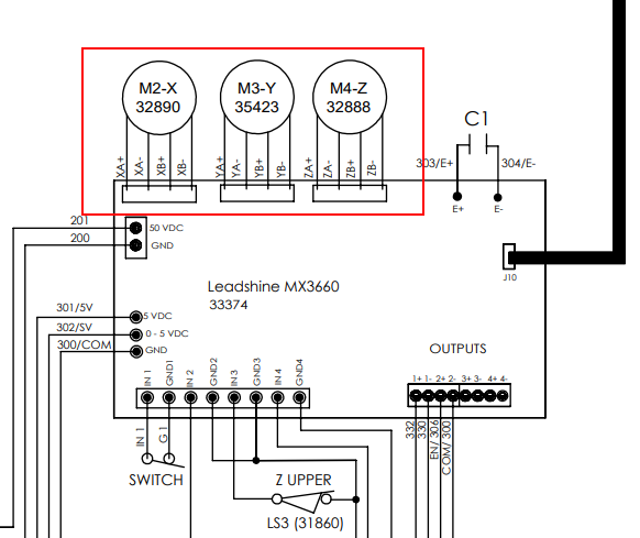

Reseat and Inspect the Connectors on the MX3660 and Motors
Reason: Control signals aren't reaching the electronic driver module
Stepper Connections on MX3660

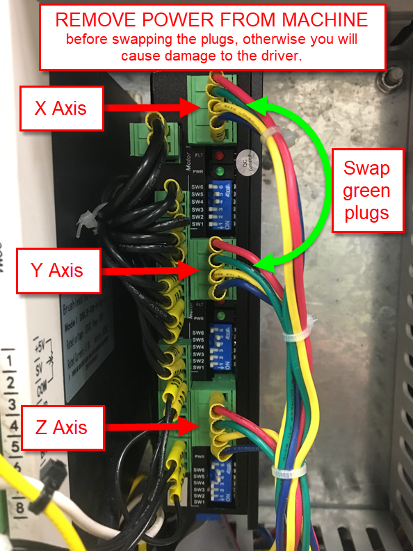

PCNC 440 Driver Swap
  1. Power off the machine.
  3. Swap the green plugs between two different axes.
    MX3660
  4. Power on the machine. warning The controls on the machine change, depending on the ribbon cables you swapped.
    1. If the malfunctioning motor now functions properly: It is likely that the malfunctioning axis driver is defective. A replacement MX3660 Driver will be needed
