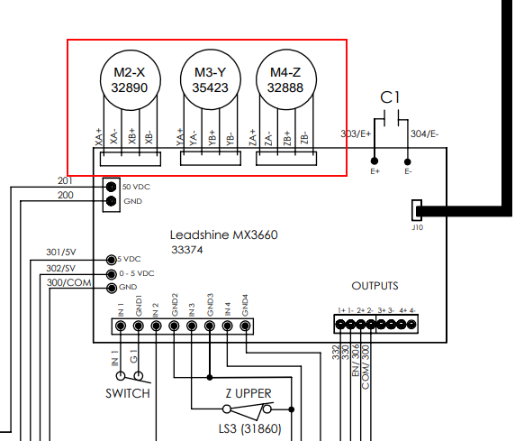

Your machine axes require power and control signals to work. If either of those are disrupted you can lose any or all of your axes motion. If only one motor is not working go to, One Axis Won't Move (or Only Moves in One Direction), and Other Axes Move .

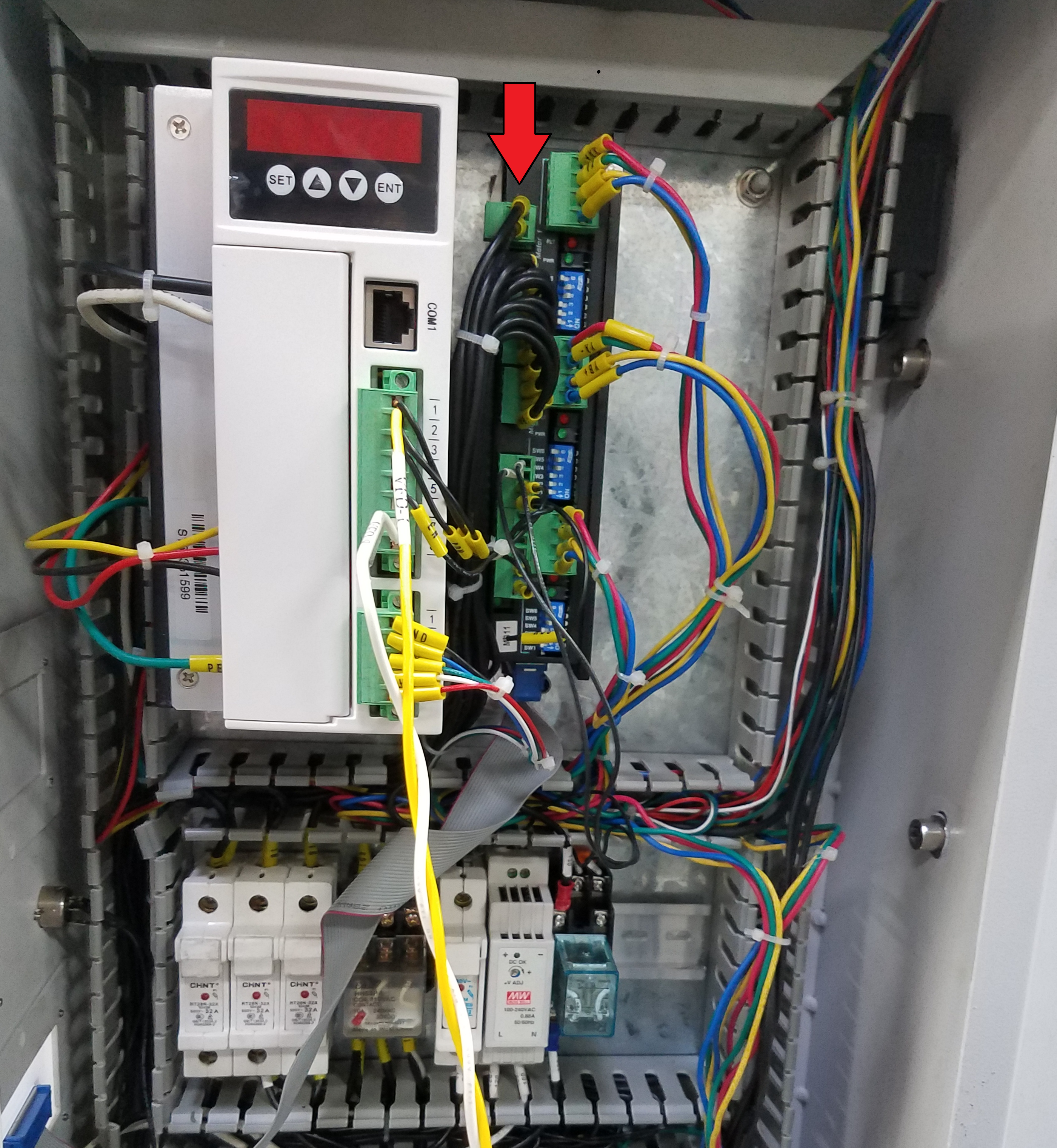

Reseat the Connectors on the MX3660 and Motors
Reason: Control signals aren't reaching the electronic driver module
Stepper Connections on MX3660

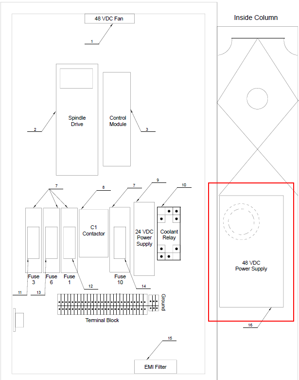

Inspect the 48v DC Power Supply
Reason: The DC power supply is malfunctioning.
  1. Check for voltage between wires 200 and 201 from the power supply for 48v. If no voltage is present inspect the primary AC side of the supply. (Wires 120-100) If no voltage is present, continue on through the troubleshoot.
Location of 48v DC Power Supply

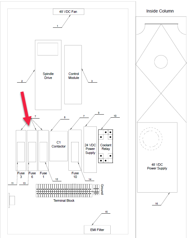

Inspect the F6 Fuse
Reason: The fuse have blown.
To learn how to check a fuse, see: Checking a Fuse on a Tormach Machine
If there is no power found coming to or from the fuse, inspect your wall power.
PCNC 440 Electrical Cabinet - F6 Location
